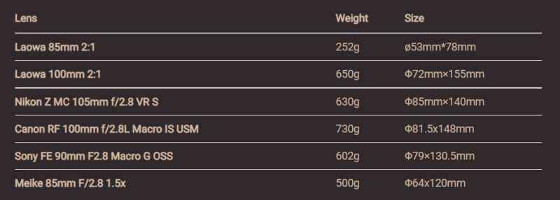

The Laowa 85mm F/5.6 2x is small and light, there’s no doubt about it. Here’s a quick comparison between other macro lenses for full-frame mirrorless mounts.
A size comparison between camera lenses
A chart comparing the size of macro lenses.
The Laowa 85mm is clearly a tiny and powerful beast, with its weight at less than half of that of most competitor lenses.

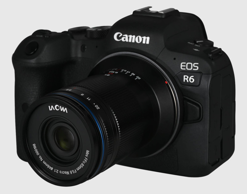

The Laowa 85mm f/5.6 2x mounted on a Canon R6 mirrorless camera.
Aperture ring position
The aperture ring is at the tip of the lens. Depending on your flash diffuser design, this aperture ring might be blocked by the diffuser, making it difficult to adjust the aperture while looking at the numbers on the lens. After some experimenting, I found that it was easier to turn the ring to f/22, and then click it down once for f/16, or twice for f/11. This way, there is no need to look at the aperture number.

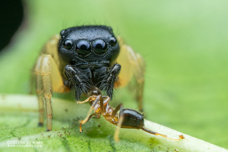

A jumping spider
Jumping spider (Siler semiglaucus)
At 1x, I tried f/16 but the light loss was significant and there was a bit of diffraction.

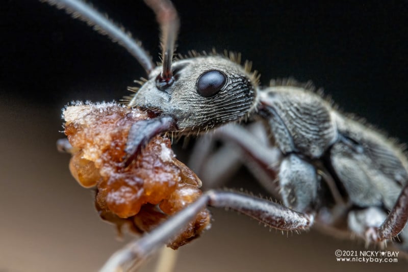

A macro photo of an ant
Ant (Polyrhachis sp.)

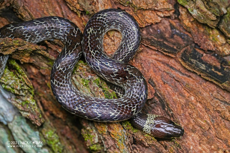

I also had some test shots at about 0.25x on this common wolf snake at f/16. Tack sharp!
A common wolf snake
Common wolf snake (Lycodon capucinus)

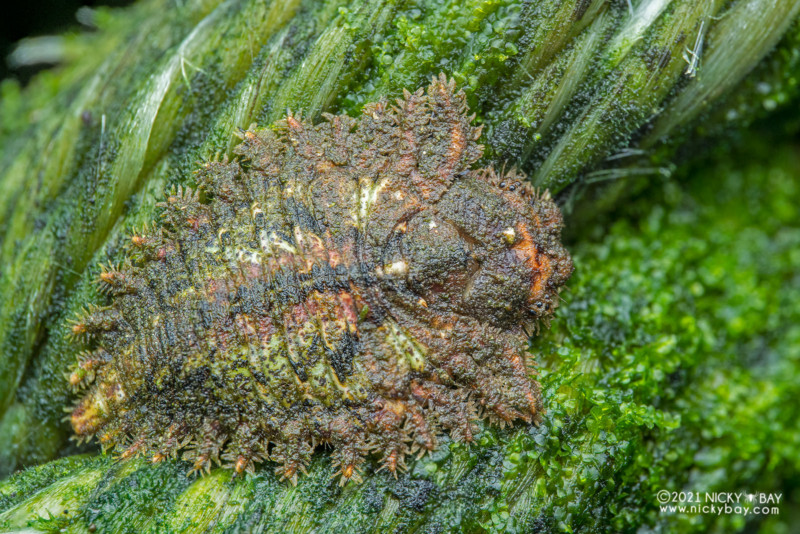

I was pleasantly surprised to find this owlfly larva nestled comfortably on the fiber of a mossy rope. It was really wet, but there’s so much detail on its body!
A macro photo of an owlfly larva
Owlfly larva (Ascalaphidae)

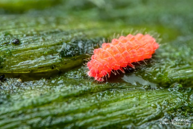

These red maggoty springtails are really beautiful when viewed up close, like little gummy worms.
A macro pohto of a red springtail
Red springtail (Neanurinae)

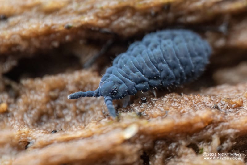

This shot is out of focus as I couldn’t get these little guys to stop moving. But… so cute!
A macro photo of a black springtail
Black springtail (Pseudachorutinae)

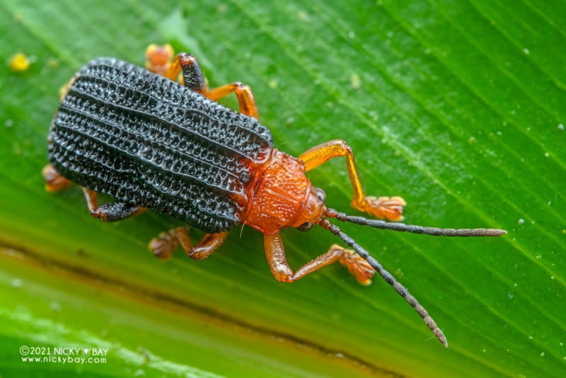

This is a poorly processed stack from 3 shots. But the details on the beetle’s elytra are pretty much retained!
A macro photo of a leaf beetle
Leaf beetle (Chrysomelidae)

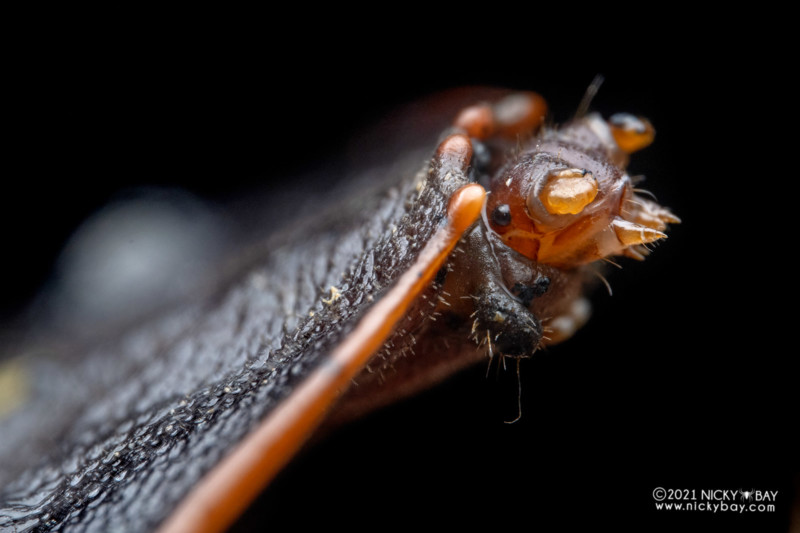

During my night shoot, Melvyn kindly pointed me to this trilobite beetle. Look closely and you’d see a little springtail on top of it:
A macro photo of a trilobite beetle
Trilobite beetle (Platerodrilus ruficollis). For more information on these beetles, check out Platerodrilus Checklist: Trilobite Beetles

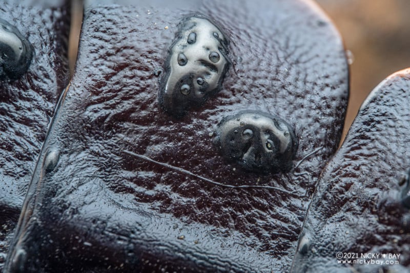

Close up of its head at maximum magnification. I was happily getting used to this lens!

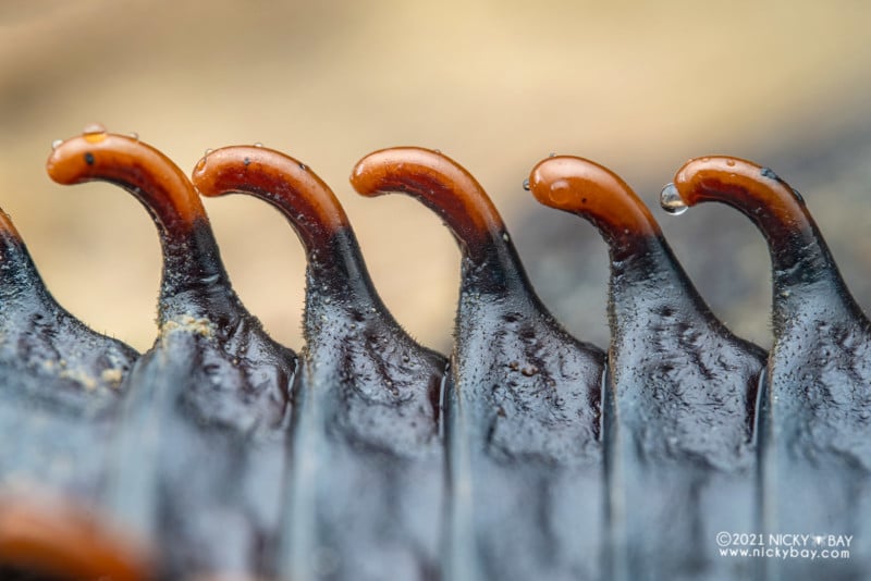

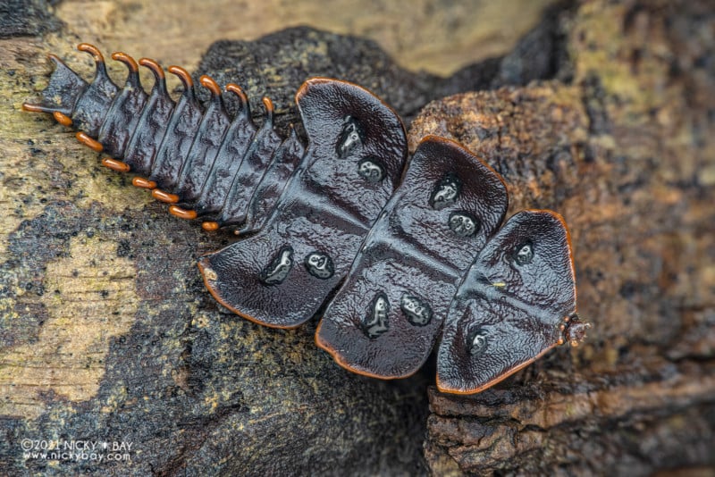

Close up of its dorsum. It was a really wet night and raining half the time, hence the water droplets.
And one of my favorite angles for most trilobite beetles!

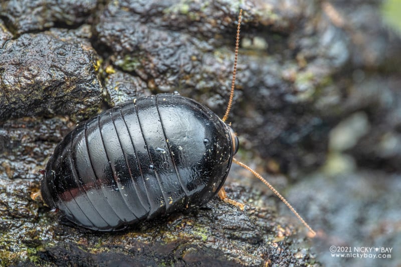

Still on the same log was this black pill cockroach. These little guys conglobulate when disturbed, like pill bugs and pill millipedes.
A macro photo of a pill cockroach
Pill cockroach (Perisphaerus sp.)

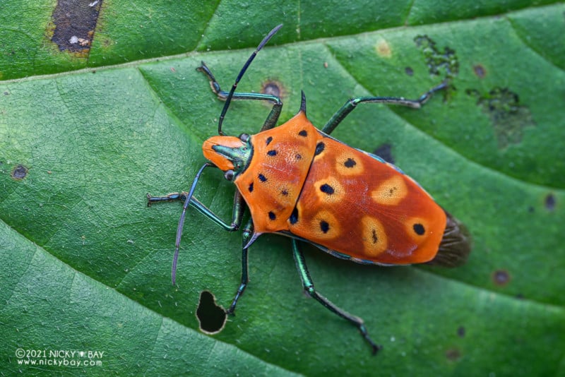

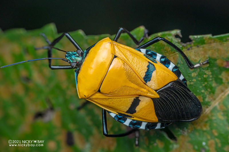

Amazingly, this bug is pretty common but this is the first time that I’ve ever photographed it. I’ve seen it on numerous occasions in the past but never had my camera with me. Tilt your head to see the “man-face”. This is also often called the Elvis Presley bug.
A macro photo of a man-faced stink bug
Man-faced stink bug (Catacanthus incarnatus)

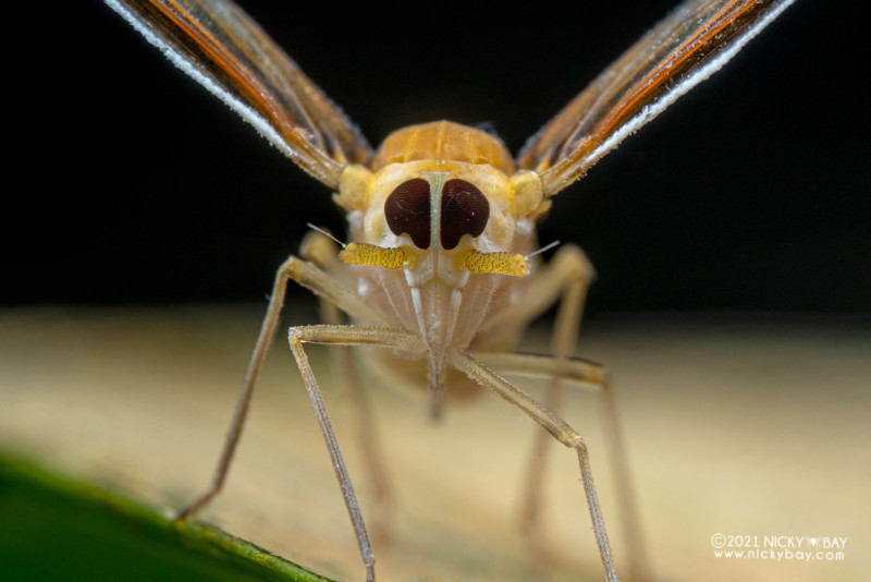

This is a very common derbid planthopper. Interestingly, we’d only see its pseudopupils in the day.
A macro photo of a planthopper
Planthopper (Derbidae)

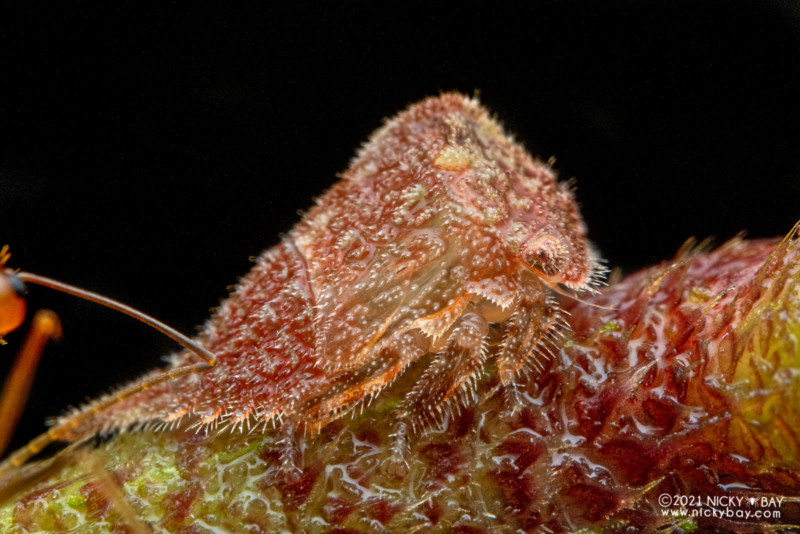

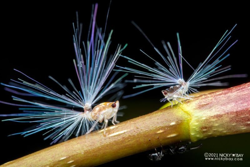

Also found this super tiny treehopper nymph. It kind of mimics a thorn and is often accompanied by ants who offer it protection. In turn, it produces sugary substances for the ants in a symbiotic relationship. This is from a single shot and heavily cropped.
A macro photo of a treehopper
Treehopper (Membracidae)

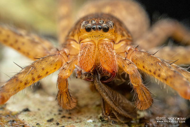

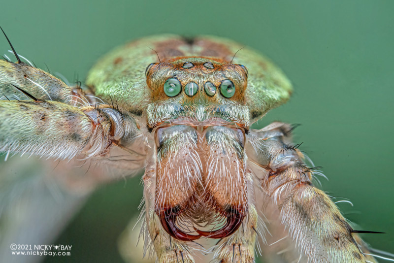

This huntsman spider was busy with its prey on a tree, so it was an easy target. Just one shot for testing.
A macro photo of a huntsman spider
Huntsman spider (Heteropoda sp.) For more huntsman spiders, check out my Sparassidae Checklist

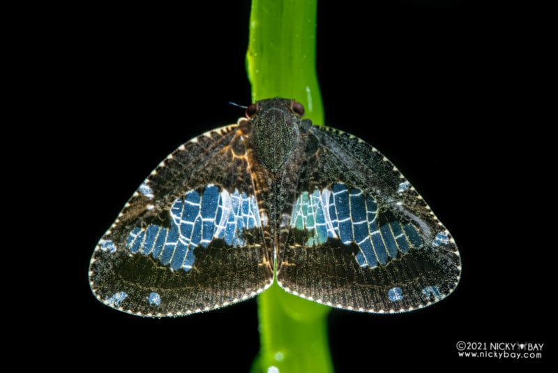

This moth-like planthopper had see-through membranes on its wings, so I positioned a flash behind it. The points of high contrast showed little to no chromatic aberration.
A macro photo of a moth-like planthopper
Moth-like planthopper (Ricaniidae)
