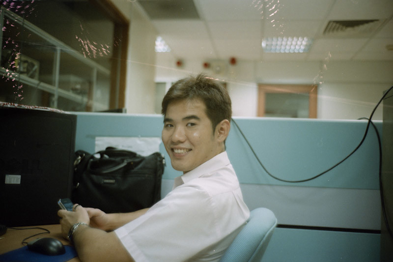

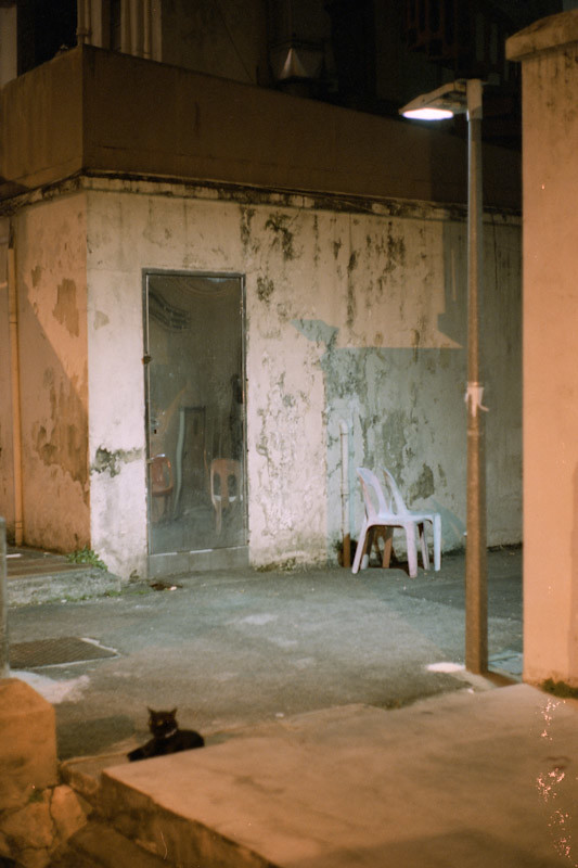

The rem-jet removal process was a messy one for the first try. Firstly some of the rem-jet sticks to the reel and tank, so it had to be wiped out. I am also worried that the rem-jet contaminates the bleach and the fixer. For the negative, I used a wet tissue to remove the rem-jet. I suppose some of the rem-jet went to the emulsion side as you can see in the following pictures. I am not sure if it is during development or washing which caused this. You can see the effects of rem-jet left over from the pictures. Many more experiments to go to harness the potential of vision 3 film!
Attached are some of the photos scanned using epson scan using V700.
Rem-jet not completely removed
I love the cinematic feel to this film when shot at night.
