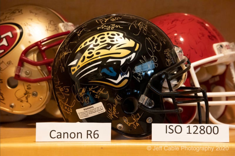

Canon R6 at ISO 12,800
If we zoom in and look at the photos, we can clearly see that we are losing detail in the image, but unless these images were printed very big, it would be hard to see this.
But when we zoom in, this is where we see the biggest difference in ISO performance between not only the Canon R5 and Canon R6, but also the Canon 1D X Mark III and Canon 5D Mark IV.
Canon 1DX Mark III at ISO 12800
Canon 5D Mark IV at ISO 12800
Canon R5 at ISO 12800 (Image lightened in Photoshop)
Canon R6 at ISO 12800 (Image lightened in Photoshop)
Amazingly, the Canon R6 outperformed all the other cameras, and in a very noticeable way. The R6 image not only retained much more detail than the other three cameras but also showed much less noise in the lighter and darker areas.
