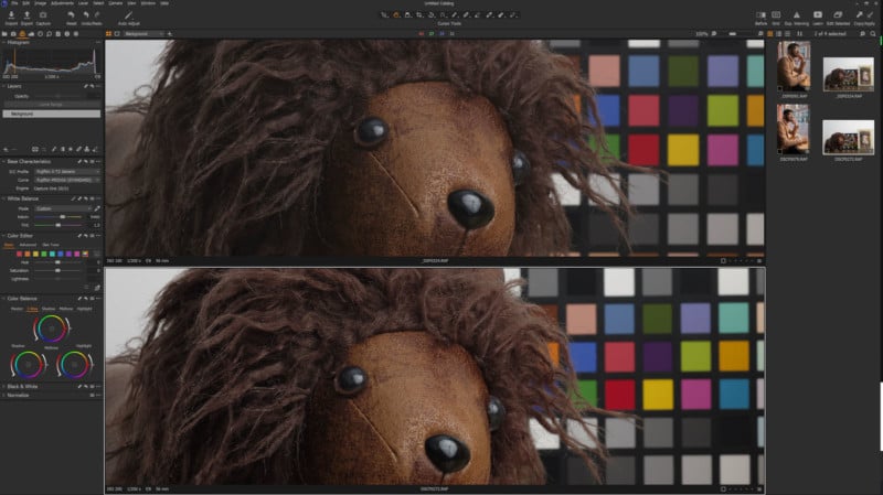

Up until now, all of the points I’ve made about Fujifilm colors could be described as personal preference and subjective. To challenge this, we have another comparison below. The images we’re looking at were taken on the Fujifilm GFX 100 with the 120mm f/4.0 Macro. Both images were taken with the same lighting and camera settings. Both images were processed in exactly the same way in Capture One and both files have noticeably different colors.
GFX100 + 120mm Macro. Single shot image.
GFX100 + 120mm Macro. Pixel shift image.
The difference between both images is that one was a single shot from the GFX 100 and the other a pixel shift image. The colors in the single-shot image are predominantly interpolated and through that guesswork, Fujifilm has produced a magenta-shifted image that is not accurate. Once you take that interpolation out of the equation via pixel shift features, you can see the difference. We now have an objective point about the colors that Fujifilm cameras produce.
Essentially, Fujifilm is saying that the original colors in the single-shot image are incorrect and it should actually look like ‘this’. Of course, some could argue that is the benefit of pixel shift. However, when you shoot with cameras like the Hasselblad H6D 400c, the difference in color isn’t anywhere as significant. This is because the Hasselblad starts off with much better colors even in its single-shot files. This is similar across the board with all of its cameras.
