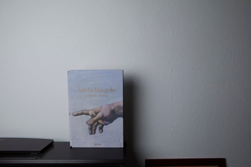

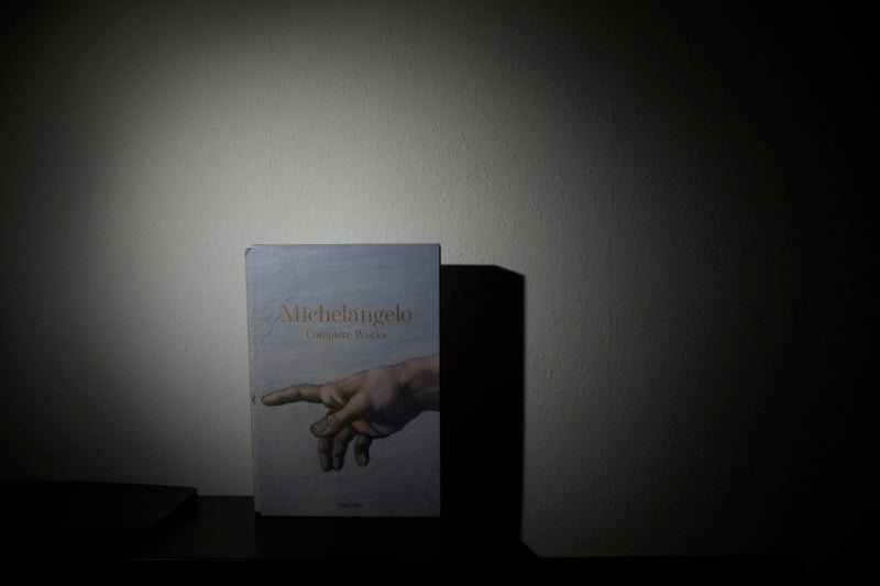

Hard Specular
In order to produce this light, I need a light source that is relatively small in comparison to my subject. I will use a magnum reflector that is specular and small in comparison with the subject.
You can see it’s hard by the shadow edges, and you can also tell it’s specular because of the highlight produced.

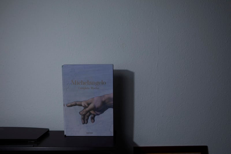

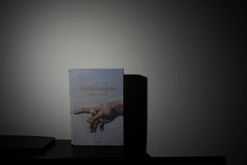

Hard Diffused
Now, I will not change anything except for adding a layer of baking paper on my reflector. It is still relatively the same size of the light source, although, technically it is bigger because the diffusion is the light source, not the individual points of reflection on the reflector.
Nonetheless, you can see that the light has become more even. It covers a larger area as well, and because my makeshift studio is very small, the contrast is also decreased.
Soft Specular-ish
Soft specular light is relatively hard to achieve. Let me detail why. As we established, a specular light is a light that is reflected in a small family of angles. Soft light on the other hand originates from a large light source. This implies that we would need to find a way to reflect a large light stamp in order to create soft but specular light.
A softbox may be the intuitive solution for this, but let me explain why it won’t work. A softbox with diffusion removed is nothing more than a flash tube with a poorly-lit interior of the softbox. For all intents and purposes, removing diffusion from a softbox will render it useless as you’ve exposed the flash head.
Here is how this looks:
Therefore, producing soft but specular light is in most cases impractical and undesired. You can, however, use a modifier producing soft light for photographing metallic objects. They will give off specular reflection, while the light will also stay quite soft on other parts of the image. Nonetheless, that won’t be a soft specular light per se.
Soft Diffused
Adding both diffusion layers to the 3-foot octabox will make the light a lot more even and result in light with gradated smooth shadow edges that are both soft and diffused. They are soft because the light source is large in comparison to the subject, while diffusion is defined by the light is a lot more even on the whole image.
