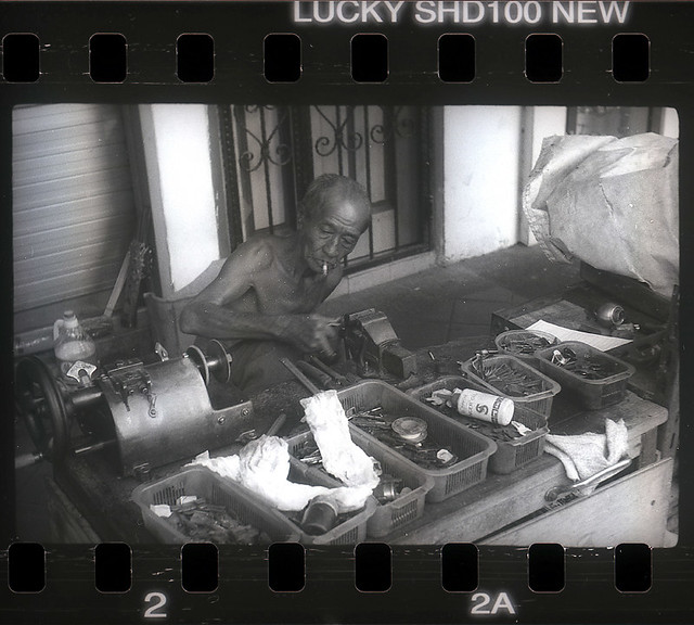

My first development on Lucky SHD 100; for DDX my settings are 3.5min @80F for the following:
I am not sure are any difference if I were to use 5min @ 69F ? (like contrast or tonality differences, etc.)
I am still a newbie in film developing, any more experience CS'er's imput is greatly appreciated.

Tried it, and not much different from my previous setups (going to post the shots in RF forum). I guess it has something to do with the developer use. And the more I look at my previous rolls, hmm, I think I kinda like the "dreamy" look. As I am trying to achieve the vintage style and the look has quickly grow in me.
I noticed from your photos are more contrasty than mine, can I know what is your agitation sequence? As per Lucky's instruction it stated that the more you "stir" (I decipher as agitate) the more contrast you have. I guess your agitation process is more than mine.
