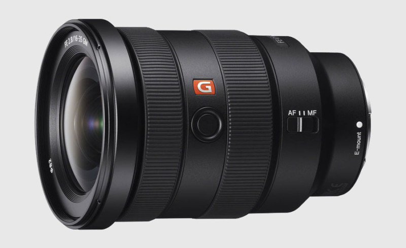

The Sony 16-35 f/2.8 GM lens.

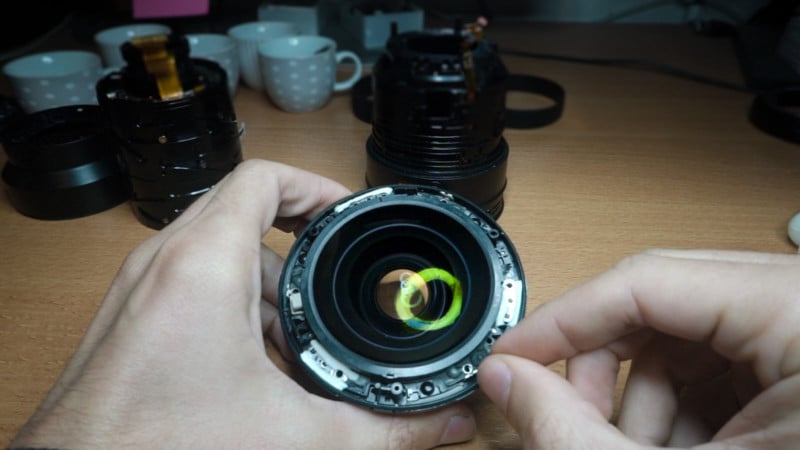

Back in France, I decided to open the lens with a friend, as the lens was out of warranty and repairs can be very pricey! If I can fix it myself, let’s do it.

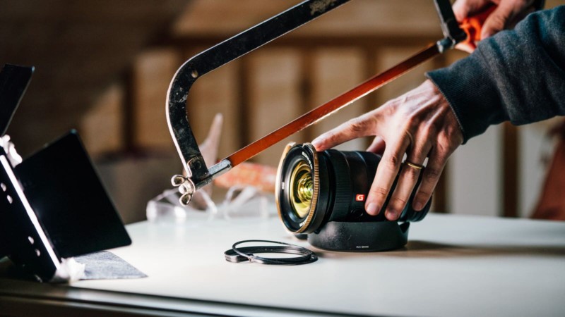

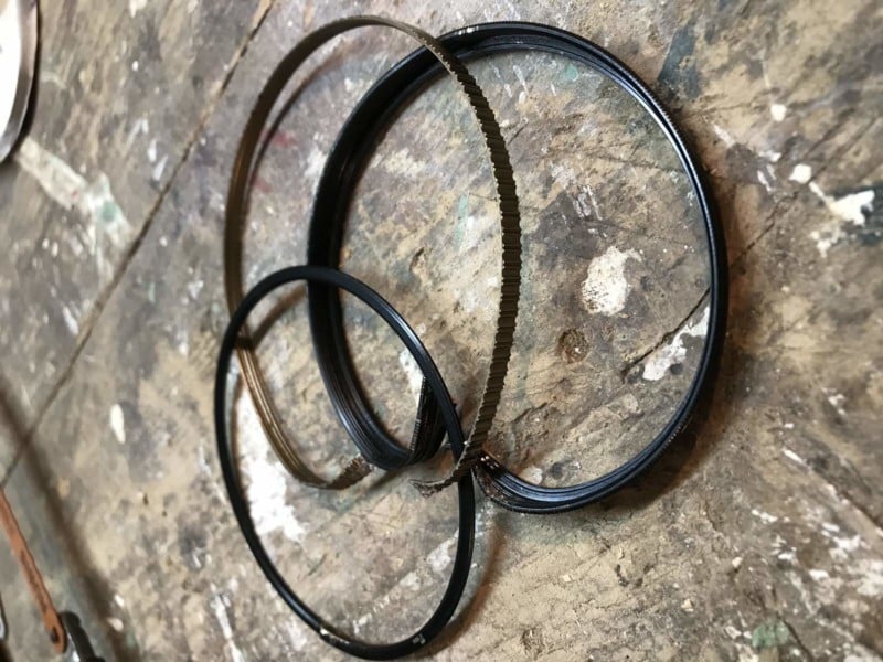

The first thing was to remove the filter ring. It was so “strong” (thanks PolarPro) that I had to saw it before bending it to get it off.

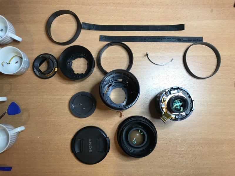

There was no info online about this lens’ internals, so we blindly and slowly made our way through all the parts. There are a lot of tiny pieces you don’t want to lose when doing so.
I was really amazed by how well it was all fitted together and organized inside.

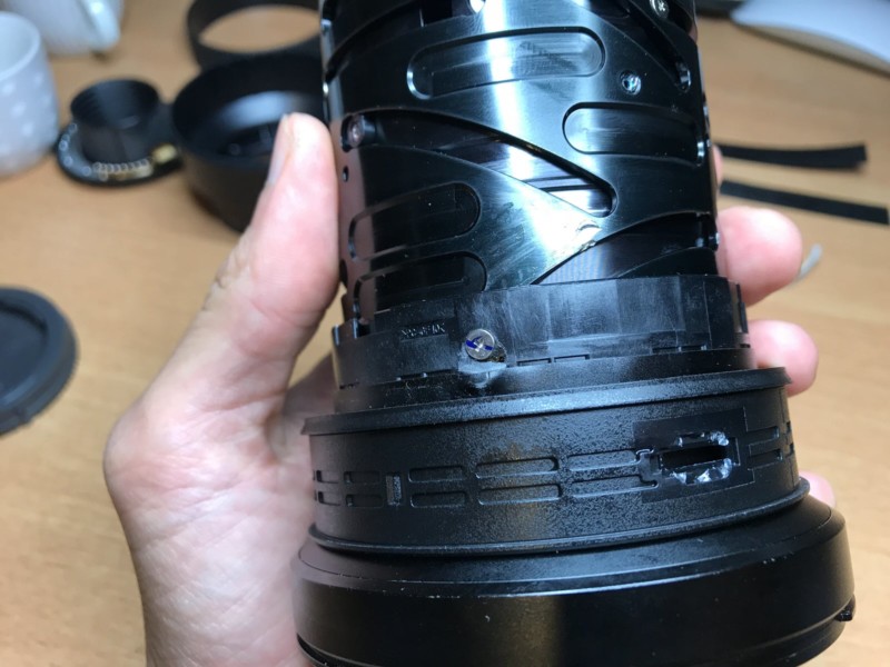

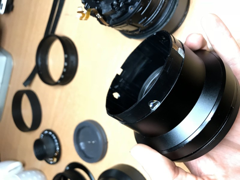

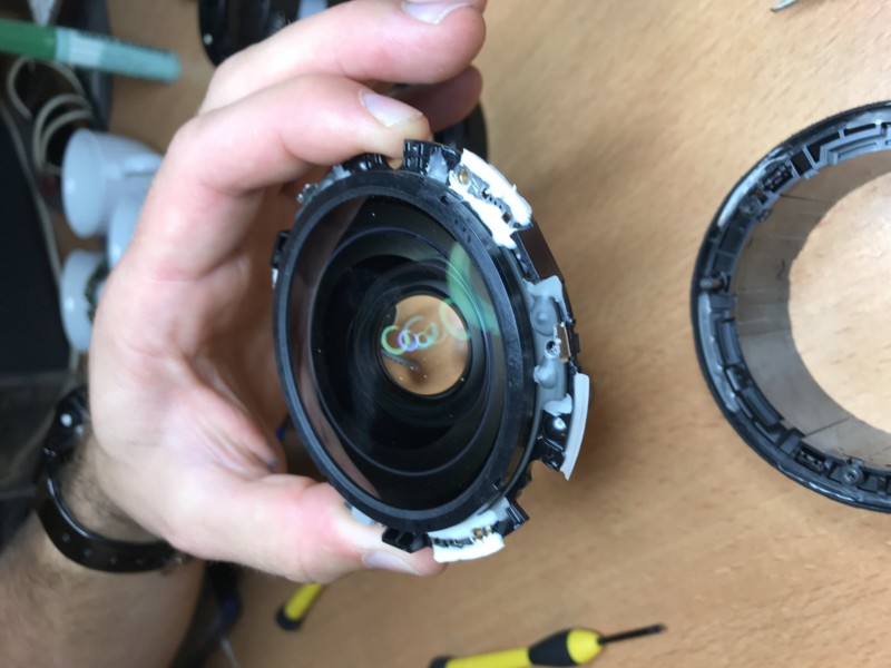

We had to find a few “hidden” screws (like the ones under the rubber and tape) to access the broken part. It was the front element “housing”. 3 screws hold the barrel and that element and the threads in the plastic broke there.
A broken part
Broken screw threads.

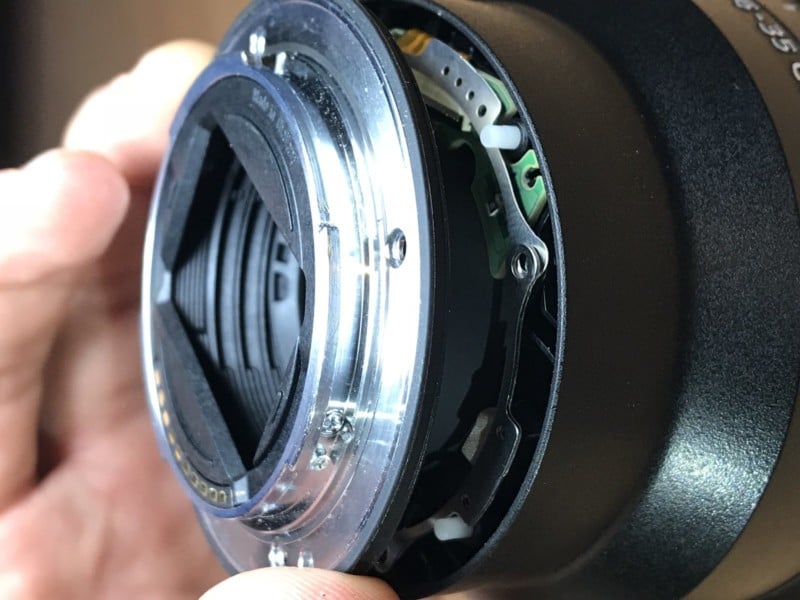

If you ever wonder why those lenses are so expensive… just look at the size of the front element!

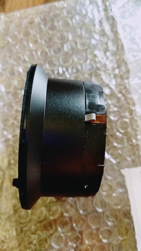

A friend had sent me a website with spare parts for that lens but none had photos nor a description, so I ordered the one that “sounded” right and crossed my fingers.
The new lens part I received.
A broken part
