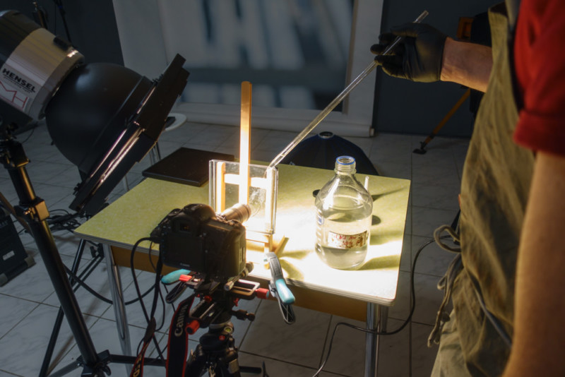

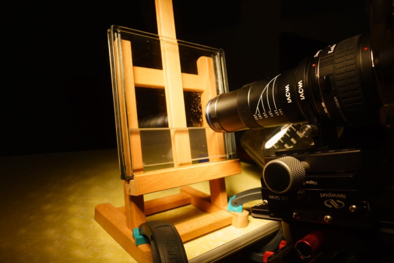

It was much more work to get the job done than I thought it will be. The depth of field at this magnification is about 1/10th of a millimeter. For that reason, I used a self-modified macro focusing rail — actually three of them — partly made of laboratory equipment. The focusing on my Canon 5D Mark IV was done via HDMI on a bigger screen. The screen on the 5D would have been too small for that.

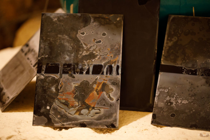

This was also the reason I consumed a lot of plates — it’s because I pre-focused before I put the plate in the glass tank to get a smooth video. If I misplaced the plate for only 2/10th of a millimeter, I had to do the shot again. But even these plates look kind of cool. I started to do scratches on the plates before I put them into the tank, so it was easier to focus.
Beside the tiny depth of field, every tiny vibration was a huge problem. If you see some tiny movements during the video, this is because we were not standing as still as we should have. I never thought the tiles on the floor move, but they do, even when we stand 2 meters away. That’s also the reason our making-of material is limited.

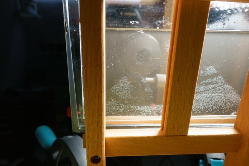

The next issue was the light, it heated up the chemistry and that resulted in little bubbles that showed up. So we had to clean the tanks pretty often to move them away.

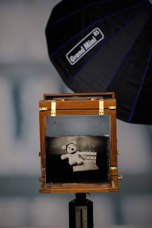

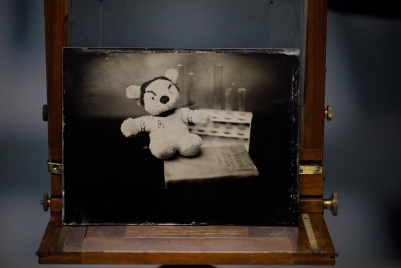

In the beginning, I pour a mixture of ether, alcohol, collodion, cadmium bromide and ammonium iodide on the plate. After I put the plate in the silver bath, this cadmium bromide and ammonium iodide turn to silver bromide and silver iodide – which are light sensitive. From now on I have to work under safelight when I put the plate into the plate holder.
After the plate holder is mounted on the camera I do the exposure. Now it’s time to go back into the darkroom and develop the plate. The developer contains ferrous sulfate that sticks to all the crystals that are charged with light. After stopping the development process with water I start to fix the plate. The fixer contains sodium thiosulfate that washes away the unexposed silver and the image appears.
