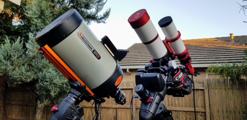

My first telescope was a Celestron 1100 EdgeHD model on a CGEM DX mount. It has an 11” diameter optical tube on top of a computerized, motorized mount that tracks the night sky and keeps the telescope pointed at the desired star or planet. But altogether it weighs about 140 pounds, stands about 7 feet tall, and requires quite a bit of patience to set up.
I have since also purchased a smaller widefield telescope, and it is indeed so very much easier to use. Having both, I see why the traditional advice is the way it is. I do recommend people to get a wide field telescope first unless they want to see the planets. In that case, you need more aperture, and that was my situation. I wanted to see the planets as detailed as possible, and I was not disappointed!
That first telescope is still my primary telescope, and I love every minute that I get to use it. It took dedication to set it up night after night, carrying it in and out of the house piece by piece, but sometimes there are those things in life that you just love, those things that nothing can keep you from enjoying. Astronomy is that thing for me.
My two current telescopes. The Celestron 1100 EdgeHD (left) and William Optics Z61 (right)

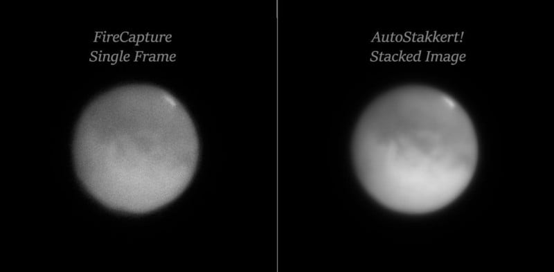

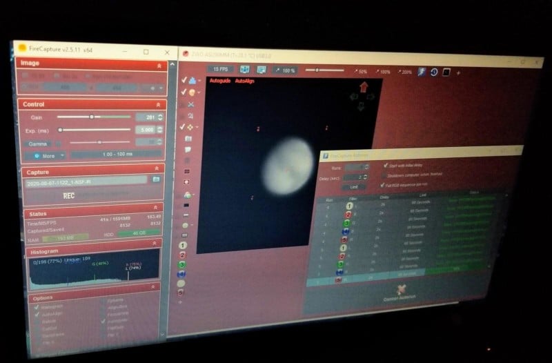

After that, it’s time to image! I use a program called FireCapture to bring in my data. This program has proven easy to use and does a great job collecting video files. It allows you to crop the scene down to avoid wasting time (and hard drive) recording empty space, and it can control various attachments like my filter wheel as well as automatically guide the telescope to keep the planet centered.
I really only need to adjust the gain and exposure setting, tell FireCapture how many seconds to record, and push start. The video file is saved and then it’s time to begin processing it.
FireCapture at work collecting Mars data
The first step after gathering the data is to run it through a program called AutoStakkert! (yes, the ! is part of the name). This program was made by another astronomer as a passion project and is absolutely amazing. It automatically sorts the frames by their quality, and then allows the operator to use as many or as few frames as desired to produce the “stacked” image.
Stacking is a term for taking multiple frames and averaging them together to reduce atmospheric distortion and noise from the image. Interestingly, stacking actually works for normal daytime photography too, but typically the noise in a daytime image is so low that it isn’t worth the time.
Once finished, Autostakkert! produces a single stacked image as a .TIF file. It is an amazing leap forward compared to a single video frame, but it still isn’t terribly impressive and often looks pretty fuzzy.
A stacked image produced from 1000s of single frames, luminance channel

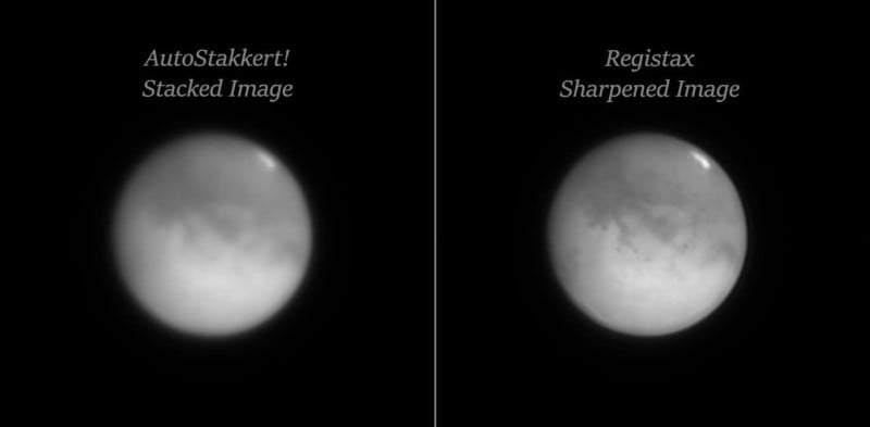

The next step after stacking is to sharpen the image using the wavelets feature of a program called Registax. This program used to be the go-to option for stacking, but popular opinion seems to be that Autostakkert! is the best these days. However, Registax has a sharpening tool referred to as “wavelets” which allows you to take the fuzzy, stacked images and produce a nice crisp shot. This really is where some magic happens.
The actual process of how wavelets work is probably something for a research paper, but suffice it to say, you move the sliders and watch the image come alive before your eyes. The same settings don’t often work from image to image, so it is a bit of trial and error each time, but the results are stunning.
Registax wavelets are used to sharpen a stacked image, luminance channel

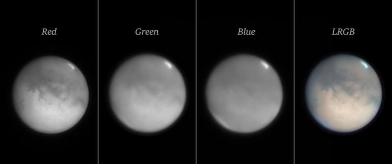

If you’re doing mono imaging, the Red, Green, and Blue channels must be combined along with the Luminance channel after sharpening. I use a program called winJUPOS to do that, but you can also do it in photoshop easily too. Color cameras can skip that step, of course.
Mars in R, G, & B, and combined into an LRGB image (luminance channel not shown)

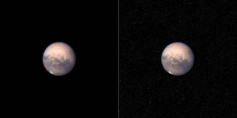

For instance, one thing I very much like to do is composite a starfield behind my planet image using Photoshop. The stars are real, and the planet is real, but the camera has zero chance of capturing that dynamic range in one shot, so it has to be done as a composite in post-processing. And really, I just like the way it looks.
Mars: final image as recorded (left) and final image with starfield composite (right)

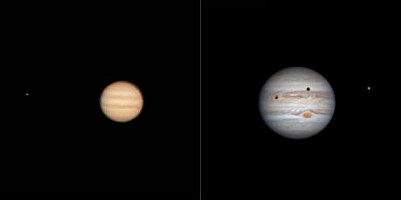

One last, additional piece for planetary photography is capturing the moons of distant worlds. These moons are out there, and they are amazing to see through the eyepiece. Those orbiting Saturn and Jupiter are especially prominent. But, just like how the camera cannot capture stars and planets at the same time, it is tough to capture some of the moons and planets at the same time as well.
For these, I take an overexposed video in FireCapture, which I then process in the same way as before, but this time looking for the faint moons. Afterward, I use photoshop to align the planet and moon images as separate layers and then blend them together into a combined final image.
Saturn: from start to finish with moons, using a color camera
