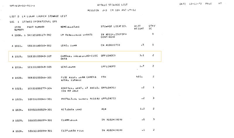

A little background. As each Apollo mission launched, NASA prepared a final stowage list that documented all the equipment aboard, detailing what was to be transferred between each spacecraft before and after landing on the moon. This list was then revised in real time as plans changed due to time or weight restrictions.

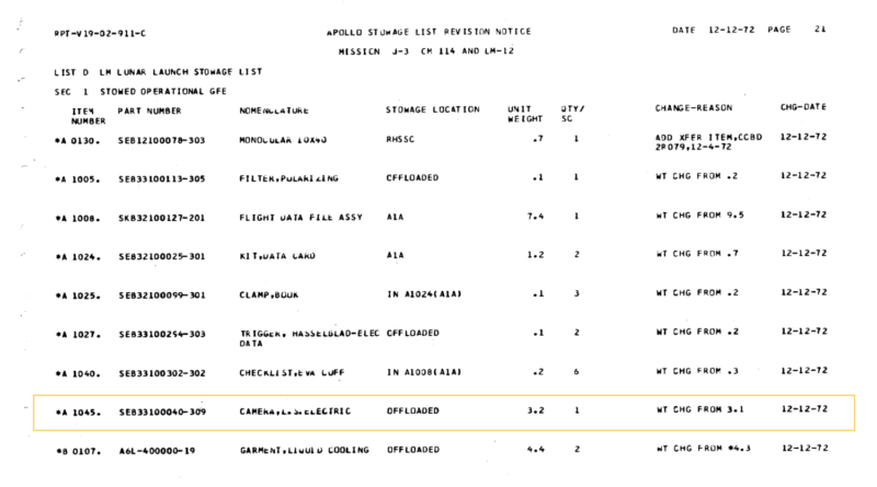

In the latest revision of the Apollo 17 LM Lunar Launch Stowage List, dated December 12th, 1972, the three cameras that went down in the LM are all marked as “offloaded,” meaning they were left on the surface. The problem is, they launched from the moon on December 13th! So if extra items were brought onboard, it’s not recorded. At least not in what’s available online.
Two Hasselblad Data Cameras with 60mm lenses marked as “Offloaded” in the AS17 LM Lunar Launch Stowage List
One Lunar Surface Camera with 500 lens marked as “Offloaded” in the AS17 LM Lunar Launch Stowage List

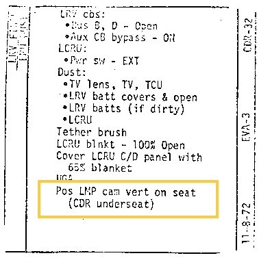

CDR Checklist pg. 32 instructing Gene Cernan to leave the LMP camera

  3. On Gene’s cuff checklist was an item to “Position the LMP camera facing up on the seat of the rover,” leaving it behind, but because NASA had just asked for that camera to be returned, Gene, following the checklist, positions the 500mm in its place, returning to the lunar module with the LMP in hand.

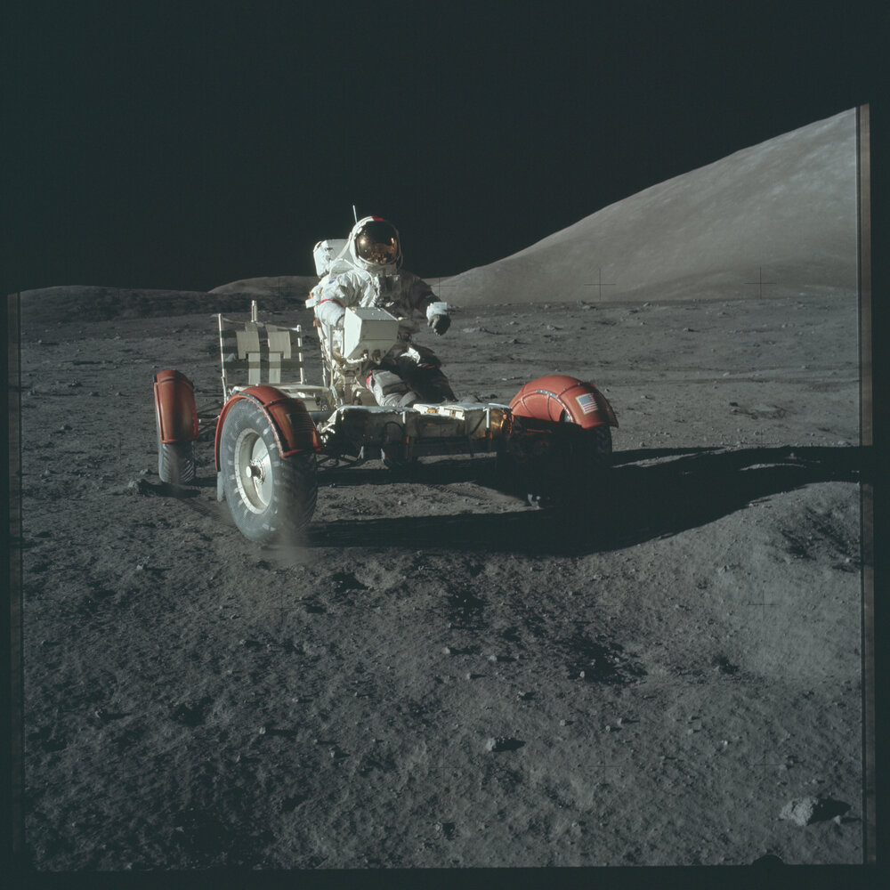

At the end of EVA-3, Jack Schmitt removes film magazine “N” from the 500mm camera, visible on the lunar rover.

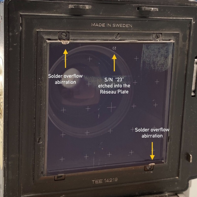

Every lunar camera has a unique serial number, usually etched into a piece of glass that’s pressed against the film plane. It’s known as the Réseau plate, used to help scientists both accurately measure objects in view, and identify what camera took what image. By simply looking through the photos captured on Apollo 17, we know Cernan’s CDR camera was S/N 1023, and Schmitt’s LMP camera was S/N 1032.
Granted, those numbers are not always visible, and are really easy to miss… I challenge you to scroll back up to the first photo in the body of this article to find the “23.”

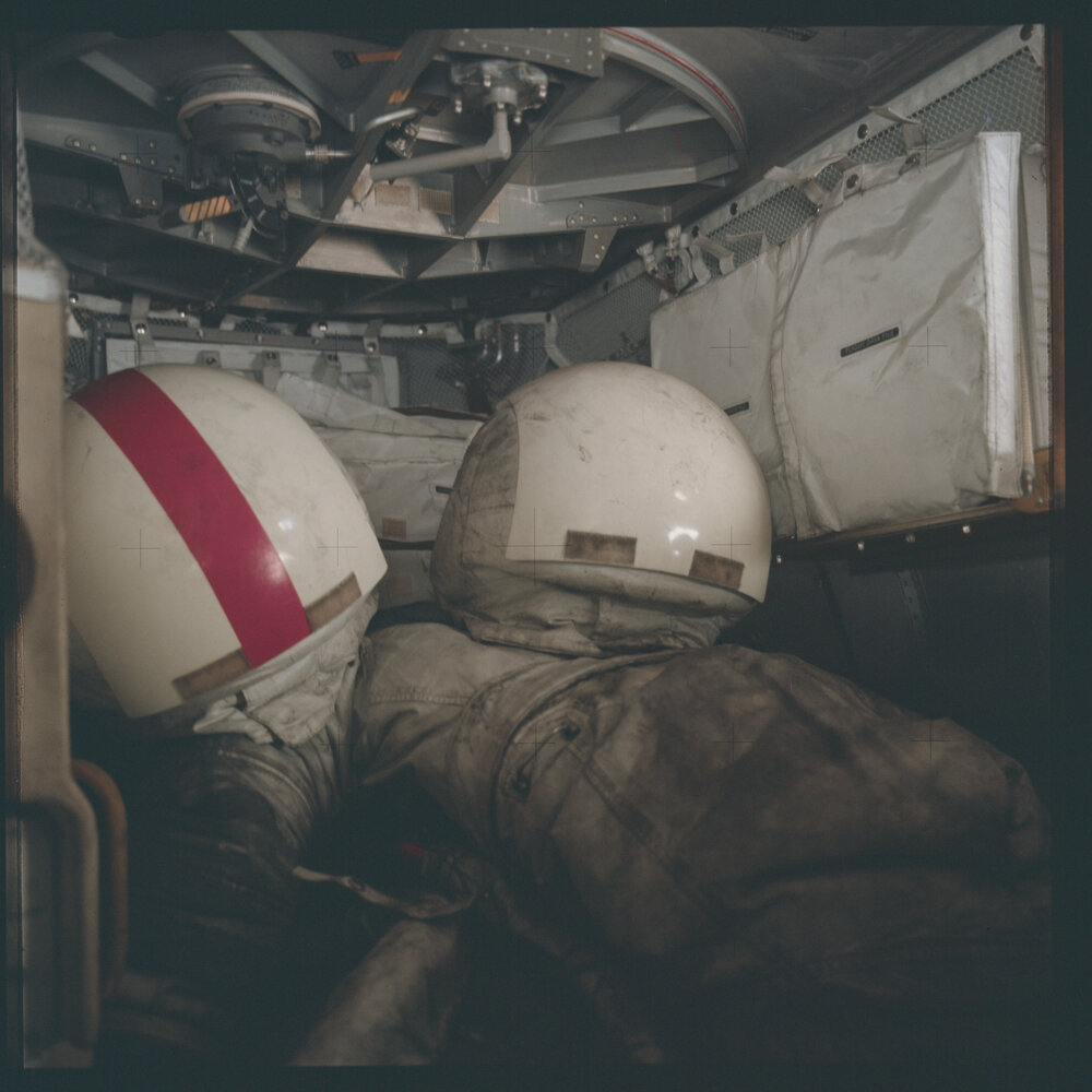

A close examination of photos taken after the astronauts ended their last EVA show both cameras onboard the LM, and only Cernan’s CDR camera in lunar orbit.

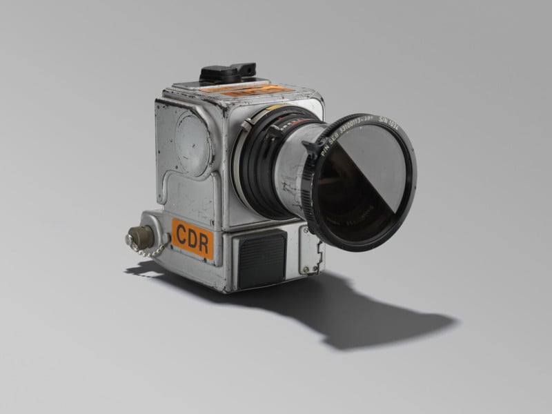

NASA Hasselblad Electric Data Camera (HEDC). Photo by Marco Nietlisbach
Now, as someone that’s been researching lunar cameras for half a decade, the camera immediately jumped out as authentic. One thing that caught my eye was the CDR sticker. There aren’t many accurate examples of lunar cameras online – many of the images you’ll find are a combination of commercial and replica parts based on loose information. Of the accurate examples, only flown cameras have this sticker.
When higher resolution photos arrived via email a few days later in March (Marco was very kind to share them as they’re a fantastic polarizer reference) I was able to get a closer look at the camera, and more importantly, the part and serial numbers: P/N SEB 33100040-307, S/N 1023.
Hmm. That got me thinking. If it was flown and used on the surface, there were 6 possible Apollo mission commanders it could have been assigned to. Apollo 11 didn’t use CDR stickers, so it was easy to exclude that mission. Scanning the stowage lists for the “-307” suffix on the part number identified it as a later camera, likely Apollo 15 forward, which whittled the list of possibilities down to 3 commanders. I started with the last mission, Apollo 17, searching for the “23” serial number at the bottom of every photo.
No. Expletive. Way.
Not 5 minutes into looking, there it was. Could this really be Gene… Cernan’s… camera?
At the time I remembered the story he had told countless times, having just finished watching yet another Apollo documentary. Like everyone else, I thought it was on the moon! Well… “everyone” as in the small circle of people as obsessed with this sort of camera history.
I immediately fired up Photoshop to compare the Réseau plate images in my inbox to photos taken on the surface, flipping the layers on and off until everything was aligned. It was perfect. Even the little bite marks from where the glass was attached lined up.
Identifying details on the Réseau plate.
Matching the serial numbers and solder overflows to a photo taken on surface:
Proof
Gene Cernan’s Apollo 17 camera is not only on earth, it’s at the Omega museum in Switzerland.
