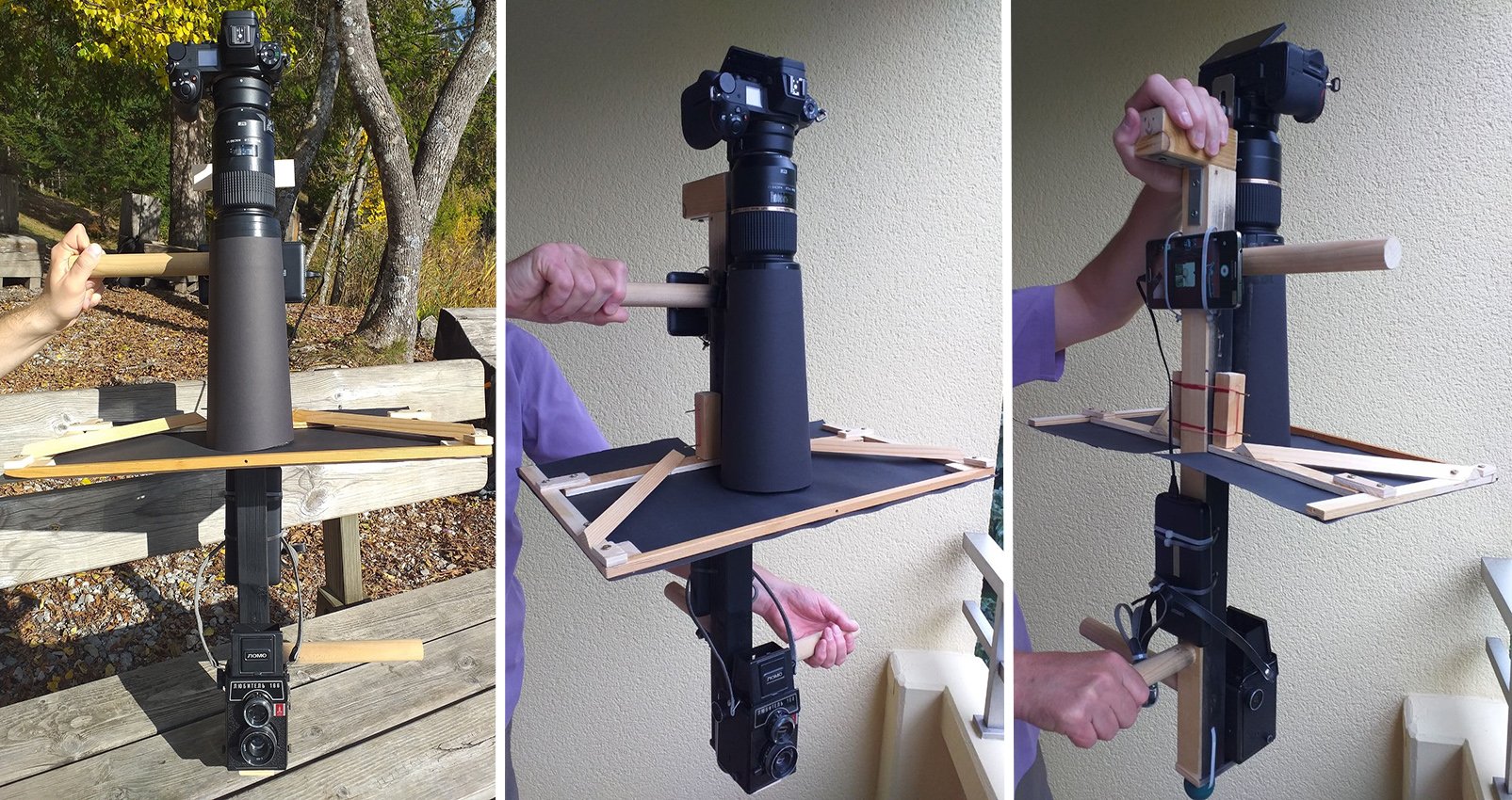

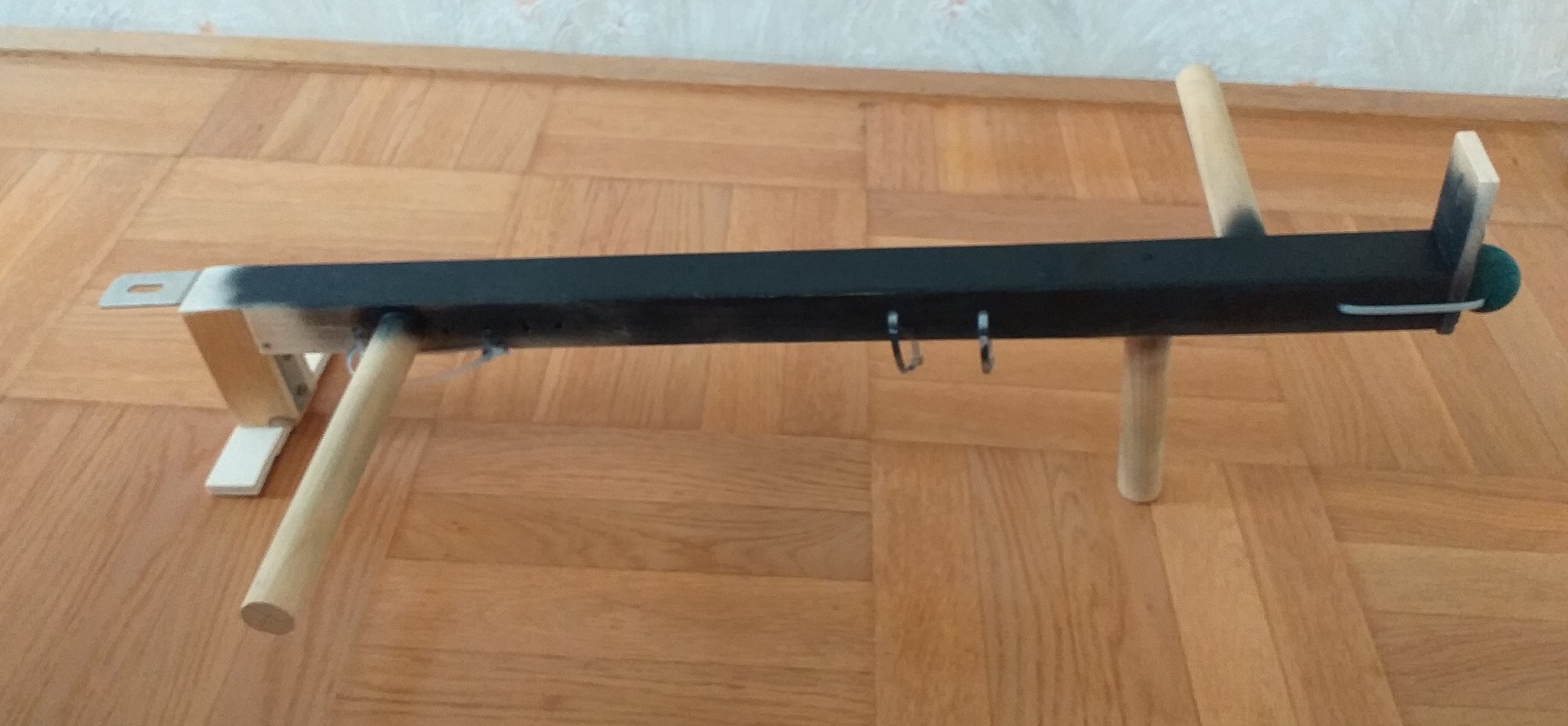

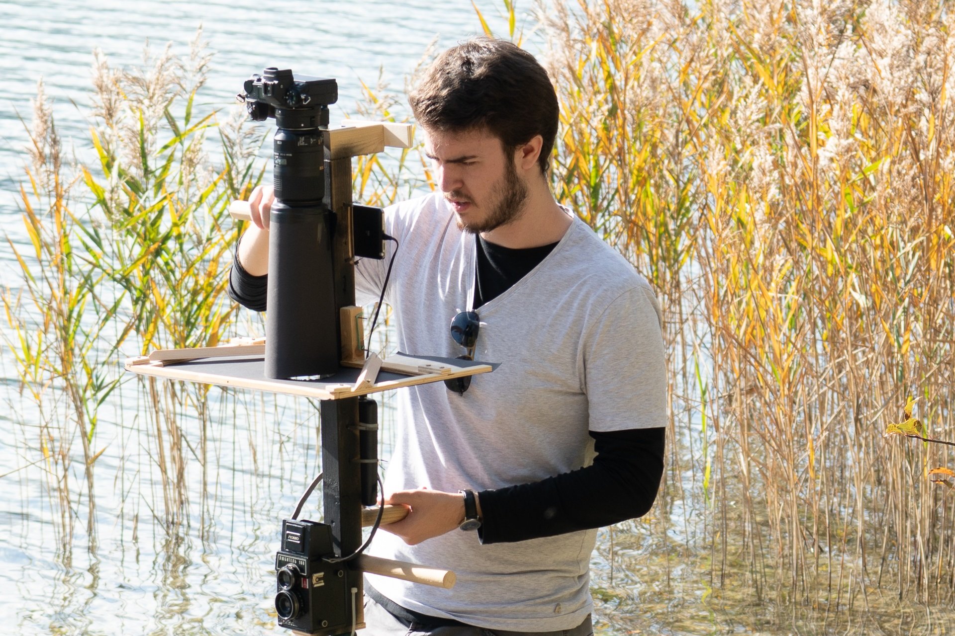

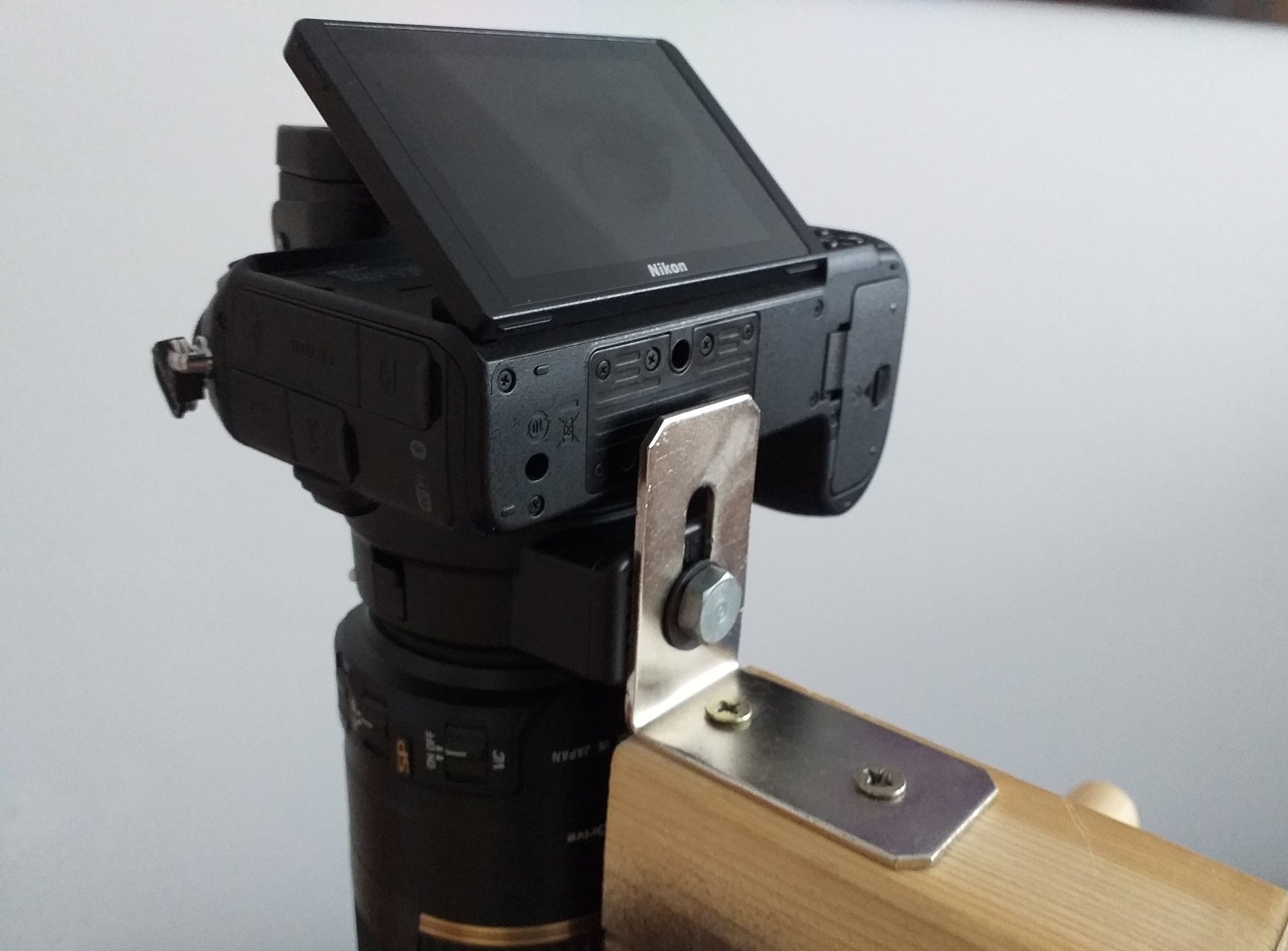

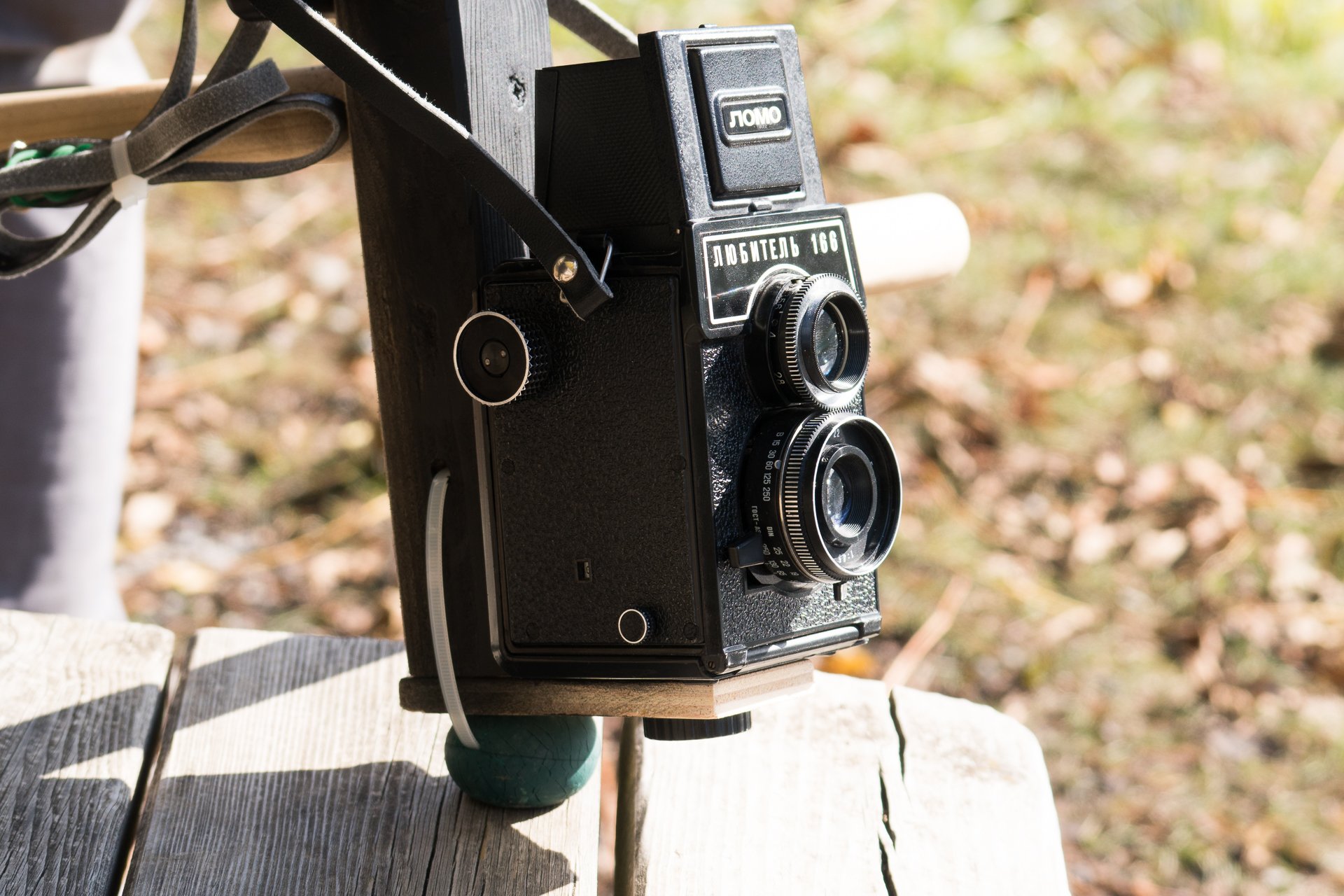

We used an 80cm square piece of wood as our main piece, attached an L-bracket that fit a standard tripod screw on the top (for the Z6), and added a small wooden board to the bottom, where we made a hole for another tripod screw (where the Lubitel is attached).
Then we needed a way to move this around easily, so we attached three grips, positioned similarly to what you might see on a farming scythe. We made the grips large enough to fit two hands, in case you need to hand it over to another person.

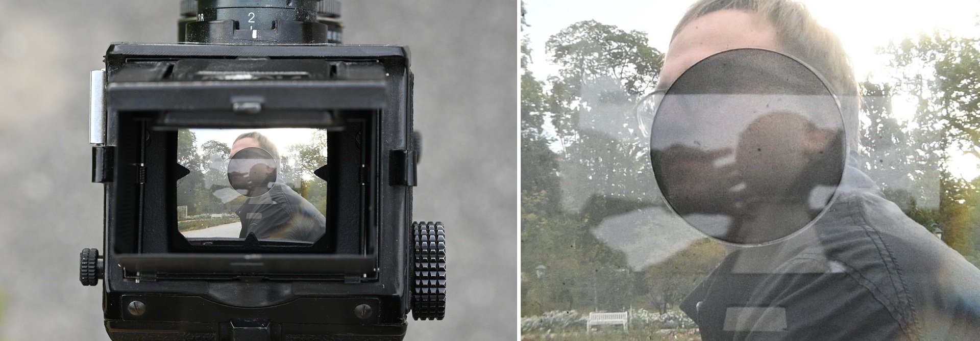

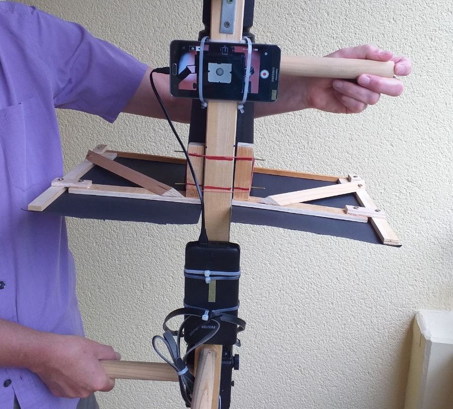

Our first test went okay, but we quickly realized that we were getting reflections of the sky, the Z6 and ourselves in the viewfinder of the Lubitel. Also, it was rather difficult to see the preview on the Z6’s screen, and quite dangerous to let go of the rig in order to reach the record button.

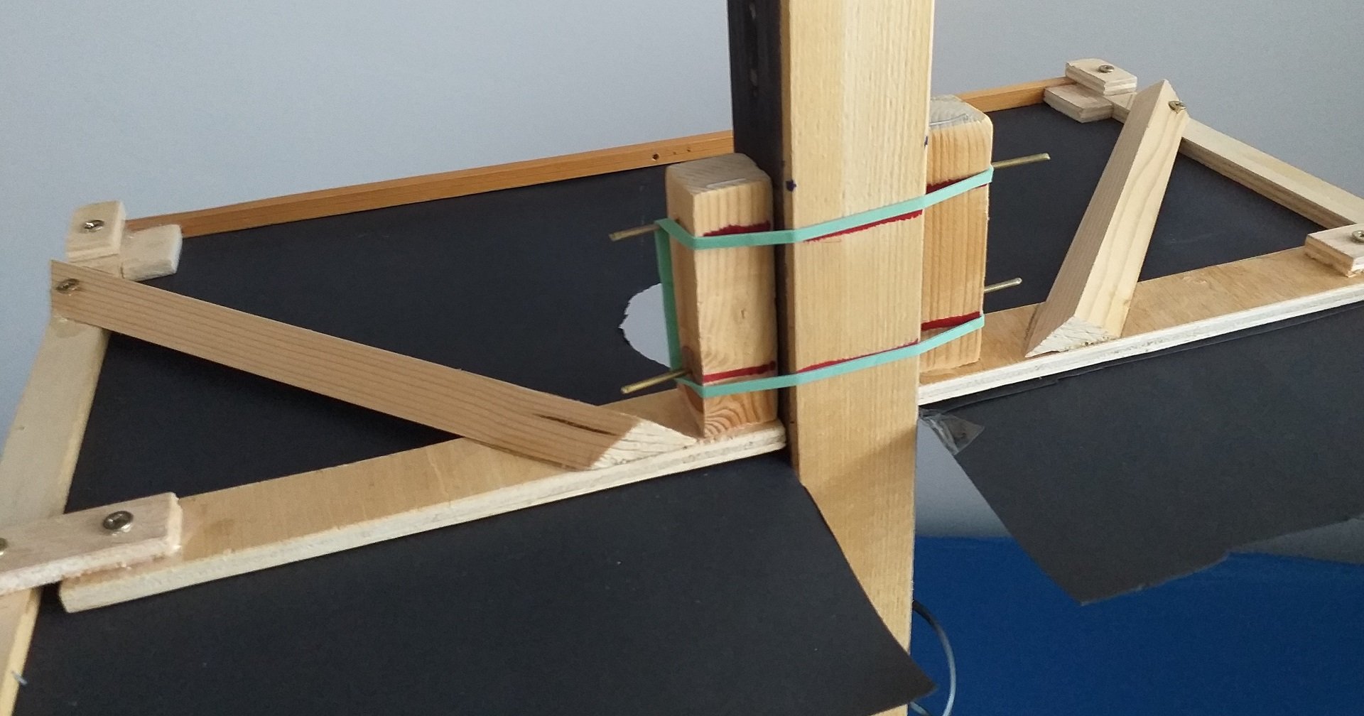

For the problem with the reflection, we built a shade out of black paper and wooden strips to keep it fairly lightweight, and made holes in the main piece where we could attach (and detach) the shade. We then added a chute to cover the hole between the lens hood and the shade, and painted parts of the main piece black.
Then we added attachments for an old smartphone that used via via WiFi and the Snapbridge app to see a live preview and activate recording without needing to let go of the whole rig. (As the old phone’s battery was dying all the time, we just plugged it into a powerbank).
Finally, in order to cushion the whole system for those times when we would have to set it on the ground, we attached a rubber ball to the bottom.
All the work was done by ourselves within two days: we cut the wood, drilled the holes, glued the pieces on and fixed them with screws if necessary. In the end, some attachments were made with good old zip ties or sticky tape.

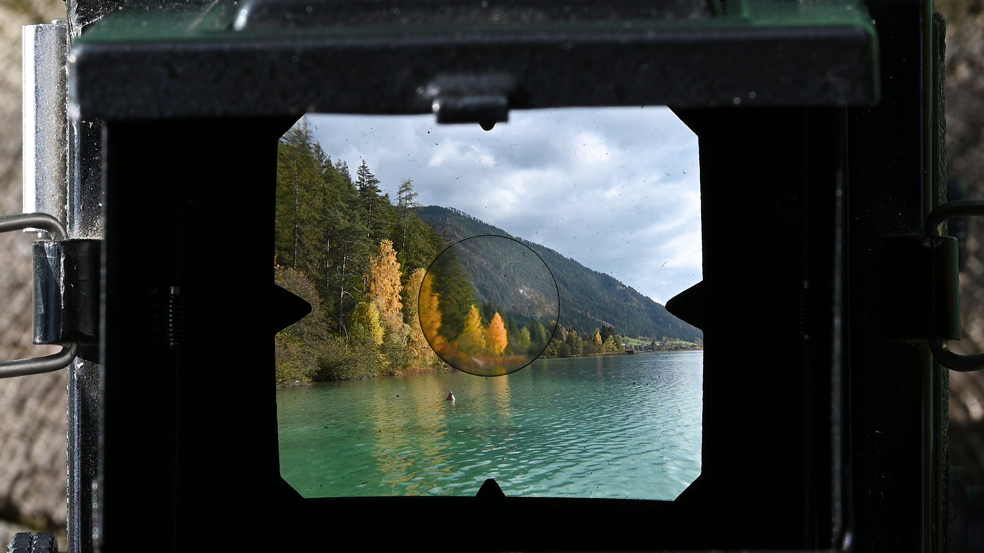

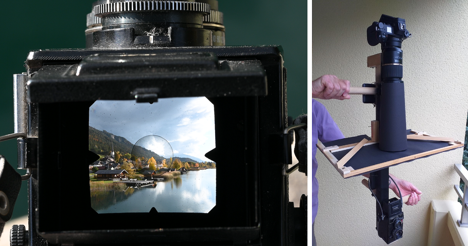

In post-production we only really brightened up the darker spot in the middle of the focusing screen. A creative decision was to not flip the image horizontally, which is why the image in the viewfinder is still mirrored, the same way it would be for a photographer looking into the viewfinder.
