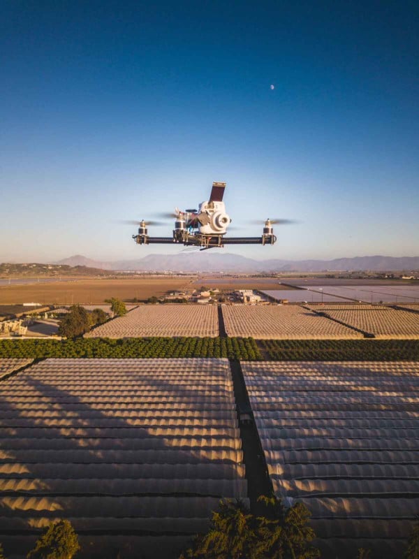

I had an extra 500mm quadcopter frame collecting dust and knew it was the perfect platform for this project. I used some spare parts from Open Grove Raceway including a DJI Naza V2 flight controller and some old UBAD 20a ESC’s to get it flying. After a successful test flight, I had to mount the instant camera.

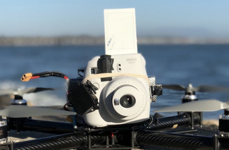

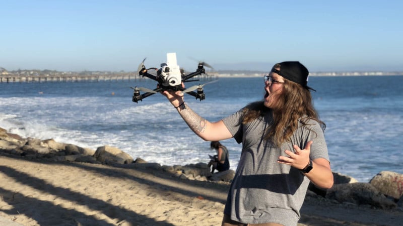

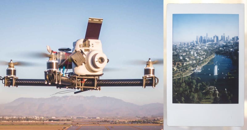

With the camera mounted on the front of the drone and 11″ props, I had about 2mm to spare in-between the camera and the propellers. This made mounting the camera very difficult as I had to remove the camera every 10 photos and put in a new instant film cartridge. I ended up using dual lock to mount the camera in a way where it was removable and used some rubber band reinforcement to hold the top of the camera back.

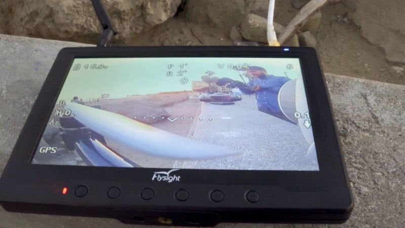

To have a reference of what the camera was seeing I used a standard FPV camera attached the side of the Instax with dual lock so I could have a reference monitor on the ground and to have a rough idea of what my camera framing was like.
To trigger the camera I glued a Futaba S3003 Standard Servo to the camera, plugged it into the flight controller, mapped the servo channel to a spring-loaded switch on the controller so it would only be at its limit as long as I held it there, and limited its travel in my remote. This made it so I wouldn’t burn out the servo from over-stressing it while ensuring that it travels the full range it needed to. I mapped the servo channel to a spring-loaded switch on the controller so it would only be at its limit as long as I held it there.

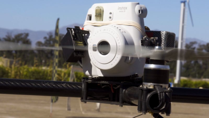

You can also see in the image below that there is tape over the flash. On these Instax cameras, the shutter speed is always 1/60th and the flash always fires. In early testing, I noticed that the flash was illuminating the propellers in some photos. Once I covered the flash mixed with the slow 1/60th shutter speed was enough to ensure the propellers wouldn’t show up in my images.
