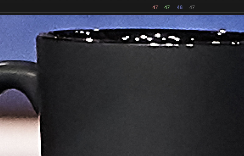

First, I make sure the color is correct by mousing over something neutral and making sure it’s actually neutral… white shirt, grey surface… for me, I can use the mugs, which are a nice matte black with white writing and generally work out pretty well.
If you look at the image below, the 4 numbers are Red/Green/Blue values and luminance (this is Capture One, remember). 0 is black and 255 is white. The screenshot below doesn’t show the cursor, but the mouse arrow was on the black of the coffee mug, and thus the values are fairly low.
When the RGB values match or are at least within a few numbers of each other, the colors in the image can be presumed to be correct. When the red number is high, the image will be warmer. Blue? Cooler. Green? Then it’s green, and you need to fix that. This image is showing to be just a tick cool, but I know from experience that I can never get this mug to be perfect. The overall look of the image won’t be affected.

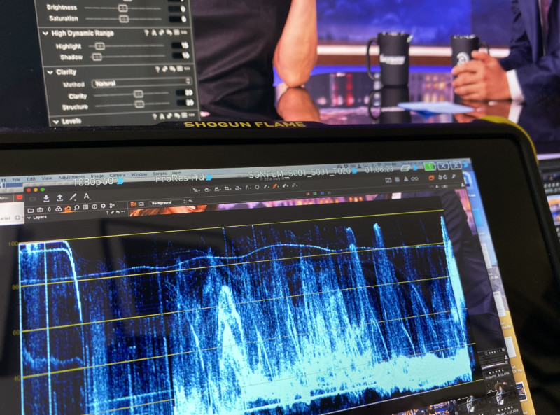

So, I use a waveform. Let’s take a look:
Keeping in mind that this is a phone photograph of two screens, here’s what I work with. The waveform here is showing me the luminance level of everything on the screen. On the “Y” axis of the graph are values from 0-100 IRE, with 0 IRE being black and 100 IRE being white. Happily, everything on the scope is where it exists on the screen.
This is one of the true joys of it, to me. The histogram and levels tools will just tell you what the values are, but it takes a little work to find *where* they are in the image, and really, it’s not all that useful for these purposes.
So here, if you look at the upper left-hand corner, you’ll see that the white is registering at 100 IRE. That’s the text in the Capture One settings box. Then to the right of that, I’ve circled where the arm of the person on the left appears. Here’s the true joy of the waveform: there are relatively standard settings that will allow you to know for sure that your image is correct, and they all involve skin tones.
Caucasian skin can safely be placed at between 65-67 IRE. If you look here, I put this particular skin tone at 65. I’ll just run the exposure up or down to place it exactly where I want it, and then I’m finished. I copy those settings and paste them to the rest of the images. I double check that my color is correct (RGB values match, remember) and I’m done.
