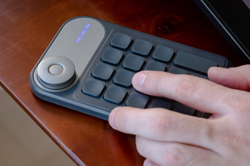

Like the Cintiq Pro 24, the Kamvas Pro 24 (4K) makes up for the lack of built-in function keys by shipping with an external remote the company calls the Mini Keydial KD100. It’s a wireless express key remote with 18 buttons and a mechanical dial that can switch between three different settings:
The Keydial lacks the solid metal build quality of Wacom’s ExpressKey remote or Xencelabs’ Quick Keys remote, but I actually found it to be more functional. Because it’s designed to mimmic the number pad on a full-sized keyboard, it was much easier to get used to the button placement and use the remote without constantly looking over to see which button I was actually pressing. It’s also worth noting that an external “remote” like this is more convenient for left-handed users.
All of that said, I still prefer pen displays with built-in function keys, and I like the way Huion and XP Pen have tackled the left-handed issue before. Both the regular Kamvas Pro 24 and XP-Pen’s Artist 24 Pro feature dual rows of function keys: one on each side of the display. Neither of these older displays can match the quality of the Kamvas Pro 24 (4K), but I find it more immersive when I don’t have to keep track of an external remote that takes up room on my desk (or display), uses up one of my USB-A ports for the wireless receiver, and needs to be charged from time to time.
Overall, I’m happy with the design and the build quality of the Kamvas Pro 24 (4K), especially the included Keydial remote. I just wish Huion had done a bit of innovating instead of sticking so close to Wacom’s Cintiq Pro design language. For all of the Kamvas Pro 24 (4K)’s technical improvements over the regular Kamvas Pro 24, the choice to go with such a sleek, minimalist design arguably takes away a little usability, and there are no exciting or quirky design elements to make it stand out.

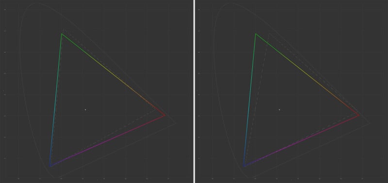

The Kamvas Pro 24 (4K) covers 95.9% of the AdobeRGB gamut (left) and 86.7% of DCI-P3 (right).
The most important and impressive piece of technology packed inside the Kamvas Pro 24 (4K) pen display is the display itself: a QLED (AKA “Quantum Dot”) 4K panel with 10-bit color, impressive color accuracy and gamut coverage, and “support for HDR.”
Huion really emphasizes the HDR support, a first for a pen display, but I’ve put it in quotes for a reason. With a maximum brightness of 220 nits and no local dimming, the Kamvas Pro 24 (4K) isn’t equipped for proper HDR editing. We at PetaPixel have maintained for quite some time that anything below 600 nits isn’t really HDR, as it would not be bright enough to provide proper contrast against the darks of an image. It’s nice to be able to view HDR content, and the increased contrast of a QLED display helps with that, but this feature is 80% marketing and only 20% useful.
What actually stands out about this display is the gamut coverage, color accuracy, uniformity, and the amount of control that Huion gives you through its on-screen menus. These are the features that make this one of the best panels you’ll find in a pen display.

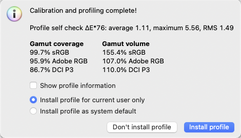

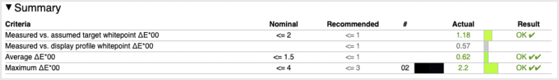

In terms of gamut coverage, the Kamvas Pro 24 (4K) hit 99.7% sRGB, 95.9% Adobe RGB, and 86.7% DCI-P3 in our testing, with a maximum Delta E of 2.2 and an average Delta E of just over 0.6.

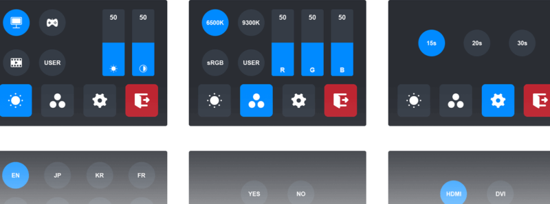

This is a very solid performance, especially when you combine it with the extensive on-screen controls that Huion’s latest Kamvas Pro displays provide. Just like we saw in the Kamvas Pro 16 (2.5K), the Kamvas Pro 24 (4K) features on-screen menus that allow you to dial in brightness, contrast, and individual RGB gains so you can properly calibrate your white point.
I’d love to have a built-in LUT for proper hardware calibration — a feature we’ve yet to see in a pen display — but this is definitely a step in the right direction.
Once I adjusted the RGB gains to match D65, I was able to get the measured vs expected white point Delta E below 1.2 and produce a perceptual match between this and the ASUS PA32UCG that I use for serious photo editing, making for a seamless experience when transitioning from mouse-and-keyboard editing in Lightroom to pen-on-display editing in Photoshop.

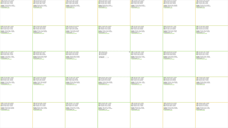

The screen was also impressively uniform. We ran a 35-patch test (7×5) and found only 13 patches that fell below the recommended tolerance (yellow outline) and none that fell below nominal tolerance. I’ve tested several “creator” displays that performed worse than this, so credit where credit is due: for color-critical work, the Kamvas Pro 24 (4K) makes the grade.
Uniformity test results for the Kamvas Pro 24 (4K). Click for full resolution image.
