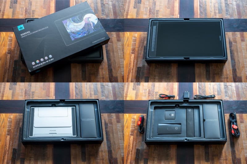

First things first: when you unbox the Kamvas Pro 16 (2.5K) you’ll find a little adventure in three layers.
Layer one is the tablet itself, which is enclosed in a plastic sheath with an additional peel-off plastic covering the screen itself. Next, you’ll find the “Foldable Stand ST200,” a basic stand that’s adjustable between 20 and 45 degrees, and folds flat when not in use. Finally, the last layer includes the pen, a pen holder filled with 10 replacement nibs (five standard and five felt) and a nib clip, a drawing glove, cleaning cloth, quick-start guide, and all of the cables you might want or need in order to hook the tablet up to your computer.
The cable selection is actually one of the major features of the Kamvas Pro 16 (2.5K) that’s missing from many similarly priced pen displays.
There’s a new “3-in-2” cable, which features a dual USB-C connector that forks into an HDMI and two USB Type-A cables. The HDMI carries video, one USB-A carries the pen input, and the third cable connects to the power adapter, while the dual USB-C plug makes for a more stable connection to the tablet itself because it doesn’t try to cram HDMI, a USB output, and USB power delivery into a single cable. That’s already a small improvement over most affordable pen displays, which use a “3-in-1” cable, but Huion also offers the option to connect to your computer using only a USB-C to USB-C cable, which is also included in the box.
That single-cable option, which can provide power, display input, and pen input all at once, is the kind of feature we’re only used to seeing from high-end displays that cost over $1,000, not affordable “mid-range” options. What’s more, some high-end displays are too power-hungry to run entirely off of a USB-C input, but the Kamvas Pro 16 (2.5K) is small enough that you can get away with a true single-cable connection—no power outlet required.

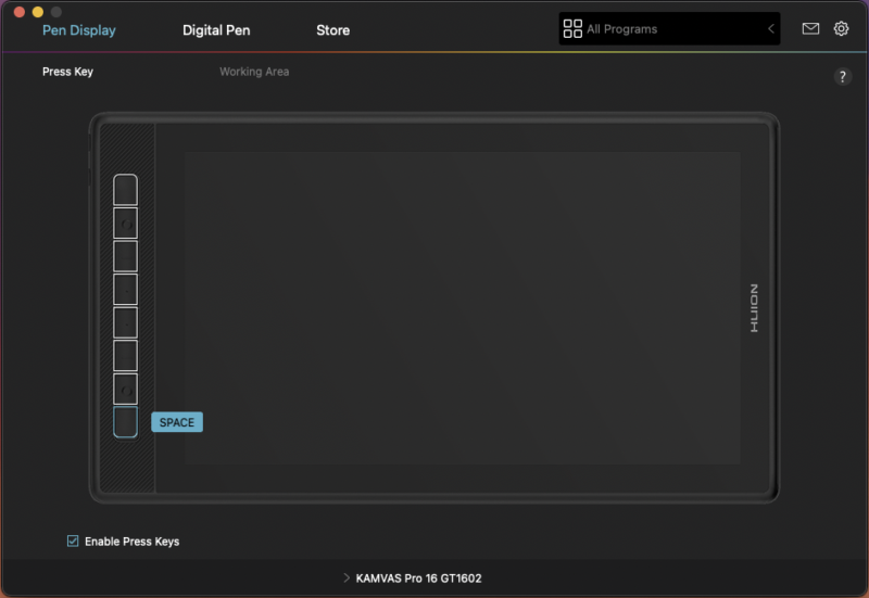

Truthfully, I like the new pen, but my favorite feature on the Kamvas Pro 16 (2.5K) is something else — something that companies have been systematically removing from their high-end options. My favorite feature is the eight programmable express keys on the left side of the display.
I absolutely love having built-in express keys. It’s way better than an external remote (in my personal opinion) because it allows me to stay fully focused on the editing task at hand, one hand on the express keys and one using the pen to do my actual editing. I’ve spent many an hour cleaning up dust or cutting out backgrounds without ever having to look up or, indeed, look over to the buttons themselves because they each have a raised plastic marking so you can feel your way across the keys.
No need for a keyboard and mouse, just full-on photo-editing flow.
Another really nice feature that will appeal directly to photographers is the option to use the tablet in “pen tablet mode,” which allows you to turn off the display and use the surface as a more traditional pen tablet. I’m a big proponent of editing with pen on screen because of the immediate feedback it provides and the precision that it enables, but once in a while, it’s nice to turn the screen off, even if it’s just to correct your posture for a little while.
Finally, the last (rather important) feature is the fact that the display is compatible with Mac, Windows, and even Android phones. I mostly used the tablet on Mac, though I did test it on Windows, and found the driver software easy-to-use and intuitive. You can remap the display, set the express key commands, adjust your pen pressure, rotate the display orientation (particularly useful for lefties), and dial in different settings for different apps, all within a few clicks.

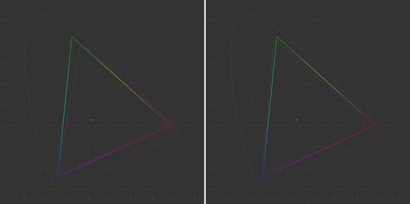

The Quantum Dot display in the new Kamvas Pro 16 (2.5K) covers over 95% of both the AdobeRGB (right) and DCI-P3 (left) color gamuts.
Both the Kamvas Pro 16 (2.5K) and Kamvas Pro 13 (2.5K) use QLED (AKA “Quantum Dot”) display technology to improve color accuracy, brightness, and contrast, producing the best visual quality I’ve yet tested in a 16-inch pen display.
According to my results using DisplayCAL and an XRite i1Display Pro Plus colorimeter, the Kamvas Pro 16 (2.5K) that we’ve been testing achieves 99.9% sRGB coverage, 96.6% DCI-P3, and 95.7% Adobe RGB at a Delta E of 2.25 and an average Delta E of just 0.5. That’s high-end “creator laptop” territory, and far better than I expected from a $600 pen display.

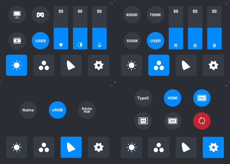

What’s more, Huion also gives you control over your display primaries — not just brightness, contrast, or color temperature, you can actually change the gains on your RGB channels to dial in your white point. This level of control is usually reserved for dedicated photo- and video-editing monitors, and it’s key if you want to properly calibrate your display. After futzing around with the primaries, I was able to hit D65 and match my main 32-inch 4K display perfectly.
