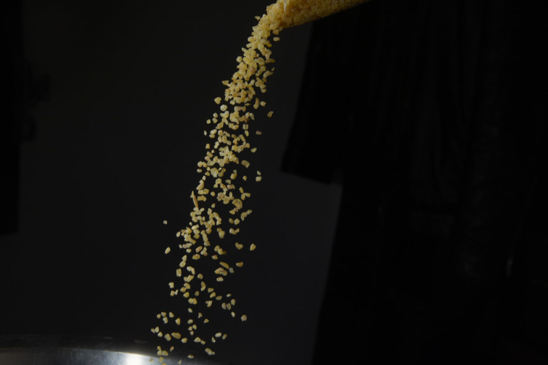

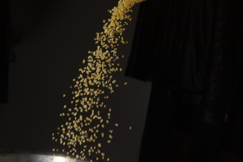

The left photo was shot with a shutter speed of 1/200th of a second while the right one was shot at 1/1000th of a second. So then… why does the photo with a much longer shutter speed have tack-sharp detail, while the photo with the highest shutter speed barely have any sharpness at all?
The secret is in the light.
Light is often a lot more important than the camera itself. Let’s go on to discuss how you can use light to freeze motion a lot better and with crispier results than with any possible shutter speed.

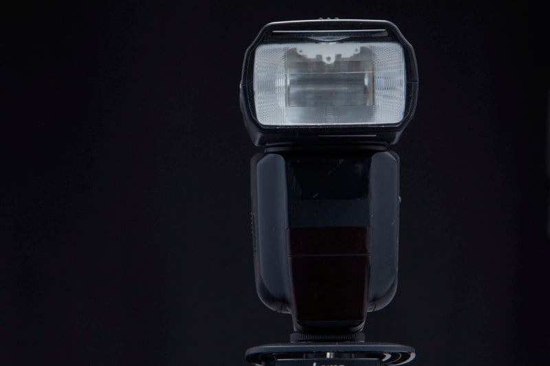

When used below or at the sync speed, a flash is essentially a short release of light to artificially brighten up the exposure of the photograph. This flash will have a few basic characteristics, the most relevant being the flash duration.
Flash duration is a measure of how long the flash is lit up. Some flashes such as the Profoto Pro-11 can have durations as short as 1/80,000 of a second. This means that the flashbulb is only emitting light for a very short period of time — much shorter than your camera’s shutter speed.
Different lights will have different flash durations at different powers, so it is best to check your flashes manual to get the exact numbers.

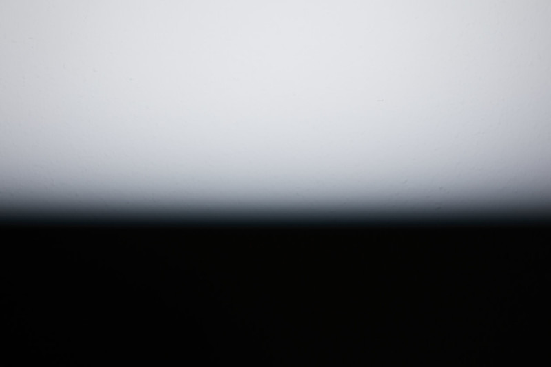

As you can see, even when the first curtain starts to open, it is already being chased by the second one. The shorter the shutter speed, the closer the two curtains are to each other. However, even if your shutter speed is 1/8000th of a second, it still takes the same time (usually 1/200th of a second) to expose the frame from start to finish. Therefore, a short shutter speed means less light reaching the sensor, not overall faster shooting.
In a way, the time it takes to capture at 1/8000s and at 1/250s is the same. If it weren’t, cameras would be able to have some ridiculous burst rates at extreme shutter speeds.
Sync Speed
The sync speed is a shutter speed at which the whole sensor is exposed to light before the second curtain comes in. That means there isn’t a gap that controls the shutter speed, as the whole sensor is exposed from top to bottom. At this shutter speed, of course, the sensor will see the whole flash, and it will not have any dark strips. Importantly, this applies to focal plane shutters (in which the curtains move to reveal the sensor or film).

Given that there is no ambient light, the second option is the best, as light makes the image, and the shorter the light burst, the better the image will be frozen in time. Therefore, it can be wise to use a shutter speed below HSS to freeze motion
This is why I am able to shoot at 1/15th of a second and still get tack-sharp results when I use flash.
Shutter speed: 1/200s
Shutter speed: 1/1000s (Exposure pushed higher in post to match previous image)
