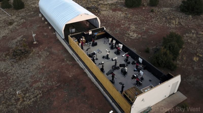

DSW Alpha is a ”Roll Off Building” (ROB) observatory. That is, the building literally rolls on and off the grid of telescopes according to when it is being used, or when it needs to be closed. It is a steel construction that runs on rails similar in design to a rollercoaster.
The building is “captured” both above and below tubular rails and is thus able to withstand high winds. A custom designed electric motor and gearing enables the 2.5-ton structure to be moved with ease.
To help you picture it, Lloyd says, “a common garden shed outfitted with wheels would make a fine observatory!”.
DSW Alpha started as a 25 x 30 foot, 9-pier facility but the modularity of steel construction allowed them to add more roof sections as needed. There is now an additional 25 feet of roof and 9 more piers, which were installed in summer 2016. They now refer to the upgraded facilities as Alpha 2.0.

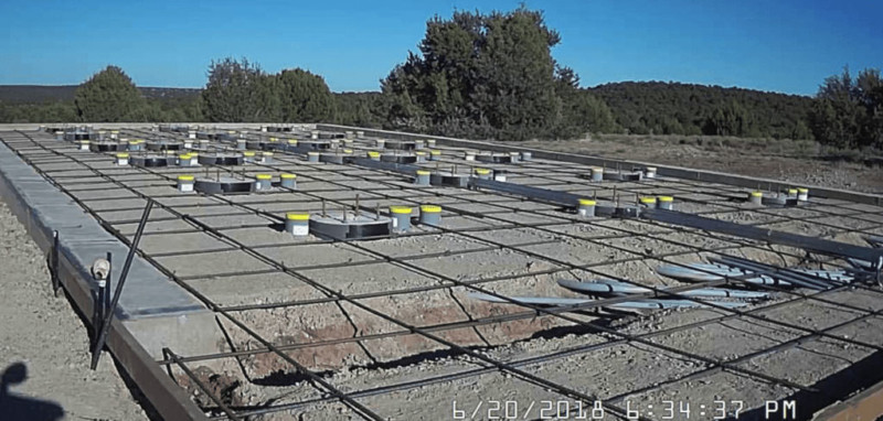

A second observatory is underway and expected to be completed by September 2018. It’s called, wait for it, DSW Beta, which follows the same basic design.
DSW Beta under construction
A construction camera can be seen live which is documenting everything for a time lapse to be produced when construction is completed.

A number of other design elements play a critical role in the effectiveness of a roll-off building:
First is overhead clearance.
DSW’s overhead clearance is 9.5 feet and all imaging systems are kept below this level so that contact between any equipment and the roof is impossible.
When weather conditions demand, the observatory can close without regard for the position of any system. “There’s no need for special “at park” sensors or anything similar. When it’s time to close, we close.”

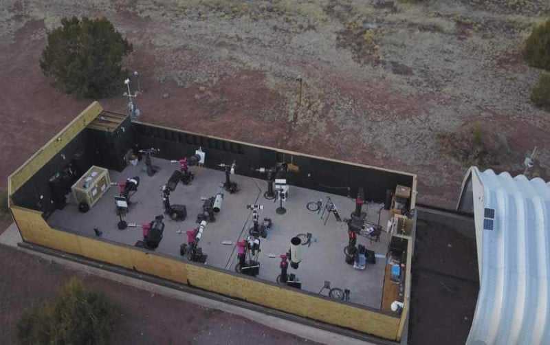

The second design element is the inner stub wall system.
This provides protection from ground-level dust and other unwanted elements. They give the feel of a traditional roll-off roof but are stationary and non-load bearing.
The stub walls are convenient for power outlets, flat panels, etc. Some traditional ROBs go so far as to motorize the southern wall to increase visibility to the south. At Deep Sky West they just limited the southern wall to 4 feet – “southern views go down to the horizon if you want to chase a southerly target” and does not require any additional automation.
