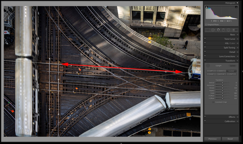

	STEP TWO: I’m going to click and drag out the tool along the left track (I added a red two-headed arrow here to show you where I’m dragging. The tool itself lays down a white line, but it was hard to see it in this small capture, so I added the red line just as a visual. When you use this tool, the lines will be white. When you drag out the first line, nothing happens yet either.

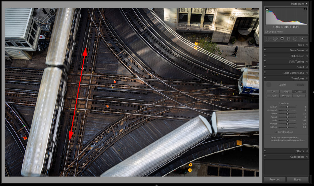

	STEP THREE: When you draw the 2nd Guide Edit line out (as seen here, where I dragged along the track on the right of my first line) you can see the image starts to straighten out. Depending on the image, you might only need two lines, but in this case, the image still looks skewed (the tracks look like they’re leaning downward from right to left through the horizontal middle of the image).

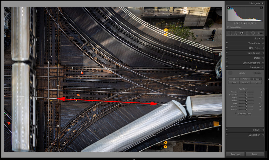

	STEP FIVE: I dragged the fourth and final line down the opposite tack, and you can see it’s pretty close now, but look up at the top center track, and you can see that when the fourth Guided Edit line did its thing to straighten out the image, it make the top centerline off by a little. Easily fixed because you can reposition the lines once they’re in place by clicking and dragging.

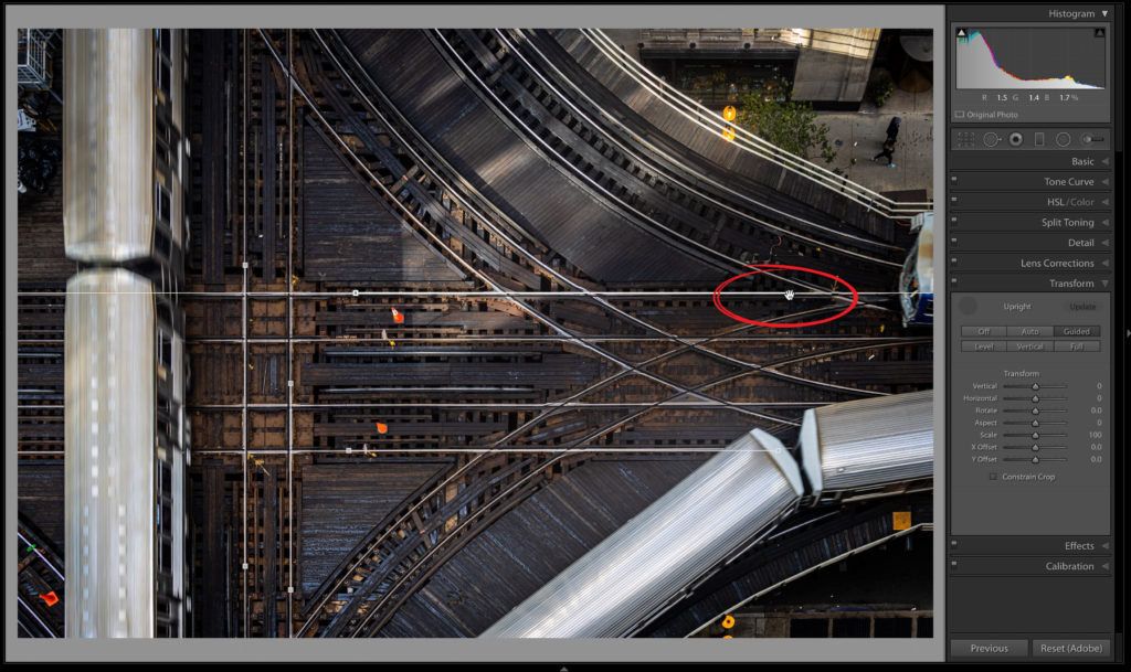

	STEP SIX: I dragged the little repositioning dot on the top line (not quite sure that’s its real name) shown circled above in red and dragged it upward so it’s straight along the track again, and the image readjusts (as you can see here) and now it’s nice and straight.

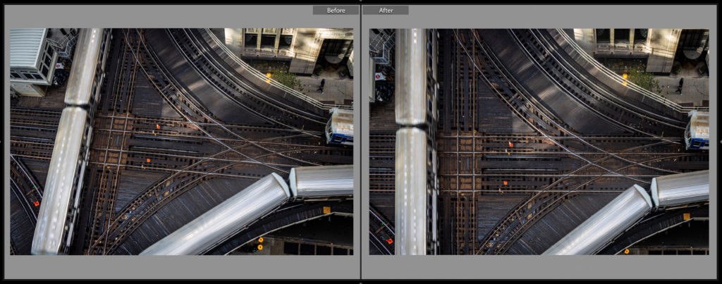

	Here’s a before and after the correction.
