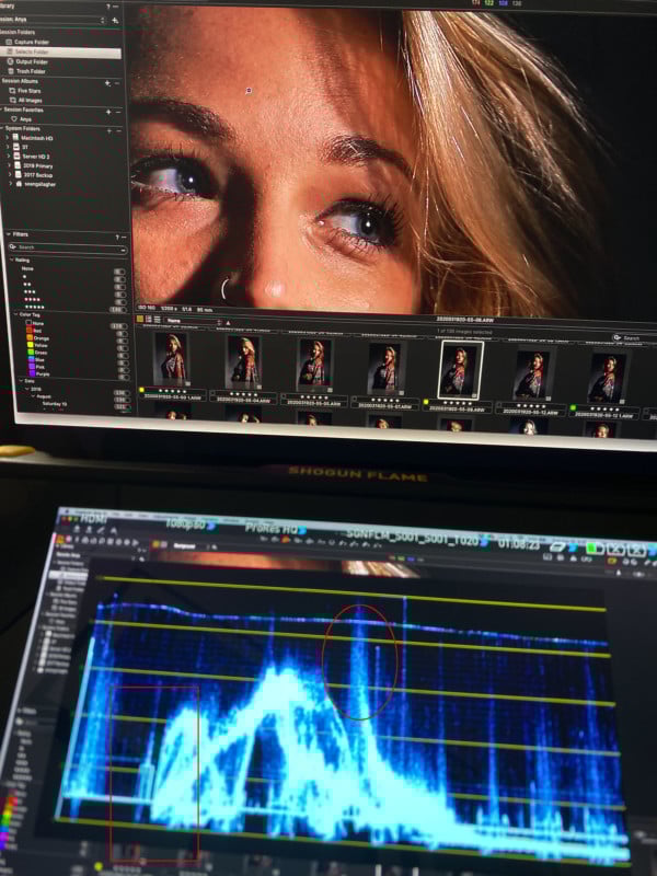

This is your waveform screen. On the left, in the red box, you’ll see numbers from 0 to 100. Depending on where you work, these numbers will be called different things: IRE, nits, units. Whatever the term, it doesn’t matter… the number is the number. I generally say “units.” Personal preference.
Ok, now that you’ve found the numbers, look across the screen. What you see on the left is what is on the left of the screen. The same goes for the right. If you want to find something in the photo, it’s on the corresponding portion of the scope.
Here you can see the waveform with a photo on my Capture One screen. (This will work with Lightroom, or Photoshop, or whatever application you use. I’m happily married to Capture One). You’ll notice the image is zoomed in. I do this intentionally. I will eventually zoom in even further.
This is one thing we have over the video engineers! When you’re working as a camera shader, you have to stare into the waveform like it’s the matrix and pick out your skin tones. Here, we can zoom in.
In the image above, I put a red box around the border of the image. I use this edge to quickly orient myself—remember, generally when I’m doing this I’m rushing to submit my images for the night, so everything has been about speed. On Fridays, when we’re not locked down, I’ll work through my weekly “Week in Review” submission and I can be a little more leisurely about it.
The red oval in the image is around the brightest part of the photo, which is the highlight in the woman’s hair. If you study the waveform you can pick out the catchlights in the eyes. The regular lines you see on the right hand side correspond to the thumbnails in the Capture One browser. Don’t forget you’re looking at your entire screen, and not just your image.
If you notice, there is a gradient leading up to that highlight with the oval. This represents the gradual lightening of the skin leading to the highlight on her forehead. Here is where your eye and some discretion enters into the process. You need to make sure that you choose the most neutral part of the skin.
Choose a portion of skin that isn’t reflective at all and that is the most “normally” lit. In the photo above, you’ll see almost a white glare on the skin, right next to the hair; directly to the left of that is a nice, flat portion of skin that’s well-lit. That’s where we’ll go.
Once again, you’ll see the line at the border of the monitor to help you find where you are in the image. Directly next to that is our nice, even piece of skin. What I recommend you do at this point is to just grab sliders and start running them up and down to see what everything does to the scope.
“Exposure” is the easiest way to move the whole waveform up and down, but almost every slider will have an effect, even if it’s subtle. Even dragging the white point in on the levels histogram will have an effect.
So directly next to the border of the image we have our nice even portion of skin. You can see on the histogram as you go to the right what the speckled reflective highlights look like and why skin that appears like this is not ideal for this process. And again, as you look across the bottom of the image, the regular patterns are thumbnails in the Capture One screen.
65 units is a nice spot for caucasian skin. We’re about there. Let’s zoom out and see what it looks like.
65 units, dead on the nose. This is an iPhone photo of my laptop, so it’s not a perfect shot, but she’s perfectly exposed. Her skin has great detail everywhere, and nothing is clipped at the high end. I’ve crushed my shadows ever so slightly, and you can see that tale on the bottom line; on the left, the “meat” of the data touches the 0 line, and gradually rises juuuuust above it.

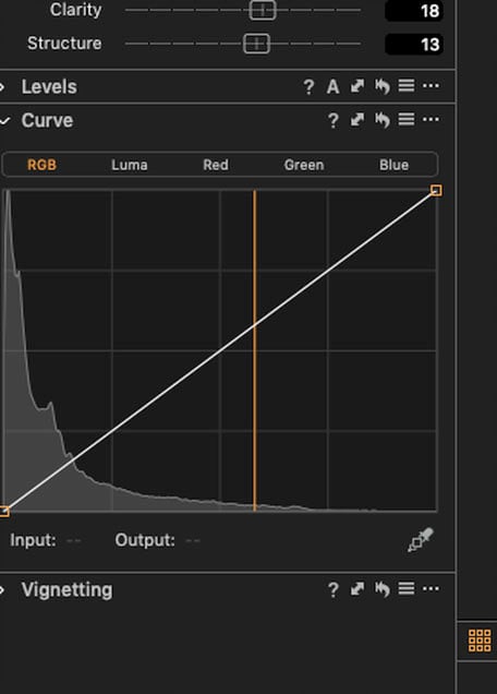

So you don’t have a monitor, or you didn’t feel like dragging it along with you, or the battery is dead or whatever. Is there a hack for this method? Yes, kind of. I should mention that this works in Capture One. I’ve never used Lightroom, so I have no idea whether there is any equivalent there.
Open the Curves tool in Capture One. If you mouse over the skin tones, you’ll notice that an orange line will appear in the Curves histogram that corresponds to the general level from 0-100.
It’s not precise, and I generally kind of “scrub” the cursor over the spot to get an average. Not great, but decent in a pinch.
