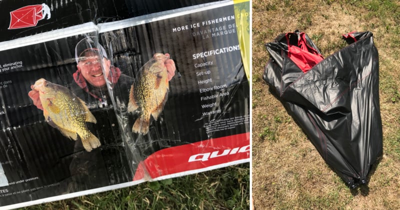

Using a portable Eskimo Quickfish tent, which he first tried at the Camera Obscura Festival, Hofstätter realized the tent would give him the exact space he needs for darkroom work both by himself and when working with others and would serve as an upgrade to his current solution.

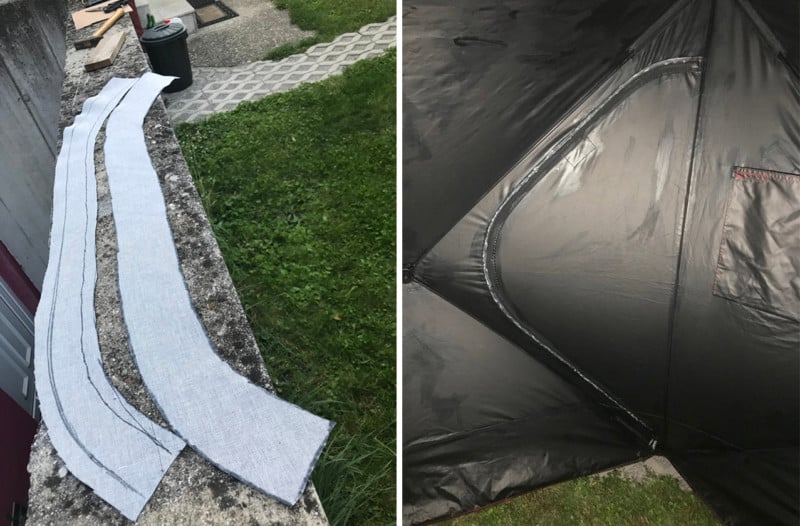

He purchased a refurbished Eskimo Quickfish tent and set out on a mission to find the best option to modify it for his darkroom needs, taking into account other photographers’ suggestions and advice. First, he used a black screenprinting paint mixed with a cold fixer and used it to paint all over any holes and seams inside the tent. The next step was to fix the existing zipper so it would not let any light in. Hofstätter solution involves a permanent cover for the zipper that is similar to the one found on a pair of jeans.
Designing a cover for the zipper
