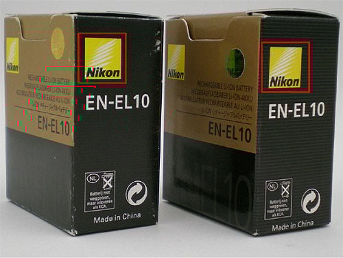

For the EN-EL10, Nikon also found slight differences in the white parts of the Nikon logo:
