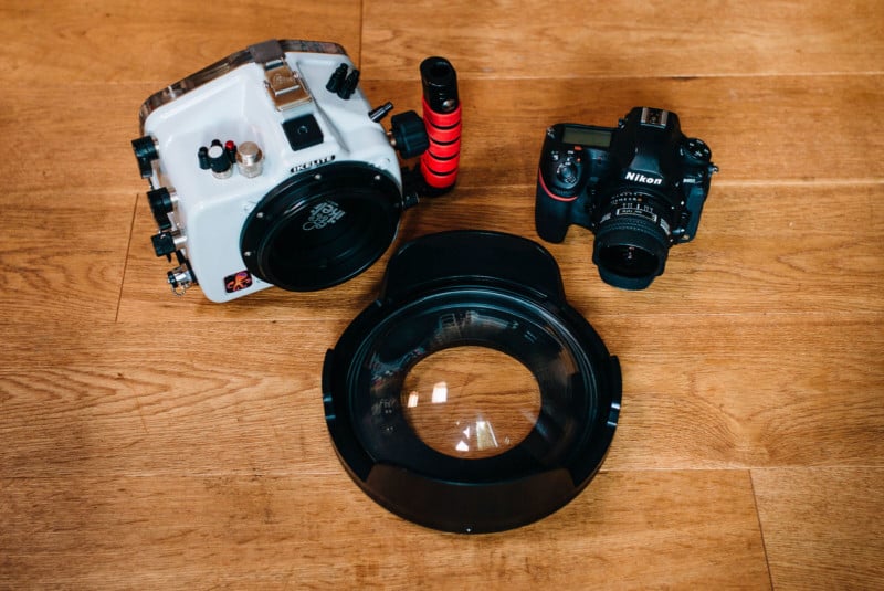

Finally, towards the end of 2017, we took the plunge and bought a proper underwater housing. We opted for an Ikelite housing – one of the cheapest options amongst professional underwater housings, although ‘cheap’ is very subjective in this context. The main reason why Ikelite housings are cheaper is due to the fact that they are made from plastic rather than aluminum and tend to be a bit more bulky, neither of which posed any issue for us.
Buying a ‘proper’ housing is quite a big commitment. They are expensive, often similar in price to the camera they are designed for and every camera model requires a different, dedicated housing. We have a couple of different cameras, but we decided to get a housing for our Nikon D850 as it’s the most future-proof.
To use a housing, you must also buy a lens port. These come in various sizes to accommodate different lenses and in two different types: flat port (used for macro), and dome port (used for wide angle). Water decreases the angle of view of the lens by approximately 25-30%, e.g. 24mm lens becomes roughly 30-35mm. Dome ports are used to reduce or remove this effect entirely. As we wanted to do over/under shots and photograph people underwater, we opted for a dome port.
Our full setup for the first shoot included the following:
1. Nikon D850
2. Nikon 16mm Fisheye lens
3. Ikelite housing with a tray and handle
4. Ikelite 8-inch dome port
As far as underwater rigs go, this was quite a simple setup. We decided to use just natural light to start with so we didn’t have to worry about underwater strobes and arms to mount them.
We used a fisheye lens, as it’s often recommended for wide-angle underwater photography due to the fact that it performs well with a dome port and has a huge depth of field (very helpful for under/over shots). Although it worked alright (after correcting distortions in Lightroom), it also forced us to put the subject in the center of the frame to avoid distortion. For our next shoot, we’re planning to use a 28mm rectilinear lens.
Using the dome port not only allows you to capture a much wider scene but it also makes under/over shots possible. The bigger the dome, the easier these photos are. In fact getting an under/over shot is relatively easy, getting one which is technically correct and interesting, is far more difficult.
