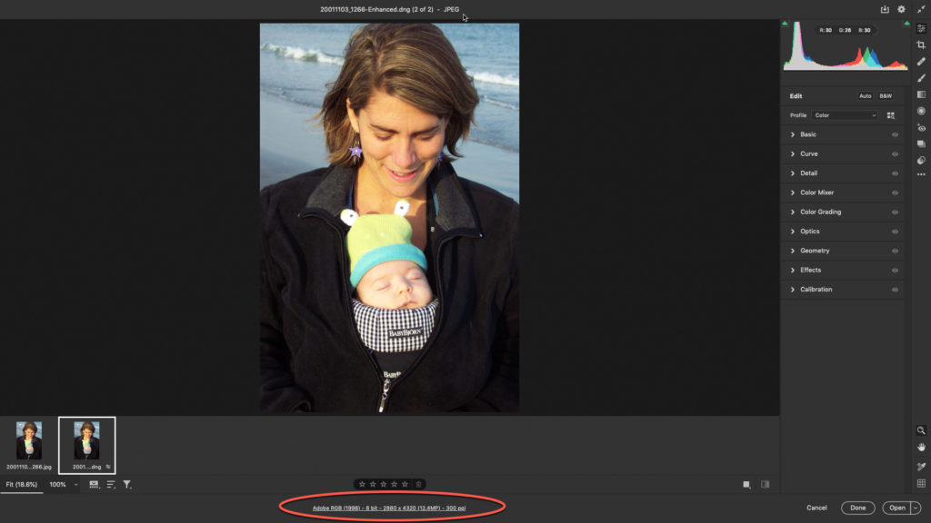

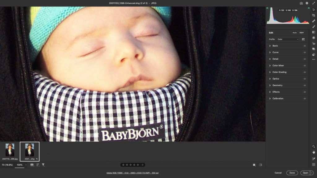

I first got into digital photography back in 2000 when I learned I was about to be a dad, and so I picked up one of these new digital cameras I’d been hearing about. It was a 3.1MP Kodak point and shoot camera that I absolutely loved. So, I went back to a favorite shot from soon after my son’s arrival, and threw it into ACR to see what would happen. Here’s the Fit View and 100% view of the new 12.4MP version of that photo.
Consider me super impressed!

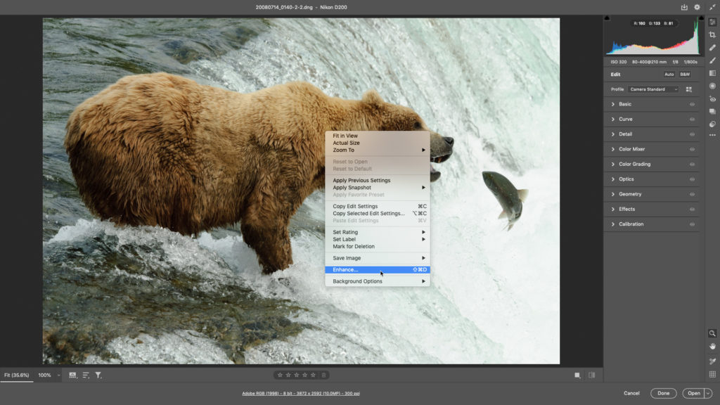

Step Four: In Camera Raw, right-click the photo and click the Enhance command in the contextual menu (and note the shortcut).

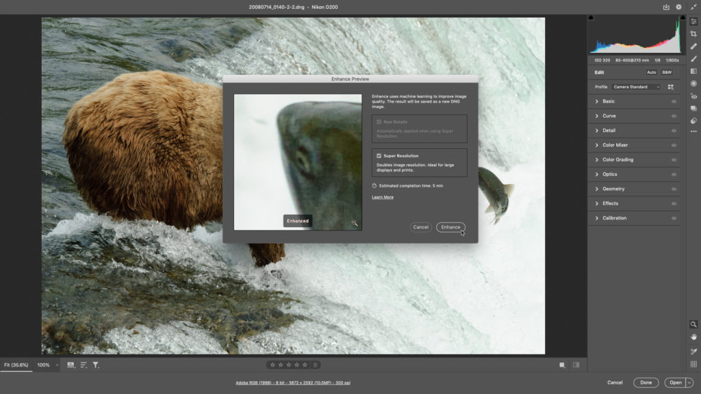

Step Five: This will open the Enhance Preview window where you can see a sneak peek of the results and, if you choose, the option to proceed to enlarge the photo by clicking Enhance. This is a resource intensive process, so be prepared for that. Especially if you are throwing already large files at it.

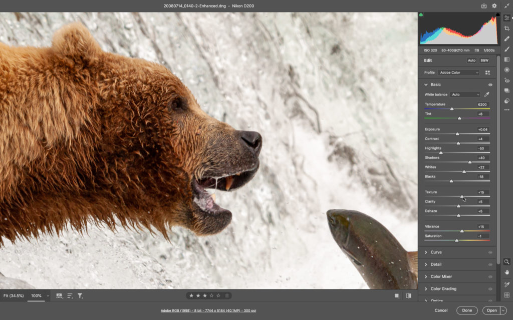

Once the process has run, you may not notice it if the Filmstrip is hidden, so click the Filmstrip icon (or press the / key to show it). The new version will have the word Enhanced appended to the end of the file name. Kick the tires and check it out while in ACR since you can even edit it like any DNG file, and then open a copy into Photoshop. Seeing my 10MP file transform into a 40MP file with pretty clear detail is impressive.
