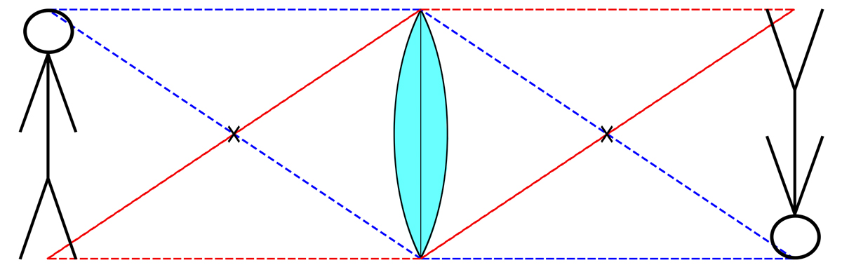

Because of their convex lens-like shape, certain subjects refocus the light that passes through them into a sharp projection of their background, just as like a lens would. This phenomenon makes for stunning photographs.
Pretty much anything transparent with solid spherical shape will function as a lens and show this effect.
Lenses and other transparent convex or spherical objects gather light rays from a spectrum of angles and refocus them into a sharp but vertically flipped image.

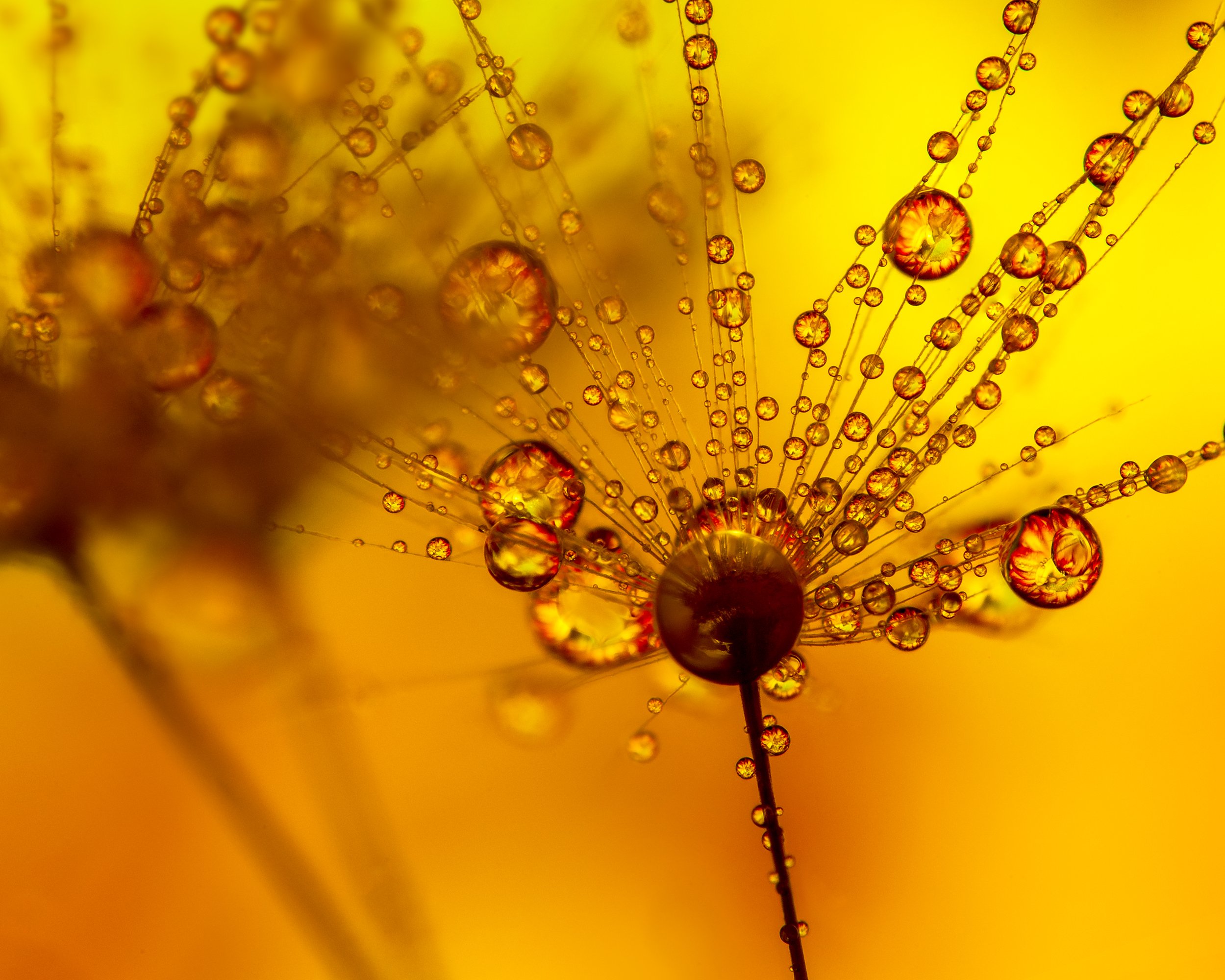

  • Water droplets: The naturally strong surface tension of water causes small droplets to take on a spherical shape whenever they can. Generally speaking, waxy or hairy leaves are better at holding perfectly round beads of water.
A good trick to add even more surface tension to your water beads is to mix in some glycerin, which can be found online and in most pharmacies. Mixing it with water will result in a liquid that will yield even better result than pure water.

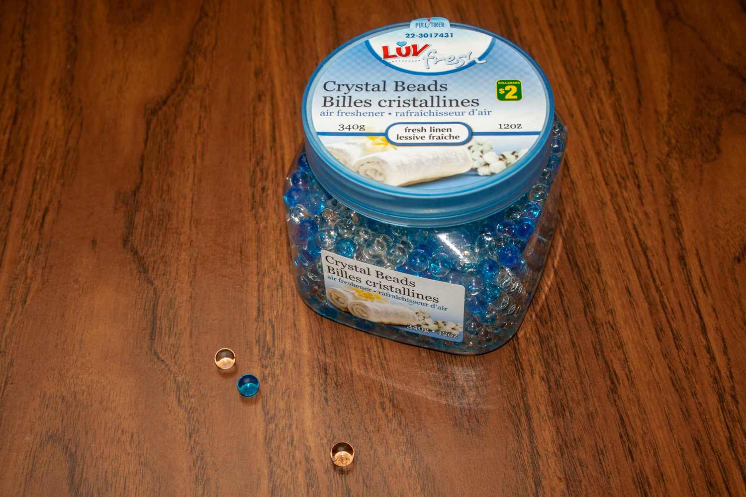

  • Gel beads: Water absorbent gel beads that are used in flower vases or air fresheners are round and transparent and therefore work too. (see sample photos below)

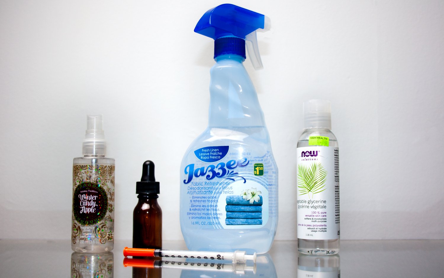

Items I typically use for my refraction photography: A couple of old spray bottles filled with water, an eye-dropper, glycerin and a syringe.

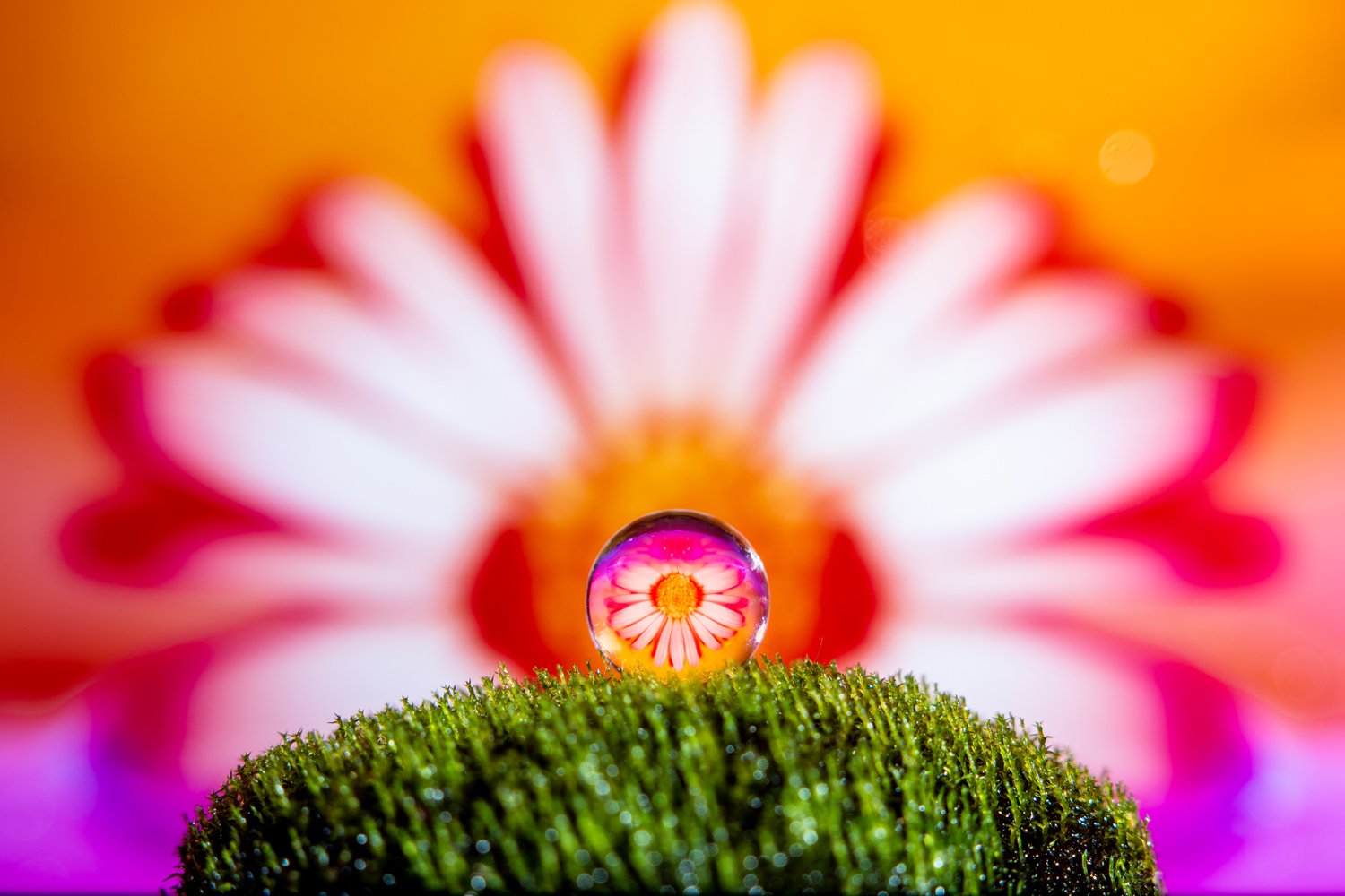

The image below was shot using a crystal bead from an air freshener. A patch of moss—which I usually keep in a humid plastic container—made for a wonderful stage, and a flower photograph in the background served as a warm and colorful background and as a point of interest inside the bead:

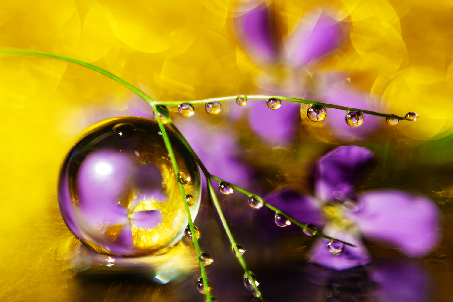

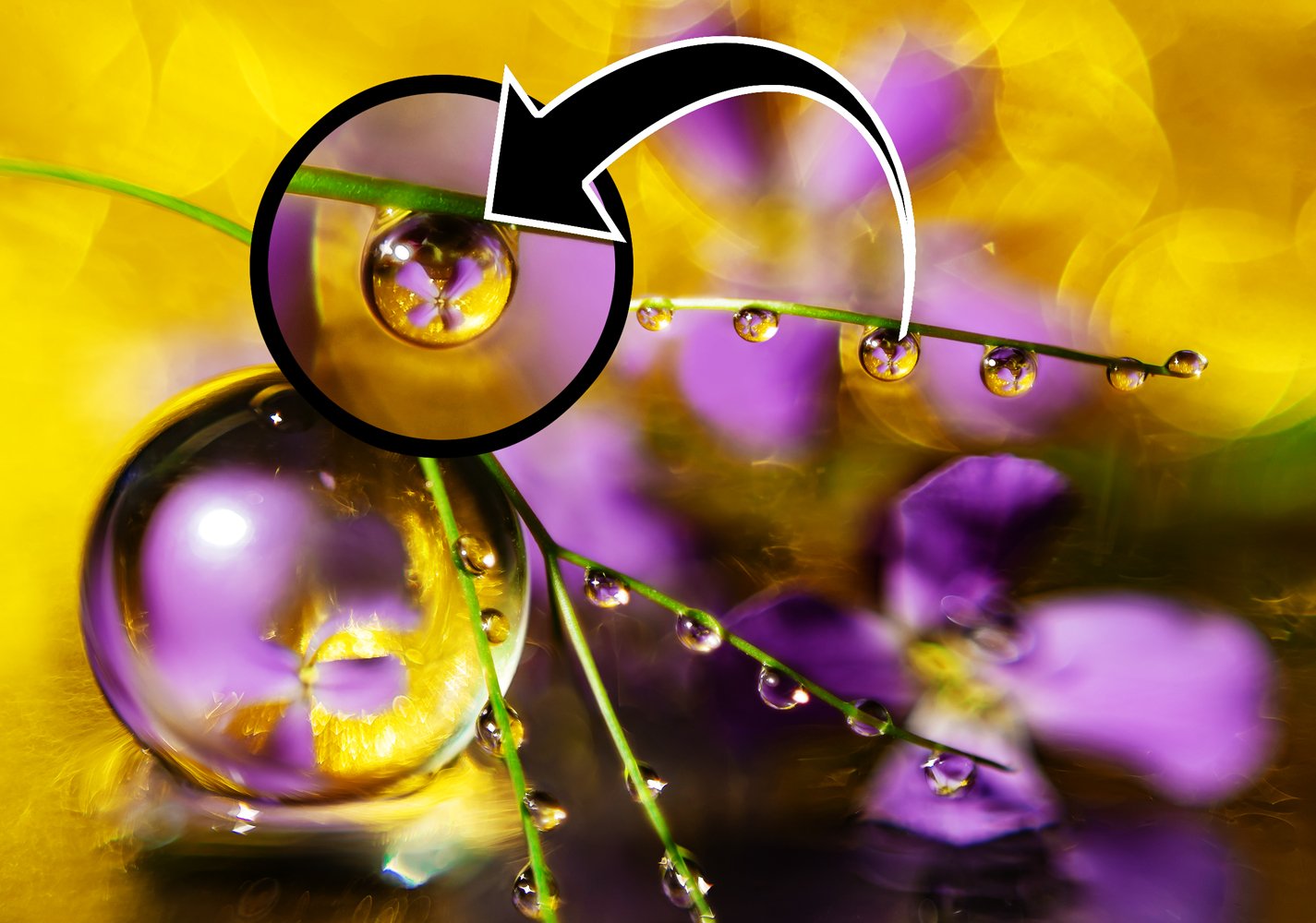

A lens ball serves the same purpose, but is quite a bit larger and easier to keep clean and use outdoors. For the photo below, I used golden glitter paper in the background and shot wide open at f/1.8 to get the bokeh I was after. Since refraction photos generally need to be stacked for best results anyway, I didn’t mind the shallow depth of field.

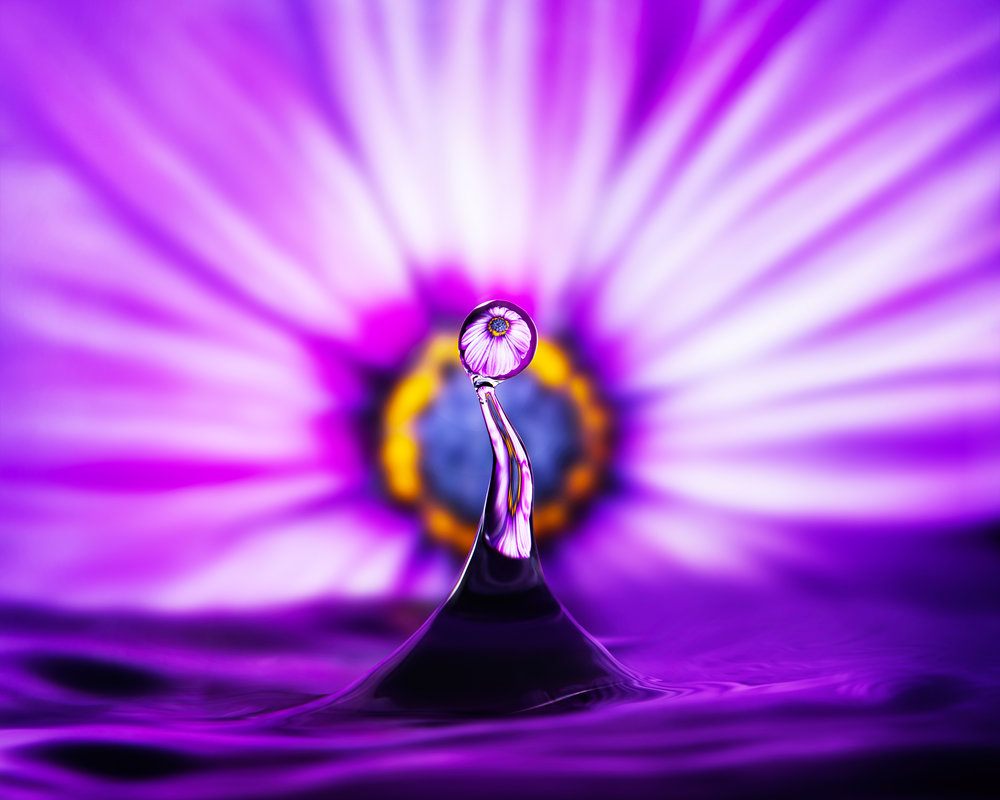

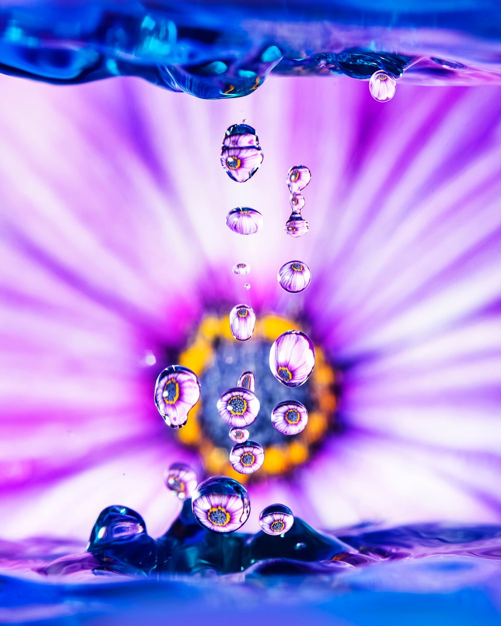

A glass with a water and an overhanging cloth inside it functions as a drip feeder. Place a small sauce trey (or something like it) underneath to catch the droplets and make them bounce out of the surface. You will also need a speedlight, ideally at a low power setting, to freeze motion and capture a crisp image.

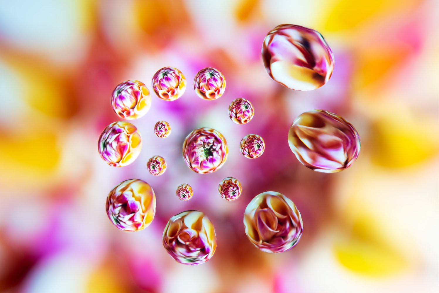

Of course, this isn’t the only way to take refraction photos using water drops. You can also place beads on a leaf, a flower, or dandelion seeds to create images like these:

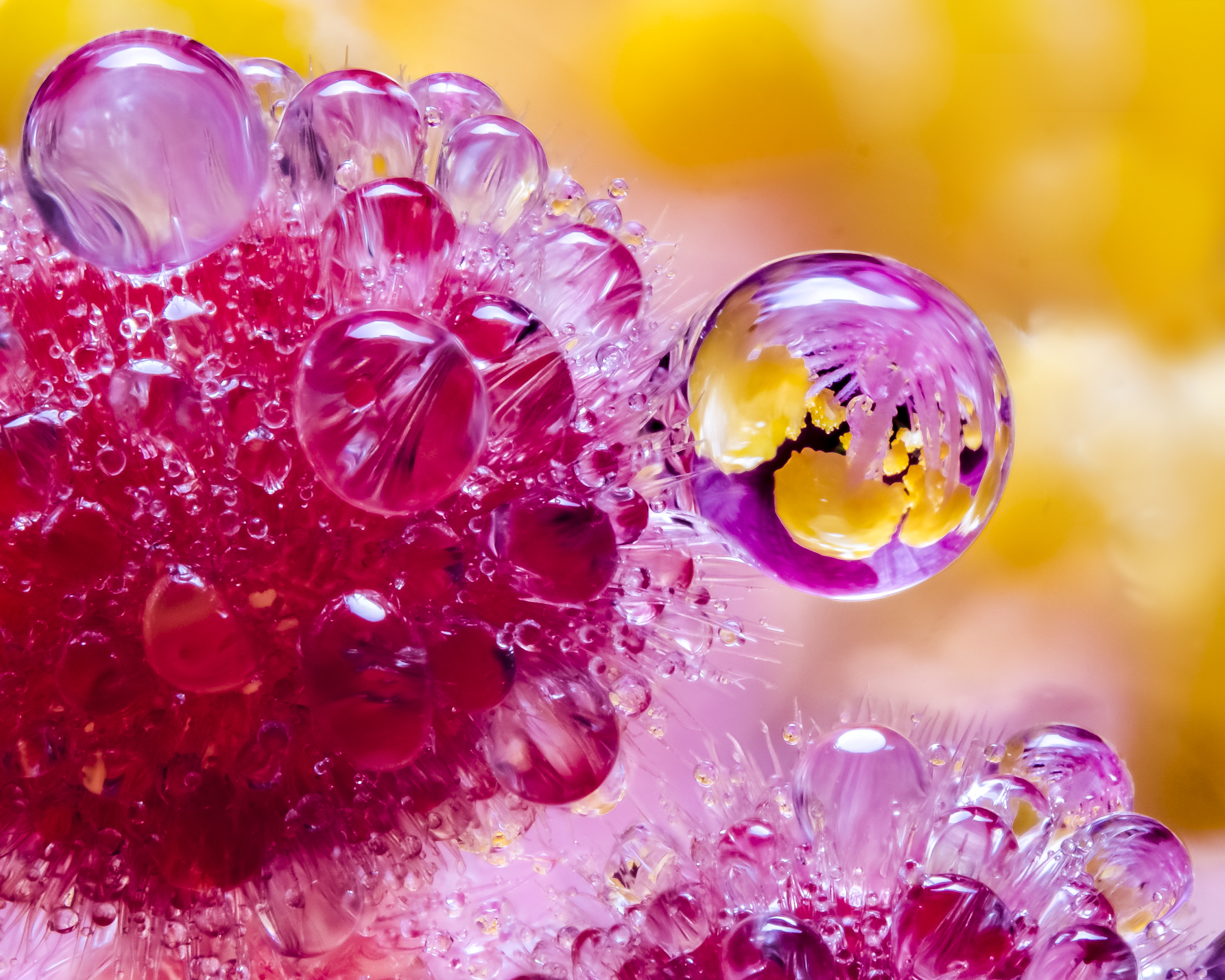

A misted Hibiscus stamen—refraction photography also works with extreme magnification ratios.

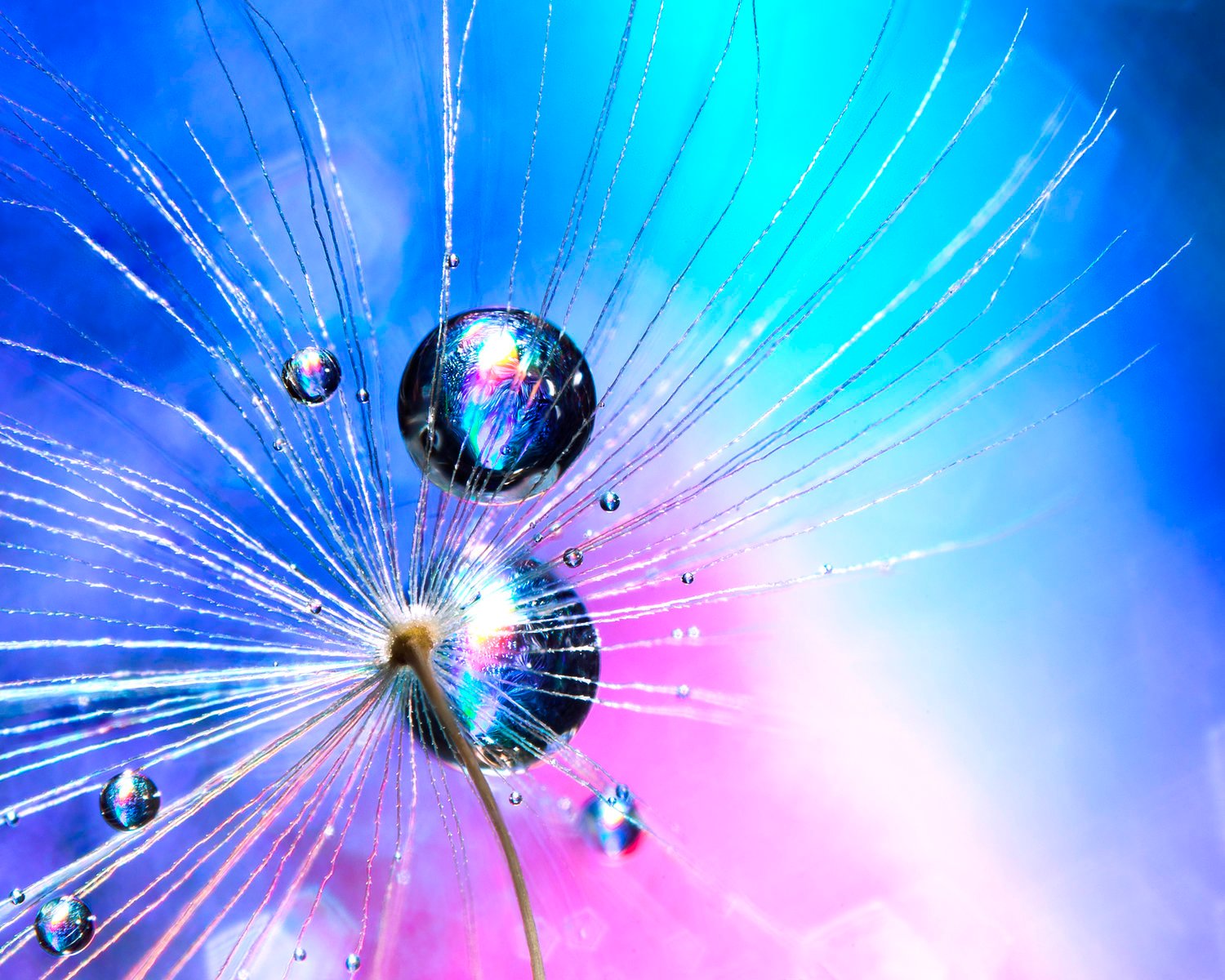

Dandelion seeds are another ideal subject that will hold perfectly spherical beads.

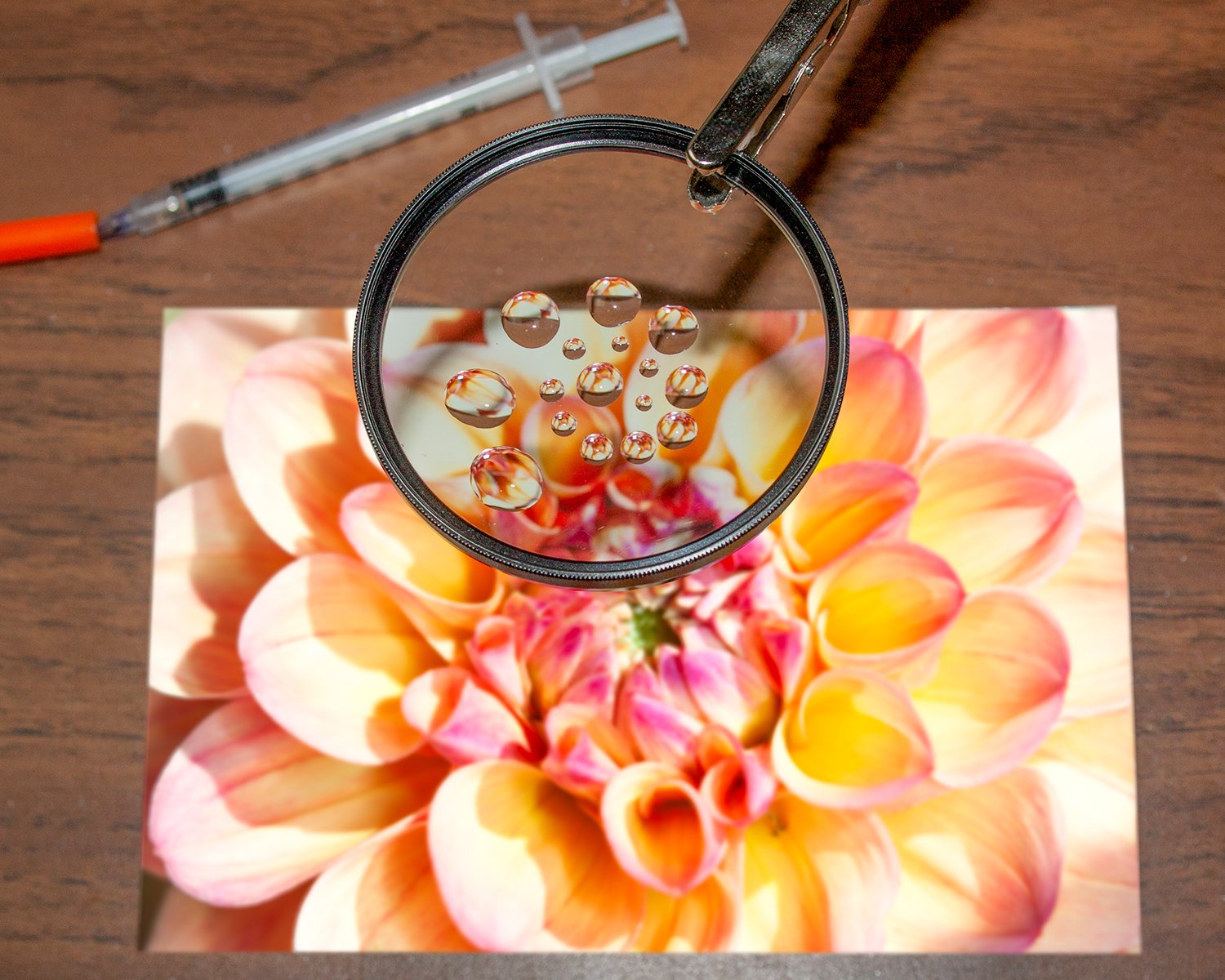

Or just use a piece of glass to place your droplets on, such as a UV-filter for example. Here’s a peek behind the scenes of another shot I captured:

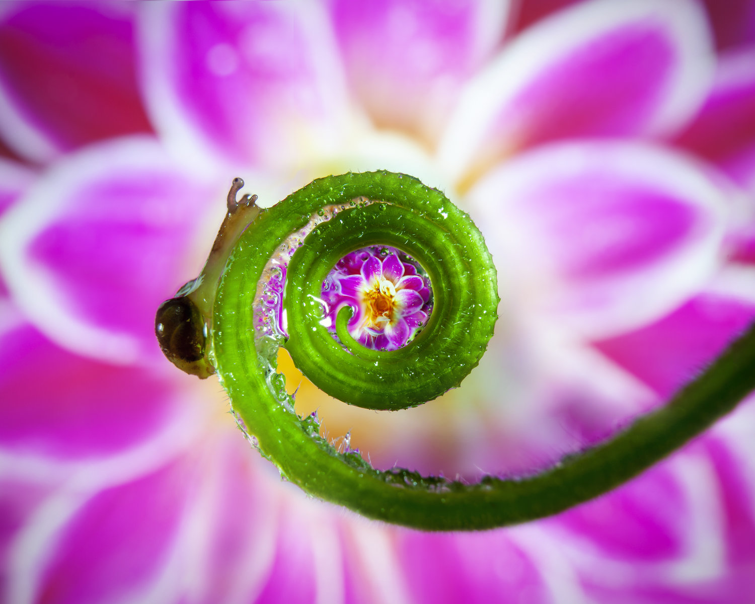

I used a feather that I dipped into water to create a thin layer of water in the center of a rolled up cucumber sprout. The forces of surface tension and gravity cause it to be thinner around the edges than in the centre, which made it ideal for another refraction photo.
