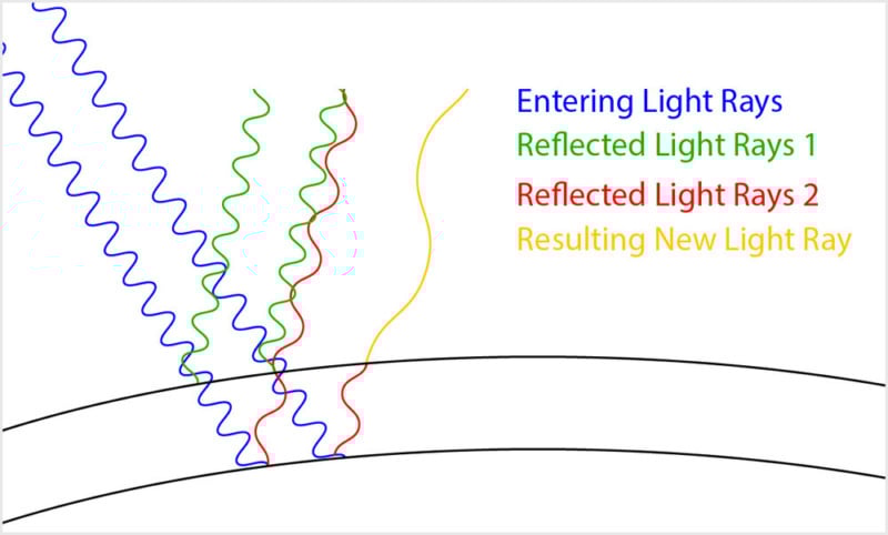

When we are looking at a film of soap, what we are really looking at are two films of soap, enclosing a thin film of water that’s only a few molecules thick. And it’s actually that layer of water that’s mainly responsible for the colour plays we get to see. This film of water has two sides, the outer and the inner side of the bubble.
Similar to a beam splitter (a half transparent mirror) the both sides are semi-transparent, meaning that they will reflect a certain portion of the light and let the rest of the rays pass. And exactly the same happens when these passing light rays hit the inner surface of the watery thin film.
This leaves us with 2 reflective surfaces, less than 1 micrometer apart from each other. As a result the reflected light rays will interfere with each other and change the reflected colour according to the local thickness of the film.
So what we are really looking at when we watch these colours run across the surface of a bubble, is the changing thickness of the film, turning white light (depicted as blue rays in the image above) into spectacles of colour.

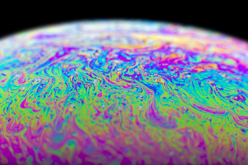

Next we’ll need to think about how we shoot the soap. There are two basic possibilities: We can film/photograph a soap bubble as a half-dome, or we can shoot a plain film of soap on some kind frame.
Filming just a single bubble puts all the focus on its perfectly spherical shape and the mesmerizing change of colours that pour down from its north-pole, until it eventually becomes totally transparent and pops:

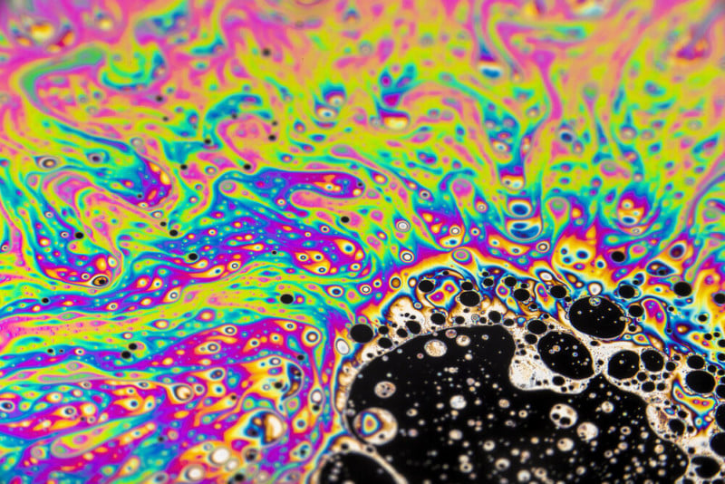

The patterns that a flat film will show depend on its orientation:
If the film is positioned vertically, gravity will cause the soap to slowly run downwards, creating horizontal gradients with an abundance of detail.
A film of soap on a DIY frame
Horizontal gradients pour down from top to bottom.

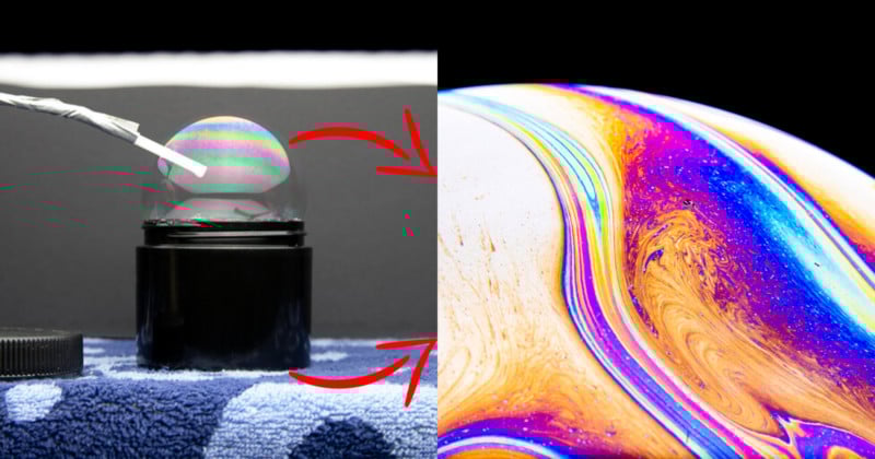

For the soap bubble sequences I positioned a round and black base filled with bubble solution on an end table with a softbox right above, only a couple inches away from it. There was basically just enough space left to fit in the bubble between the container and the light source.

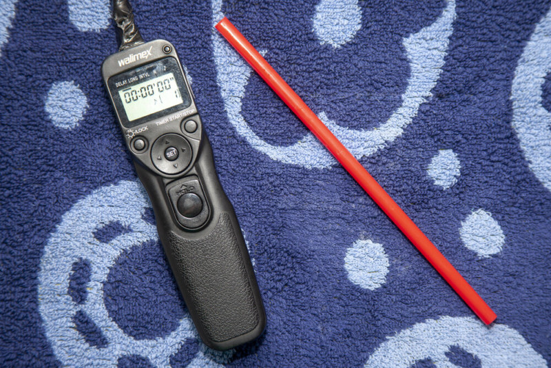

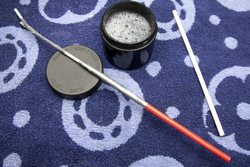

Best results are yielded with the light source centered above the bubble. This made it difficult to access the vase without moving it and shifting focus between bubbles. To work around the problem I manufactured an extra-long straw, using I lighter to veld the plastic and duct tape to stabilize the seam. This allows me to blow new bubbles without touching the set-up and film with a pre-focused lens.
I find it helpful to focus in live-view at maximum zoom. Even though I focus the lens before I start shooting, I always double-check at full zoom in life-view between bubbles.
An extended straw makes shooting easier.
All you need: A straw, a vase and some soap.

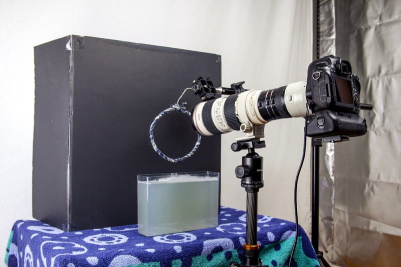

To capture the down-pouring gradients of colour I had to place the film vertically, so that the solution would flow downwards. This required a more original solution.

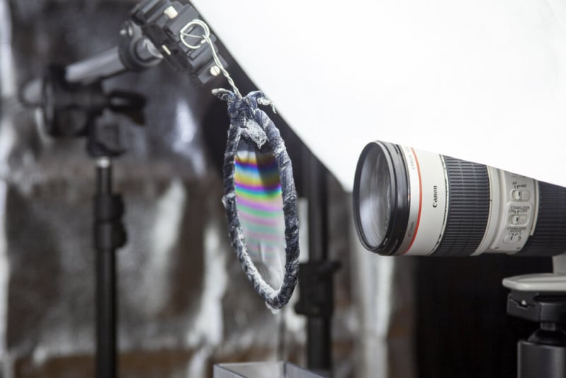

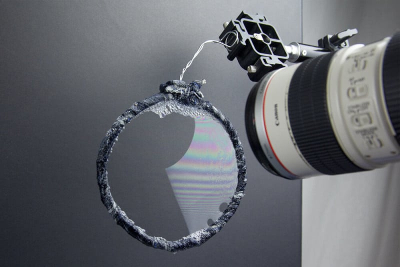

I crafted a round frame from craft wire, with a small loop on its base that fits into a hot-shoe. I wrapped it in cotton strips and mounted it on a boom-arm. Then I replaced the round vase with a tall rectangular one that was just big enough to submerse the entire frame in it:
I set up the frame right above the vase filled with bubble solution. To create a film I only have to lift up the vase and dip the frame in it. Once the camera is pre-focused, this process can be repeated as long as your soap lasts without or only very minor changes in focus.
In this case we need the light source next to, or above the camera, shining directly at the soap film.
Even though it would make perfect sense to have film and sensor plane in a parallel orientation, this would result in a reflection of the lens on the subject and so we will have to rotate the camera, just by a couple degrees or so, to cancel out this reflection. By my experience this isn’t too bad and still allows to keep almost the entire frame in focus.
