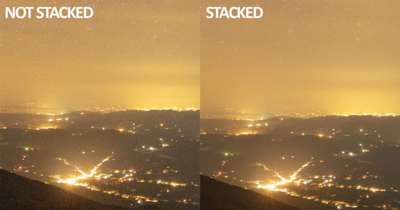

Take a look at this example of a 1:1 crop of what an image looks like before and after stacking:
The technique requires more work, but as you can see the results speak for themselves. Some phones even have sophisticated programming to compute this process for you. Stacking is becoming more common with computational photography today, but it has been around since the film days of astrophotography.

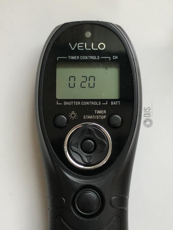

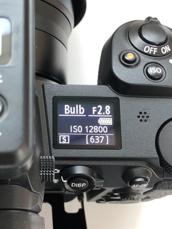

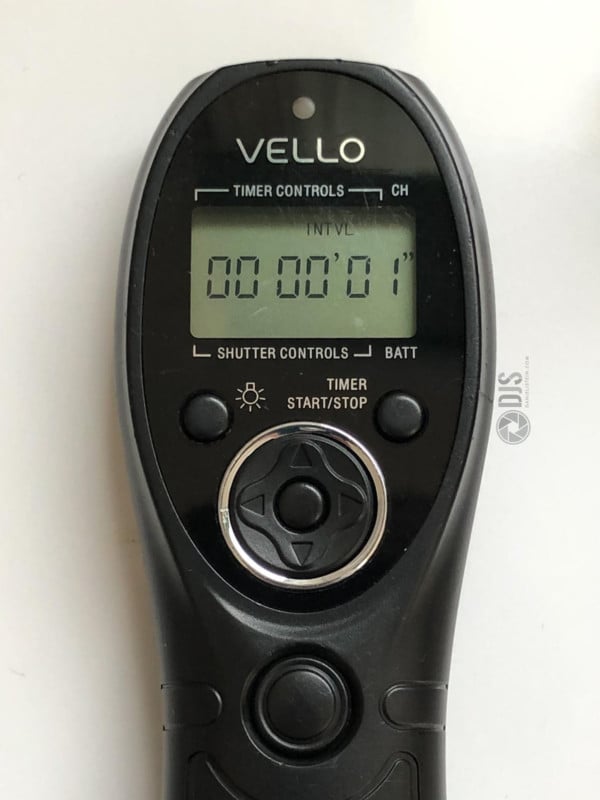

Method 1: External Remote
  1. Plug in your remote and set your camera to bulb mode. We want to give all shutter control to the remote.
    • Ensure long exposure noise reduction and self-timer are both off.
    • Dial in your other settings, such as ISO, aperture, white balance, and make sure your lens is in focus.

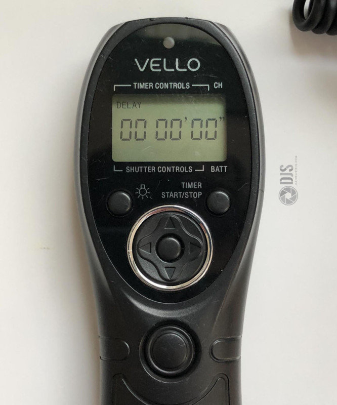

    • Head over to your remote and power it on. The first screen may indicate a delay. We do not need that for this so make sure everything shows a “0.”

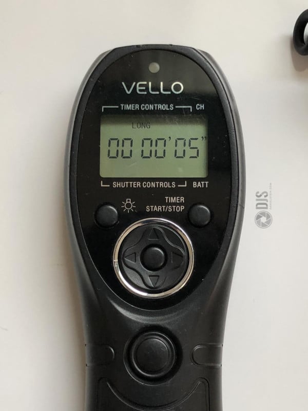

    • The next screen may show as “long” like my dog. He is long. This is your shutter speed. Dial it in according to the NPF rule.
    • The following is the interval. This is the duration between each shot. We want this as short as possible for easier processing. I set mine to “01” for 1 second.
    • The final screen is marked as “n.” This is the number of shots to do. I will do 20 for this round, giving me a total of 100 seconds of data. Eh, should probably do more.
    • Press start and sit back while the technology does the work for you.

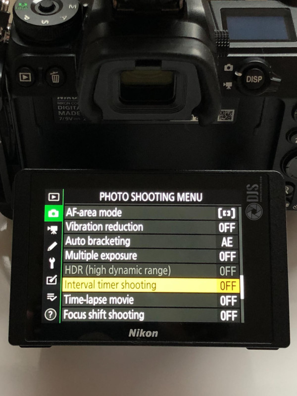

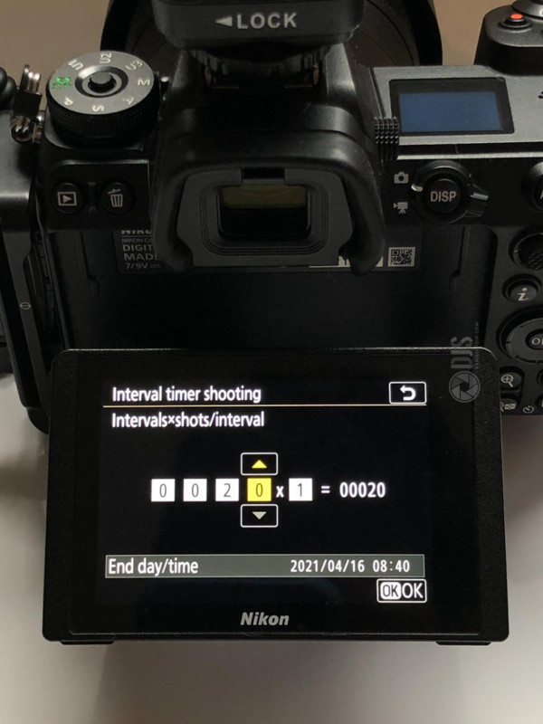

Method 2: Built-In

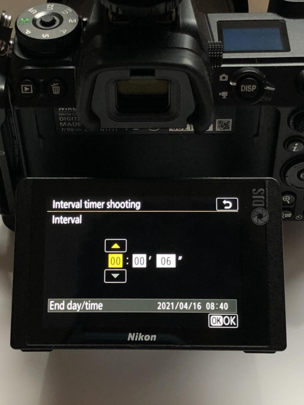

  1. Built-in intervalometers work a little differently to external. We want the camera to have full control here, so first step is to dial in your shutter speed.
  2. Ensure long exposure noise reduction and self-timer are both off.
  3. Then dial in all your other settings, again ensure you are in focus.

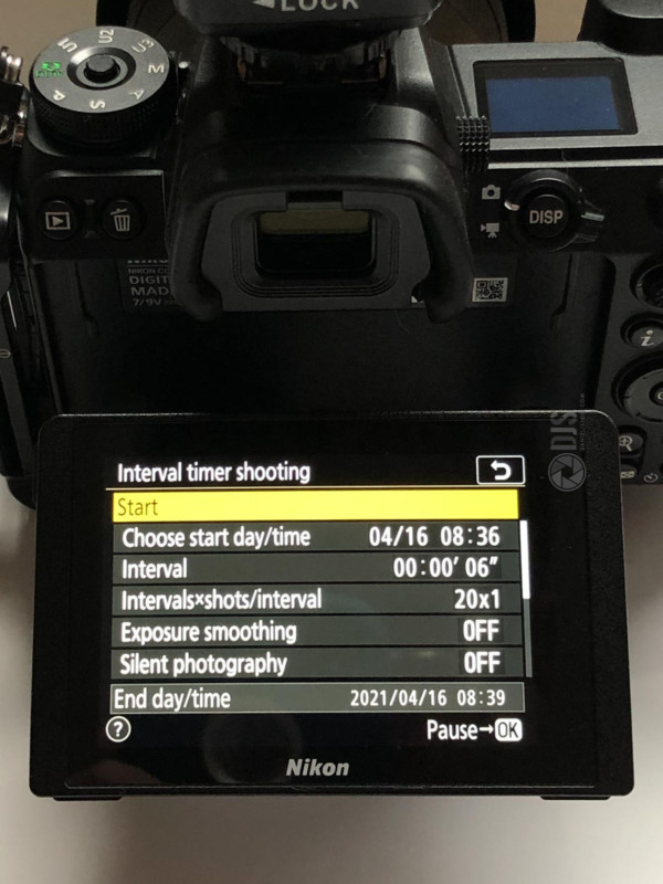

    • Navigate to where the interval timer function is in you camera.
    • Make sure the time is set to the time now if your camera has that option.
    • Programming the interval is a bit different here. Unlike with the remote where the shutter speed was separate from the time between each shot, here it is integrated and can be a little confusing. In other words, my shutter speed is 5 seconds, but I still want a 1-second interval between each shot. This means the total interval needs to be set to “6 seconds”
    • Set the number of shots to do, in my case again, 20.

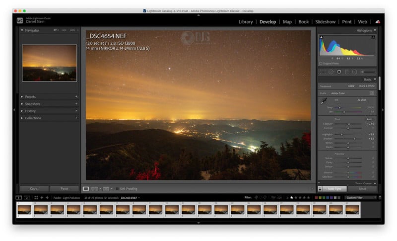

1. First, we need to catalog everything in Lightroom or another similar raw image processor. While SLS can read RAW files, it is often easier to make some minor adjustments in something like LR or CaptureOne prior to loading into SLS.
2. According to the SLS user guide, it is best to lower the contrast all the way, as well as turn off any sort of lens and vignette corrections. You also need to turn off noise reduction and sharpening. My take: Turn off sharpening and noise reduction, yes. But as far as contrast goes I find that sometimes dropping it down all the way and then trying to add it back in again later creates strange artifacts in the image. I would just leave this at 0. For lens corrections, your mileage may vary. Sometimes I get unwanted results with them on, sometimes with them off. You will need to experiment with this. I would first start with them off.
3. I would also lower your highlights a bit and bump up the shadows a bit. I would adjust the exposure here as well if your image is too bright or too dark. Do not add any sort of clarity/texture/saturation adjustments, however.
4. Select all your images and apply your adjustments.

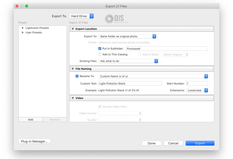

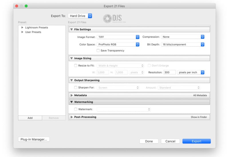

5. Export as 16 bit TIFFs in the ProphotoRGB color space. Do not resize your images!

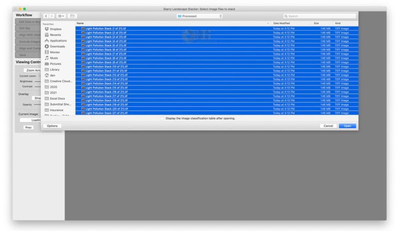

If I were you, I’d group my set of shots in a folder. This makes file management much easier to work with.

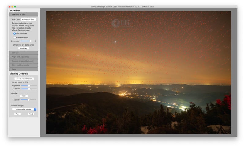

6. Once complete, open up StarryLandscapeStacker and it will automatically prompt you to import your images. Locate the folder you made in the previous step and let ’em rip.
7. SLS will automatically analyze your shots. If it detects any discrepancies, it will prompt you. It may ask you to select dark/light/flat frames. Don’t worry about these for now. Everything here is considered a “light” frame. I will talk about these other frames in a future tut.
8. Once complete, you will notice red dots all over your image.
Red dots are what SLS uses to determine where the sky is and isn’t. With that in mind, you need to erase red dots where they are present in the foreground. Do this by clicking “erase red dots” over on the left. Wild, I know.
9. The next thing that needs to be done in order for the software to work properly is some red dots actually need to be drawn back in following the horizon. Do so by clicking add red dots on the left. Draw your dots following your horizon line.
It doesn’t need to be perfect. What we are doing here is telling the software where the foreground stops and the sky begins. This will improve how it aligns and stacks your images.

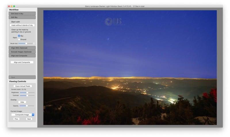

10. Now it is time to make the sky mask. Click the “Find Sky” button on the left and watch SLS do magic.
11. The mask will most likely not be clean right out of the box, so it needs to be cleaned up. At this point, we need to use the blue paint to make sure the entire sky is covered. Likewise, the ground needs to be completely blue-free. Eiffel 65 would not be proud of the ground. The sky on the other hand…
12. If you are familiar with Photoshop, the brush works similarly to the one found in there. You can use the brackets to increase or decrease the brush size. You can also increase or decrease the opacity of the blue overlay if that helps you clean up the mask.
13. In the end, only the sky should be blue.
Try your best to clean up the horizon. It doesn’t need to be perfect (unlike my dog, who is perfect), there just needs to be absolutely no blue in the foreground. If you are not sure if you missed a spot, crank up the opacity of the blue. Missed a spot.

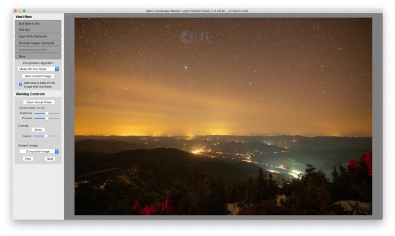

14. Once the mask is ready to rave, mash that “Align and Composite” button on the left and let the show begin.
15. At this point, SLS has used the mask to create two different photos which have been seamlessly blended together. The first is the sky photo, which has been aligned using the stars in each photo. Since the stars move relative to the Earth’s rotation, they need to be aligned.
16. The second image is the foreground which does not move. There is no need to align these images. Doing so relative to the star layer would actually cause it to be blurred. Thus, it is stacked separately.
17. There is a lot going on in the background of this software. In my opinion, I feel like it is crazy how quick and effective it is. 2021 man. (altho pretty sure this joint came out in 2014)

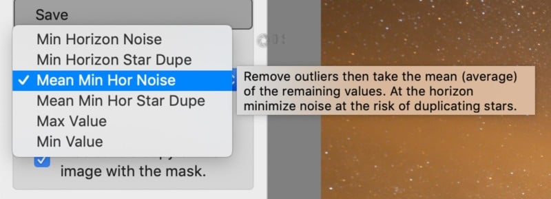

18. At this point, the software presents several algorithms you can choose from over on the left.
If you hover over them, you will find a brief explanation of what they do. Play around with these and see which algorithm fits your image best.
My take: I have had the best results with “Mean Min Horizon Noise,” and “Mean Min Horizon Star Dupe.” Again play around with these, your mileage may vary.
19. Use the “Z” key to zoom in 100% while messing with these. This can help determine which one works best.

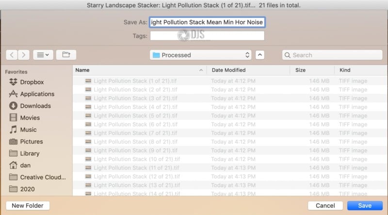

20. Once complete, press “Save the Current image.” You can also save the mask you created with the blue paint. This can be helpful if you are masking in a different foreground image — for example, if you took a blue hour foreground shot.
21. Images will be saved as a 16-bit TIFF. Once you are done, continue with your edits by importing in an image editor of your choice.
