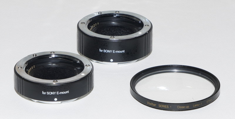

Camera lens extension tubes and a diopter lens
16mm and 21mm extension tubes (left) and a diopter lens (right).
Diopter lenses work with manual focus but don’t autofocus well. I need autofocus for fast-moving bees.
Extension tubes allow autofocus and, after moderate sharpening, deliver sharpness which rivals macro lenses. I shoot mostly at f/11 with both the macro and extended telephoto lenses.

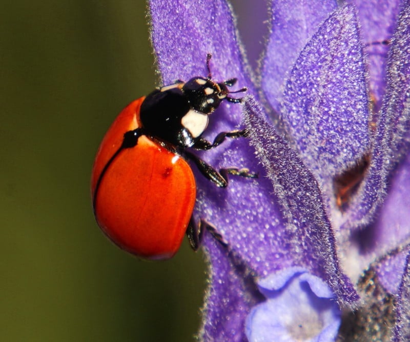

A ladybug on a flower
Shot with a Tamron 28-200mm.

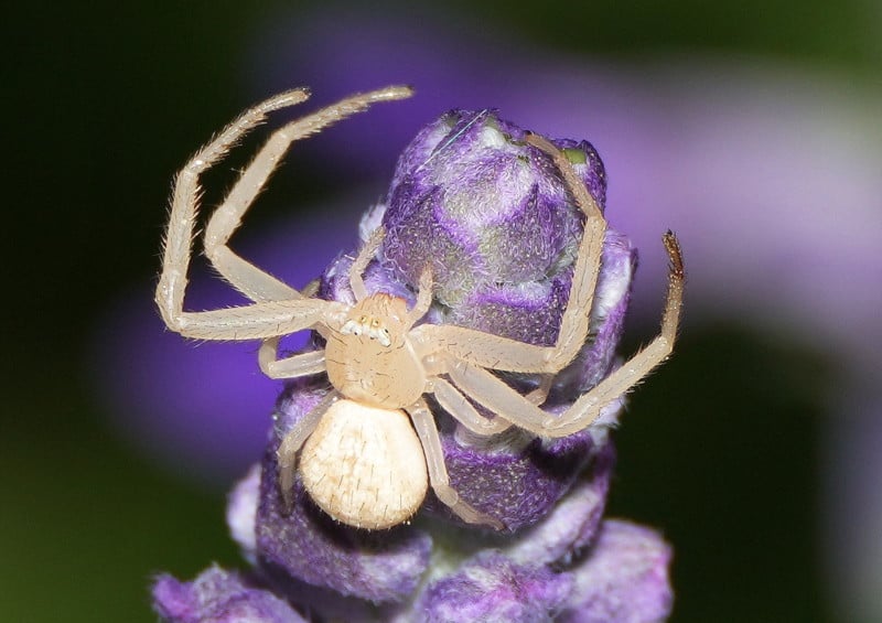

A macro photo of a spider on a flower
Shot with a Tamron 70-300mm.

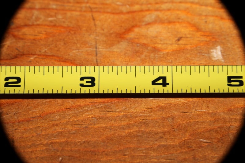

Determining Your Maximum Magnification
You can measure your maximum magnification by photographing a ruler at the shortest distance that will focus.
A close-up photo of a tape measure on a wooden surface
This was shot with my Tamron 28-200mm at 200mm on a 16mm extension tube. The capture is 3.3″ wide which calculates to 0.4x magnification. The vignetting is due to the extension tube, but it never concerns me because I only keep a small portion from the center of the frame.
Then calculate magnification as follows:
Magnification = Sensor width / Captured ruler width
Sensor widths are approximately:
Full frame: 36mm or 1.4″
APS-C: 24mm or 0.95″
Micro Four Thirds: 17mm or 0.7″
