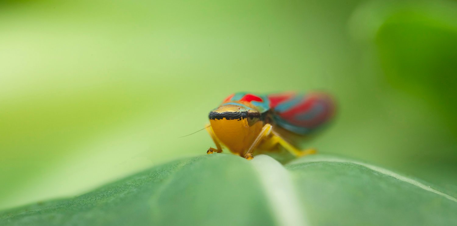

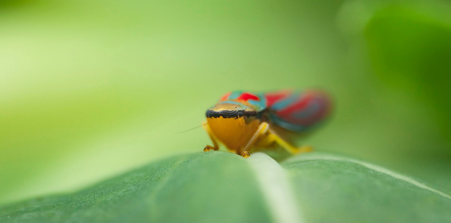

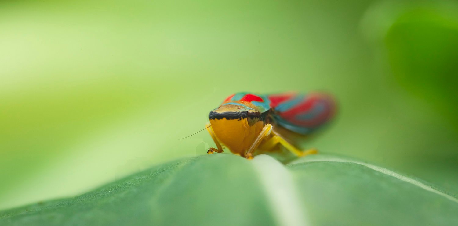

Have a look at the following set of images: the stack was shot handheld. Although it shows some minor shifts in perspective, you wouldn’t know by the final image. The first image in the sequence is the stacked result, followed by the single photos of the stack.
Of course, it’s ambitious to compete with an actual focusing rail, but with a bit of practice and the right technique, creating a good handheld focus stack becomes a simple task that works well, even at extreme magnification ratios.

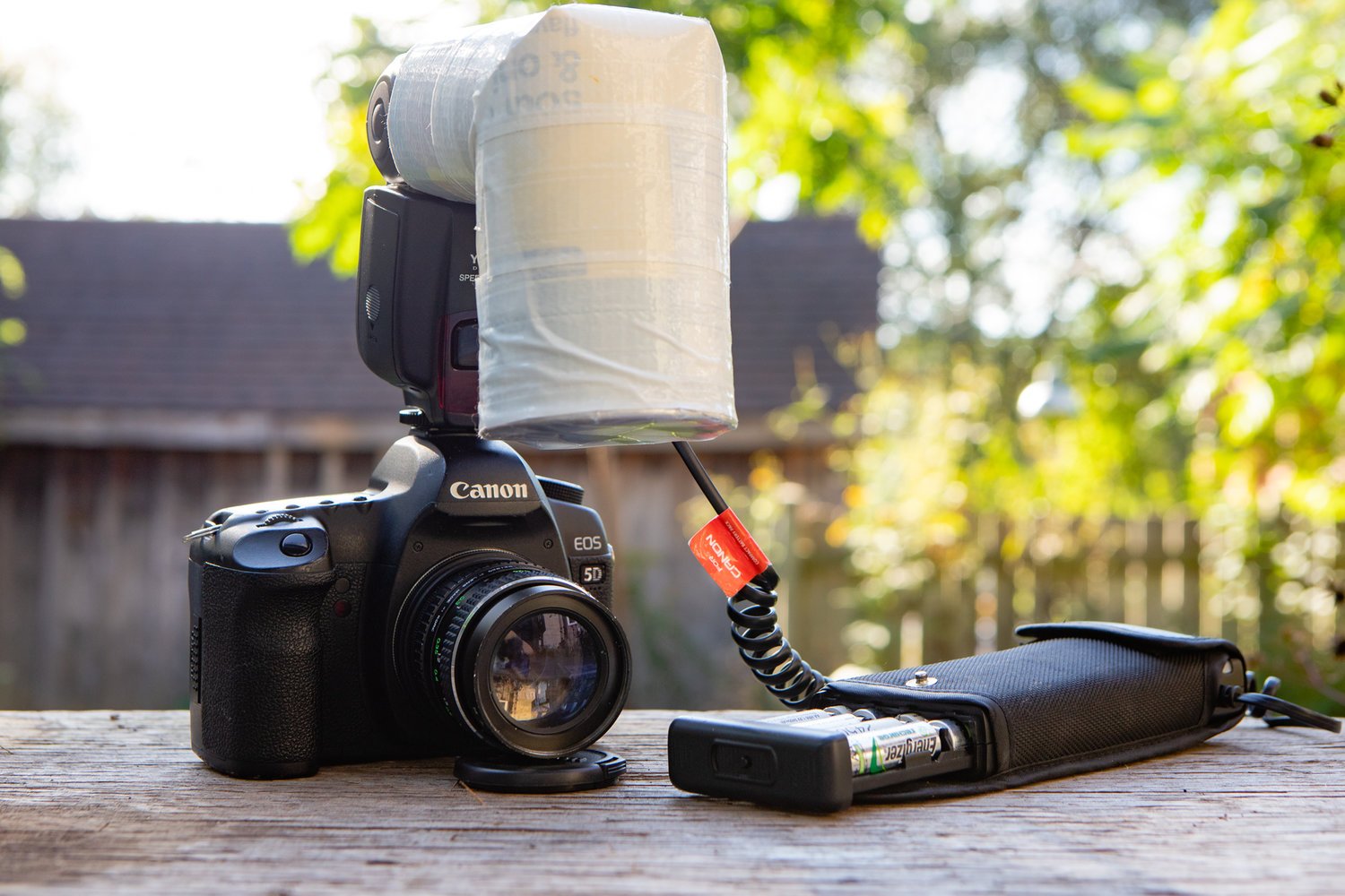

The typical setup I use for stacking in the field is camera in high-speed continuous mode and an on-camera speedlight with a slim modifier.
The flash ensures proper lighting and helps to eliminate motion blur. All ambient light should be cancelled out as we will move the camera back and forth, so take a test shot without flash and make sure it is black. Ideally, the flash power should be set to 1/16th or lower to keep its recharging time short—an external battery pack that holds eight additional batteries helps with this. The camera should be set to the sync-speed of your camera, typically 1/200th or 1/250th of a second.

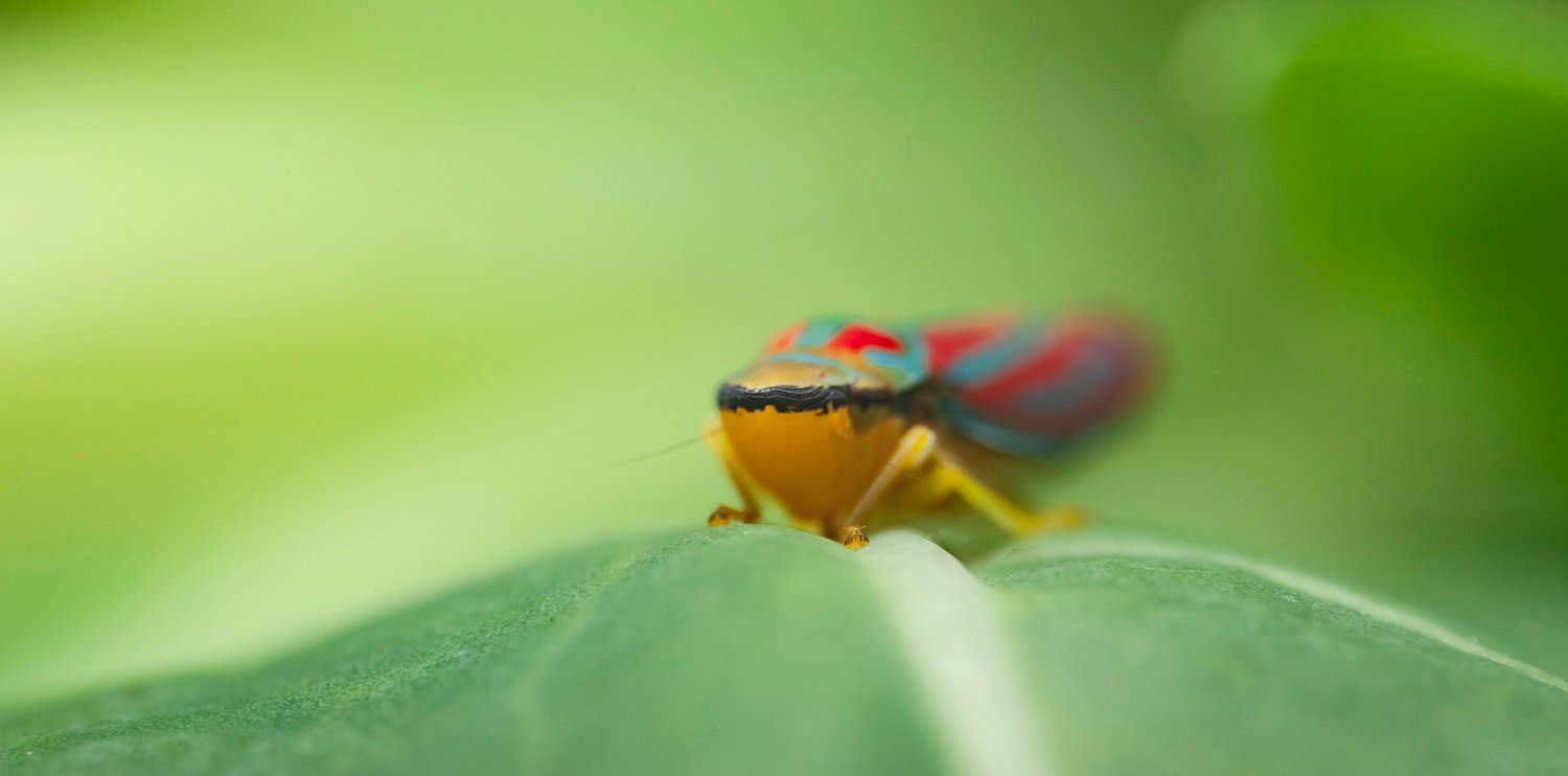

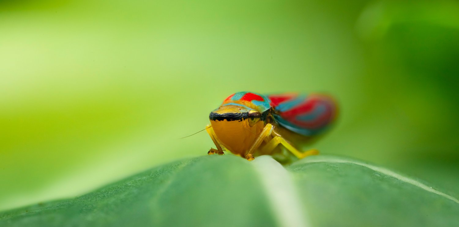

Single frame
Stacked from two images

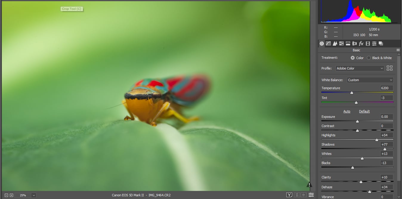

Before you start the actual stacking, I recommend that you develop your RAW files in Camera Raw and save them as JPEGs. This way you are sure to get the best image quality and it will speed up the process.

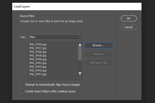

Load Files into Stack
In the next step, we are going to load all the files of our stack as layers into one new document. To do so, go into the “File” tab in Photoshop and select “Scripts” → “Load Files into Stack…”
Unless you have a completely black or blurry background, leave both boxes in the dialogue window unchecked. Sometimes Photoshop gets confused by structures in the background and gets the alignment wrong.

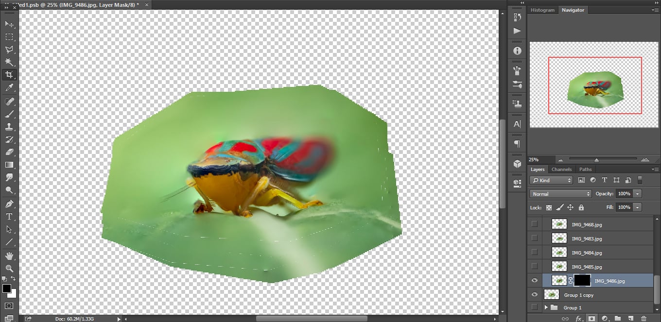

Before we use PhotoShop to align our layers for us, we’re going to make sure that the background won’t confuse the software.

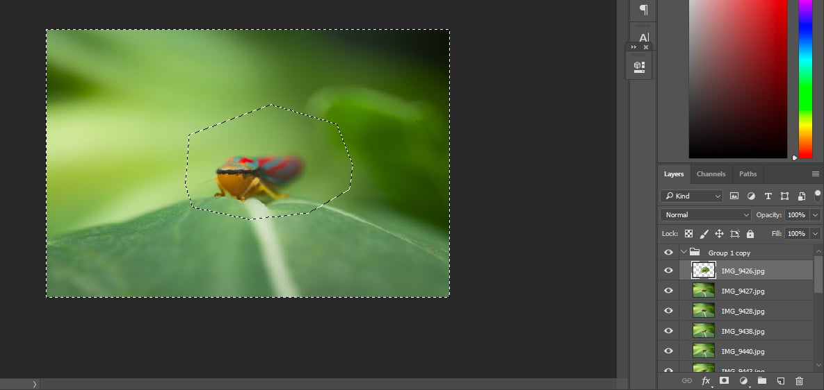

Create a rough selection around your subject, and make sure that it contains the whole subject in all of your layers. Then invert the selection (“Ctrl”+”Shift”+”I”) and delete it in all layers of the group.
Once finished you should have two groups: the original “Group 1” on the bottom and its duplicate “Group 1 Copy” with the isolated subject up top.

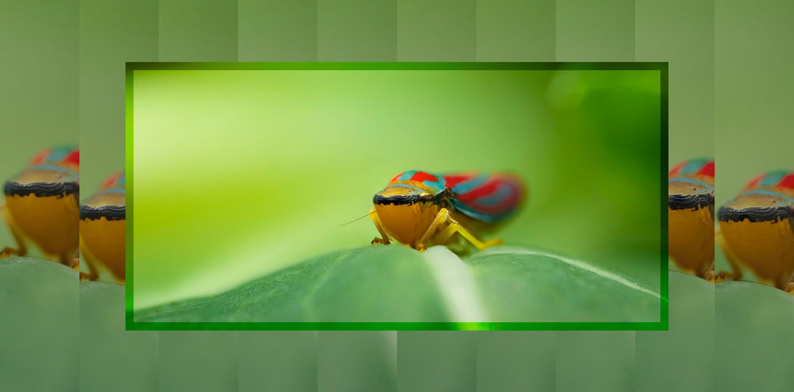

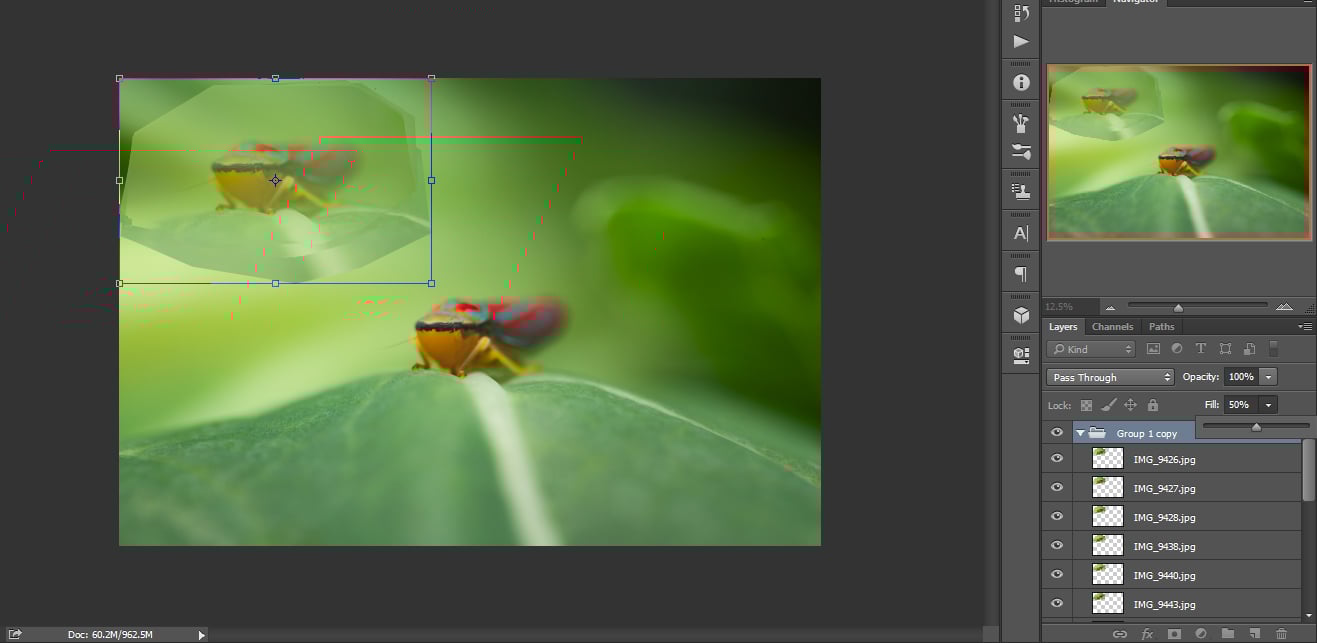

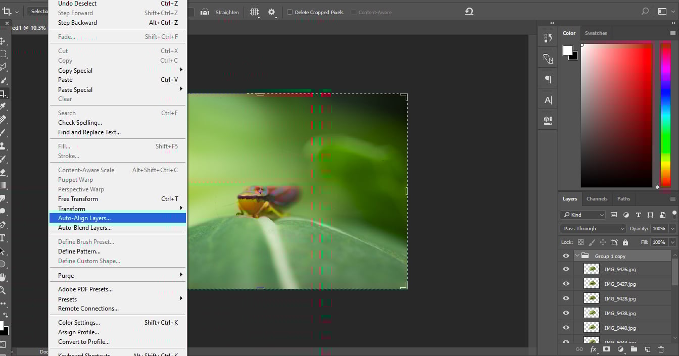

Select the group that we just worked on and go into the “Edit” menu. Select Auto-Align Layers and choose the Auto-mode in the following dialogue window.
Photoshop is going to move the freshly aligned layers into the top left corner of your document. To move them back, select the whole group and press “Ctrl”+”T”. Then turn down the layer opacity to 50% and move the group back where it came from.
Turn the opacity up again and look through all layers to ensure they are aligned well enough. Some slight shifts are acceptable, but the cleaner your stack, the easier the next step will be.

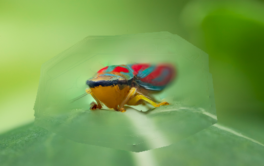

Duplicate the group once again. Then deactivate the new copy and select the group named “Group 1 copy,” go into the “Edit” menu and click “Auto-Blend Layers…” In the following dialogue window, select “Stack” and make sure “Seamless Tones and Colors” is checked.
Once Photoshop is done, merge the group into one layer and zoom in to inspect the result. There is a good chance that the Photoshop got some things wrong, and they’re not always obvious, so be thorough. If everything looks good, you can skip the next step; if there are glitches or artifacts, we will need to touch them up manually.
In my case Photoshop did alright. There are a few glitches, but nothing that we can’t fix.

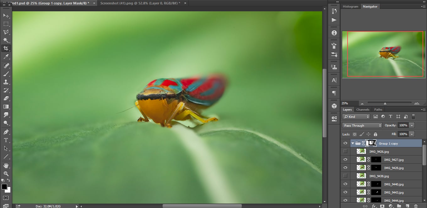

Now it’s time to touch up the image. To do so, we will paint in bits and pieces from our back-up group by using layer masks.
Select “Group 1 copy 2” and deactivate all layers in it except for the very bottom layer. Add a black layer-mask to this layer by holding the “alt”-key while clicking on the layer mask symbol.
Use “Ctrl”+”I” to switch between a black and white layer-mask and determine the parts of the layer that should be in the final image. Then set the layer mask back to black and use a the eraser tool at about 50% hardness to paint in the missing pieces. Move on to the next layer and repeat the process until you’re satisfied with the result.
Once you are done with this, all that’s left to do is to get rid of the hard edges around your subject. To blend it in, create a white layer-mask for the entire group and paint over its edges with a soft black paint brush.

Before exporting the image, I typically delete unwanted layers, such as “Group 1” in this case. Then I duplicate all layers and merge them into one layer that I convert into a smart object. Lastly, I will finish the image off by applying the Camera Raw filter in Photoshop and performing some slight adjustments.
