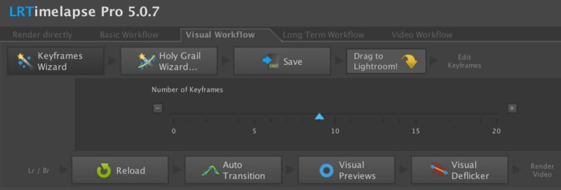

  4. Open LRTimelapse 5 and navigate to the folder you’ll be processing.
    • Make sure you’re in the Holy Grail workflow tab and follow the step by step process at the top right of the window.
    • Click Keyframes Wizard. Use the slider to enable a number of blue keyframes. How many you need depends on the number of photos, you can get away with only a few. I used 9 on this sequence.

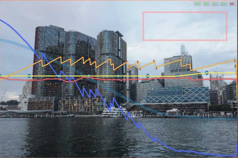

    • Click Holy Grail Wizard. Use the Rotate and Stretch slider to get the start and end of the orange curve as close to the yellow line as possible. You will see the changes happen in the viewer window on the left.

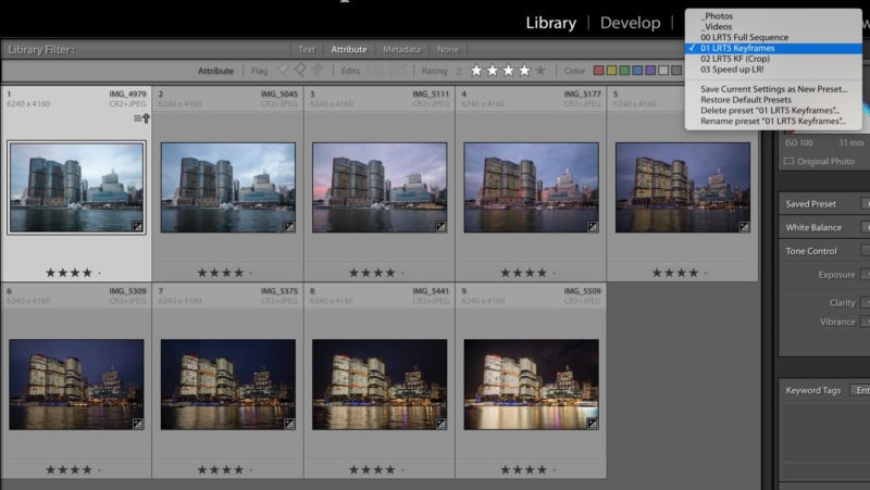

    • Hit Save and open Lightroom. Select all photos and hit Metadata > Read metadata in the top menu. This will read the data that LRTimelapse just added to the sequence. You will notice some photos getting a star rating added to them.
    • On the top right of the Library, select the sorting button next to the padlock and select ‘01 LRT5 Keyframes‘. This will show you the photos that you gave the blue keyframes to, reflected as 4-star ratings.
    • Open up the first photo and edit it as you please. Don’t touch the clarity slider too much as this affects every photo differently and might introduce hard to remove flickering.
    • Return to the selection of photos, select all photos with the one you just edited as the highlight and hit the little script icon at the top of your screen. Click ‘01 LRTimelapse sync keyframes‘. This will add the edit data from the first photo to the rest of the images. Don’t just copy and paste the metadata.
    • Select the second photo and develop it as you please. Usually you just adjust exposure and white balance. If you’d like to add a gradient to the image make sure to only use the ones that are automatically added to the image by LRTimelapse, don’t add any gradient edits yourself!
    • Return to the selection of photos, select the photo you just edited as well as the remaining ones and hit the script icon again followed by ’01 LRTimelapse sync keyframes’.
    • Repeat this process until all photos are edited. Select all the edited photos and hit Metadata > Save metadata. Return to LRTimelapse.
    • Hit the Reload button on the second row, followed by Auto Transition. This will calculate how to edit the photos in between the ones you edited to make sure every setting gets adjusted or ramped smoothly.
    • Select the first photo at the top of the column and drag a square in the viewer window in an area where nothing is supposed to flicker. The sky usually works best for this. LRTimelapse will use this selected area to deduce how to deflicker the sequence.
    • Hit the Visual Previews button and let it run. Once it’s done generating preview files hit the play button and review the sequence. This is where you can go back to Lightroom and adjust your 4-star images and repeat some of this process to get the desired look. You’re better off with this preview than letting it export the full resolution file over a few hours only to discover that you want it to look slightly different.
    • Once happy with the Visual Preview hit Visual Deflicker. This will add a darker orange curve to the viewer window which is a visual representation of the deflickering it will apply, based on the rectangle in your image. Let this run and generate the complete preview, then review it by hitting the play button. You can refine part of or the entire sequence using the custom settings and run it again. You’ll be surprised at how amazing this step is and how much it can fix.
