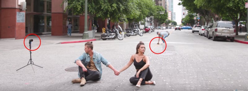

And this is when my handy dandy tripod comes into play. You can clearly still see my main light on a stand in the left corner of the frame. This serves as my main shot with my subjects lit the way I want them to look in the final photo. I then asked my assistant to remove both lights and asked my couple to step out of the frame to get my plate shot. Once we drop these into Lightroom, we process both images the same way, open them in Photoshop, align the layers and place a Mask over one of the images and paint out the light stand. Working on a tripod, this process literally takes 5 seconds as you’ll see in the video tutorial.
