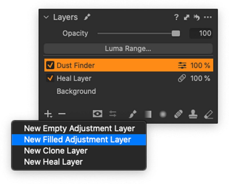

Step 2: Create a New Filled Adjustment Layer
This layer we will use as the dust spots finder.
A screenshot showing how to create a new filled adjustment layer in Capture One

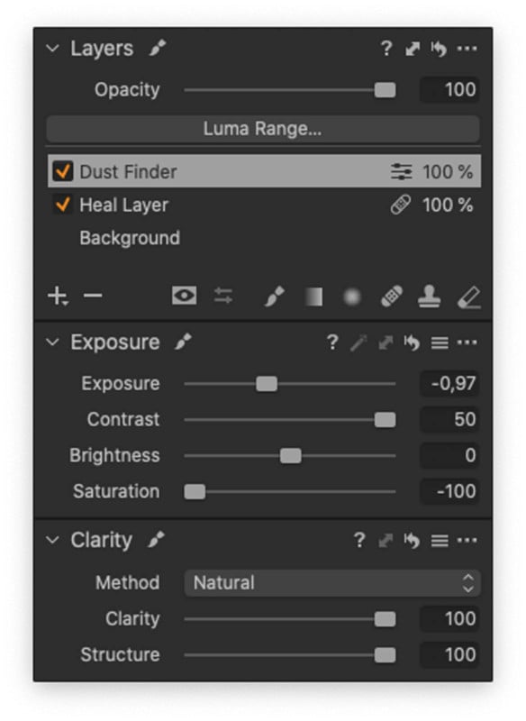

In this dust finder layer, we are going to lower the exposure slider a bit, and crank up the Contrast, Clarity, and Structure all the way. I also desaturate the image as Colors can be a distraction as well. The goal of those adjustments is to increase the contrast which will help reveal all the spots on the image.

After making these adjustments, we made the image look horrible, but now we can see all the dust spots clearly.

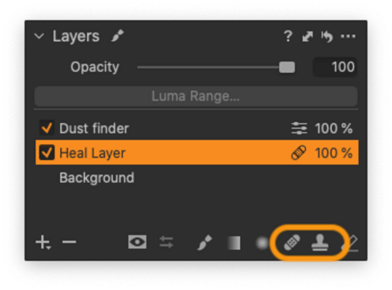

Step 3: Remove the Dust Spots
Now go back to the dust spot removal layer and select the healing brush tool you can also use the keyboard shortcut ‘Heal Brush’ (Q) and ‘Clone Brush’ (S).

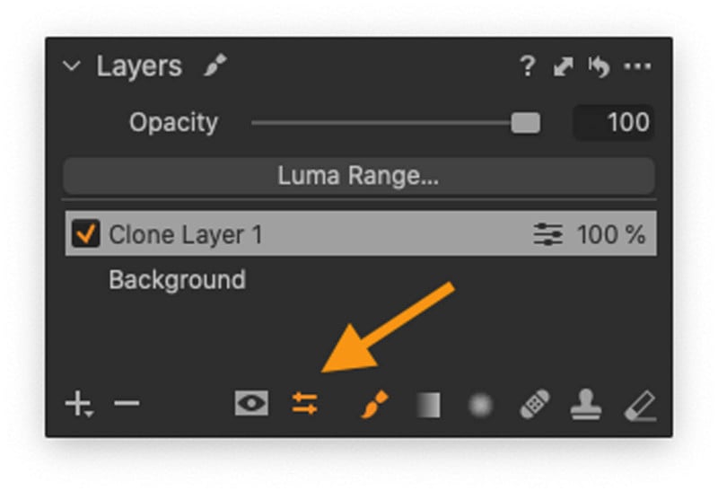

Cloning
To use the clone brush tool, you need to set a source point that you are going to clone from first, set a source hold down (Option / ALT), and click on the source you want. Then start brushing. With the cloning tool, I recommend that you use a feathered edge brush (by lowering the hardness slider to the left) to make the cloned area blend seamlessly without noticeable cloning edges.
To delete a clone area, you need to select the source point then hit the (backspace) button. Also with the clone tool, there is no limiting how many cloning areas you can have on one layer.

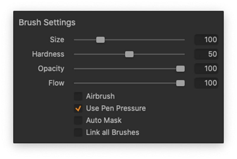

Heal and Clone Brush Settings
To invoke brush settings, you can click on the icon in the layers tool or right-click when the brush is selected.
Brush Size: To control how large the brush is, you can move the slider left or right. You can also use the keyboard shortcut, the square brackets (“[” and “]”). Use the left square bracket to make the brush smaller and the right square bracket to make the brush larger.
Brush Feather: With the hardness slider you can control how hard or soft the brush edges are. You can also use a key shortcut, the Shift + square brackets (“[” and “]”). Use the shift+[ to make the brush softer and shift+] to make the brush harder.
A screenshot of layers in Capture One
A screenshot of Brush Settings in Capture One
