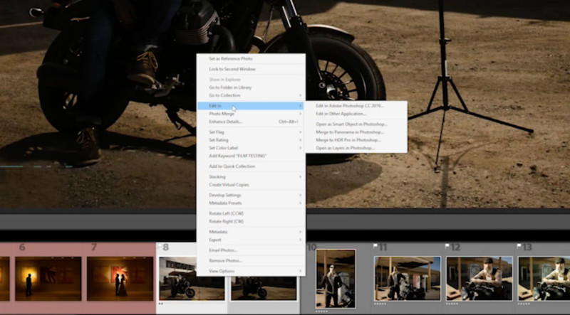

2. Right Click > Open as Layers in Photoshop
Right-click > Edit in > Open as Layers in Photoshop
If using Lightroom, select both images, right-click go to Edit in > Open as Layers in Photoshop. If you are using a different raw processing solution, jump into Photoshop and simply open up both your lit image and plate shot on two separate layers.

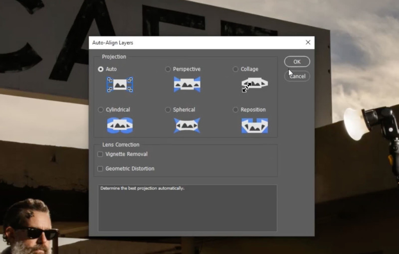

3. Auto-Align Layers in Photoshop
Make sure you Auto-Align layers to avoid any alignment issues.
Ideally, you shot the image and plate on a tripod. But, regardless, and just for good measure, I want you to auto-align the layers to ensure they are pixel perfect. To do so, select both layers then go to Edit > Auto-Align Layers > Auto.

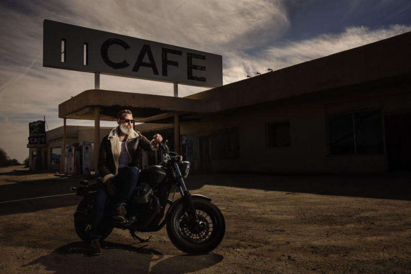

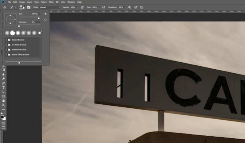

4. Add Layer Mask & Paint Out Lights
With a black brush at 0% hardness, paint with a Wacom pen or mouse to conceal the stands.
With the final lit image on top, add a Layer Mask and select your Brush (B) with default colors (D). With a black brush at 0% hardness, paint with a Wacom pen or mouse to conceal the stands while revealing the plate shot below.
Final image with light stands photoshopped out.

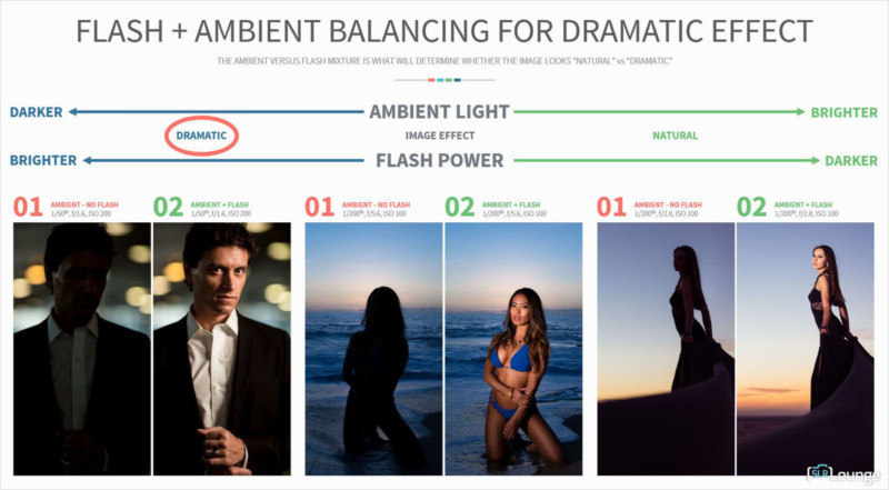

The difference between a natural-looking image and a dramatic image has nothing to do with whether you are adding flash or not, but instead, it deals with ambient light exposure. If you want a more dramatic looking image, you’re going to pull the ambient exposure down and pump up your flash power and do the exact opposite for bright more natural-looking images.
Here is a reference to help you get the perfect exposure for when you are incorporating flash for a more dramatic look.
We are shooting this at mid-day in harsh sunlight, which is why the lights are so close in the first place. I opted for a more dramatic exposure and chose to use my lights to brighten my subject.

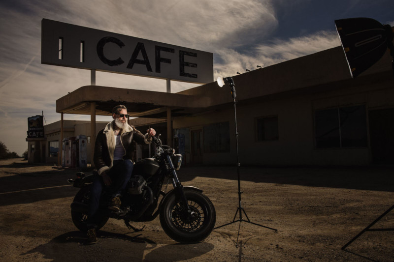

Step 3: Modify or Add Light
You can see one speedlight with a MagSphere that is being used to light Seth’s face while 2 Godox AD200’s are a little further back in the MagBox with the FocusDiffuser.
Now that we’ve chosen to create a more dramatic image, we will need a ton of power to get our subject to be brighter than the background. For this shot, we used 2 Godox AD200’s firing through a MagBox with the FocusDiffuser as our key fill light and one speedlight placed closer to Seth with a MagSphere to really chisel his face out of the scene. An equivalent setup could be used with say a Profoto B10+ firing through the MagBox or any small beauty dish or softbox.

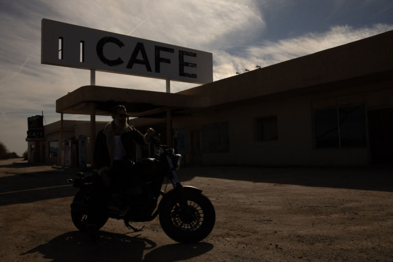

Remember the plate shot! After capturing your perfectly lit shot, remember to remove the light stands and shoot what’s referred to as a “plate.” This is where a tripod comes in handy to ensure that there’s no movement from the shot that had the lights, to the plate shot after. This can be done handheld, but it potentially can mess you up and slow things down in post-production. Best bet, use a tripod. Here’s our plate image below.
With both the lit image and the plate shot, we’re ready for post-production.
