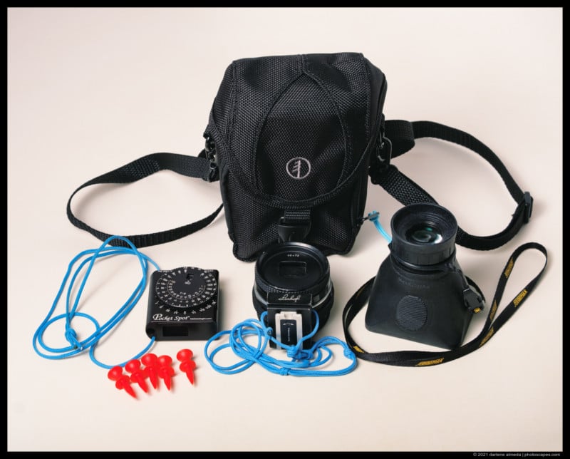

Composing Tool Kit: Tamrac Pro Compact 2, Pocket Spot, Linhof 6×9 Viewfinder, Hoodman Loupe, Location Marker Tees

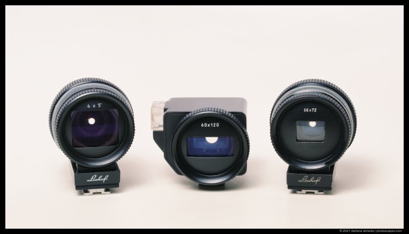

Linhof Viewfinder 4×5, Linhof Technar 65 Viewfinder, Linhof 6×9 Viewfinder
Viewfinders
Walking around looking through a detachable viewfinder is how I find compositions in the landscape; this is previsualization. I could use a black frame cutout made from mat board if I had too, but being able to use a small handheld viewfinder that matches my camera lenses with the film or digital sensor format is my first tool of choice. With the various format sizes available, it may not be easy to find exactly what you need, but over time I have been able to tweak my viewfinders to match my needs. Using a DSLR and a zoom lens may work as well, but that idea does not interest me because I want to be as minimalistic as possible. This Lens Visualizer Tool has helped me previsualize lenses and formats.

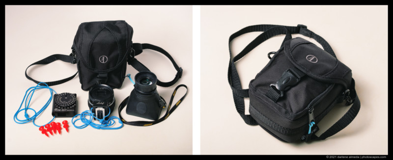

Most of my landscape shooting is done after I drive around looking for interesting views and then park and walk. I grab my Composing Tools Kit which will have the viewfinder for the tech camera I will be shooting, as well as a small light meter, Hoodman rubber loupe, and location tees. The light meter and Hoodman loupe are handy tools I keep with me on all landscape shoots. The light meter is for when I am shooting film, but if I am pressed for time in a weather or other situation while shooting a digital back, I can quickly get a meter reading without having to spend extra time looking at the histogram. The Hoodman loupe is an excellent cover for the digital back’s screen in bright sunlight, and since it is made of a rubberized material, it does not scratch the digital display. Once I find a location I want to return to with my camera, I place a location tee in the ground. I have not had a problem reclaiming a location tee, and if I did, I might resort to a GPS unit, but that seems a bit much at this time since a lot of the areas I venture into have intermittent cell coverage, and I really want to keep the gear to a minimum.
Composing tool kit, ready to go.

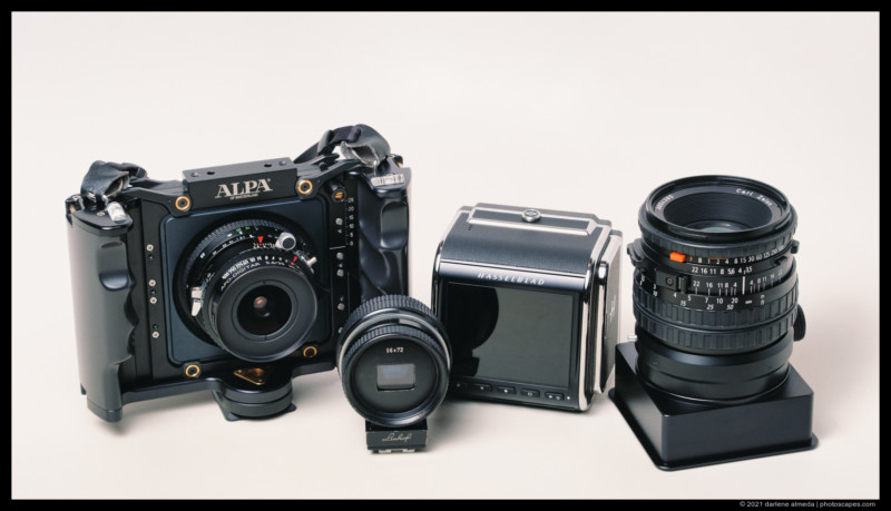

ALPA SWA, SK 35/5.6, Hasselblad CFV II 50C, Litz Studio Hasselblad/ALPA Lens Adapter + Hasselblad CFi 100/3.5, Linhof 6×9 VF with 56×72 Mask
ALPA SWA
I chose the ALPA camera system for medium format digital because of its minimalistic size with the ability to adapt Hasselblad lenses and accessories. I use a CFV II 50C digital back and Hasselblad “C” film magazines with these cameras. My lenses are the ALPA Schneider digital lenses: 28, 35, 47, 72, and 120, and the Hasselblad V lenses: 60, 80, 100, 120, and 180. When I take my ALPA kit out in the landscape, I generally take a wide, normal, and telephoto. A typical pack will have the 35, 100, and 180. If I am shooting on location where I will be inside of structures, then it would be the 28, 72, and 120. Finding the correct aspect ratio for my 44×33 digital back and a viewfinder took a bit of testing, but I found the Linhof 6×9 viewfinder fitted with a 56×72 mask made for the 4×5″ viewfinder matched up nicely to my lenses according to the numbers on the viewfinder dial. When shooting film, I simply replace the mask with a different 56×72 mask designed for the 6×9 format. Once I find an interesting scene, I turn the dial of the viewfinder to match a lens I have packed. I will then scan the landscape looking for compositions. Once I find what I am looking for, I place a location tee down and move on, or move back to my van and set up the camera to return for the photography. I focus via Live View when shooting digital and use a Hasselblad ground glass for film focusing.

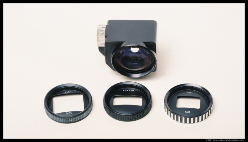

I acquired the Cambo Wide specifically for 6×12 black and white film panoramic shooting. The Cambo Wide is a lighter-weight 4×5″ camera that gives its users many options through the use of its Graflok back. Finding the Linhof Technar 65 viewfinder was a great find as the viewfinder that came with the camera was not adequate for pre-visualizing panoramas. Once I find an image through the viewfinder and return for the camera, I will then shoot one of two ways: (1) If the panoramas include the horizon, I will hyperfocal focus and shoot; (2) If the image will include a closer element I want in focus like this image, I will use the ground glass to focus. This camera can shoot 4×5″ film and other formats with the appropriate film magazines. The viewfinder masks I use include 4×5″ and 6×9 film formats.
Linhof Technar 65 Viewfinder, 4×5″/f=65 Mask, 60×120 Mask and 6×9/f=65 Mask

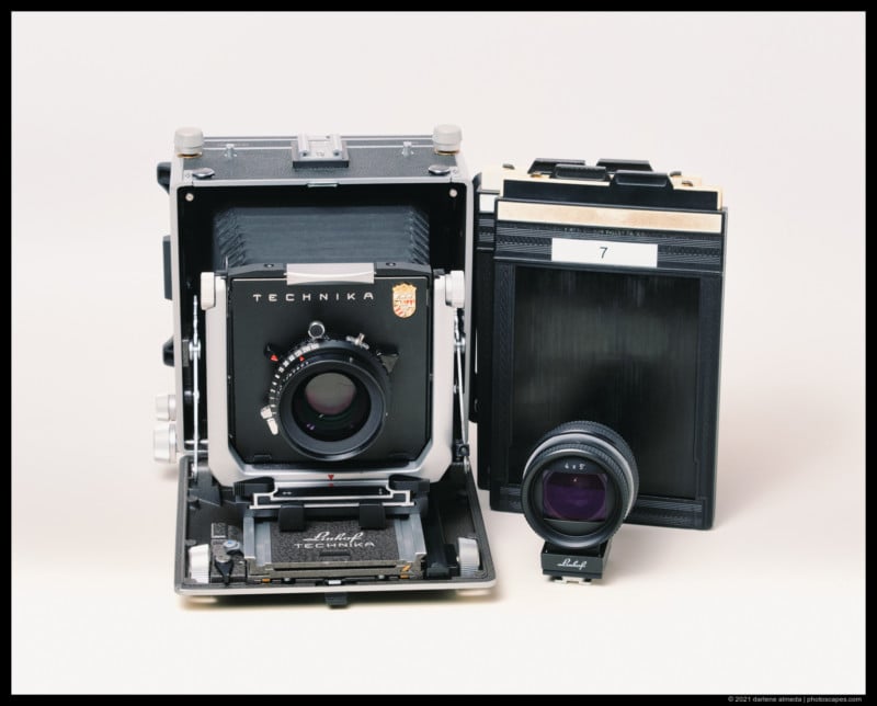

Linhof Master Technika 3000
The Linhof is my favorite camera because of its quality and versatility. When I shoot this camera out in the landscape, I previsualize with the help of the Linhof 4×5″ Viewfinder. I use lenses in the 65, 90, 150 and 210 range and can easily turn the dial of the viewfinder to match the specific lens. I use the ground glass for focusing when shooting 4×5″ film and Live View when shooting digital. This camera is precise enough to shoot with digital from my experience and can use my Cambo and Hasselblad accessories.
Linhof Master Technika 3000, Nikon W 150/5.6, Fidelity 4×5 Film Holders, Linhof 4×5″ Viewfinder

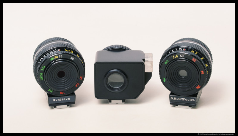

I was told by a longtime Linhof salesman that the 4×5″ and 6×9 viewfinders are the same, the painted lens numbers on the dials are the only difference along with the mask openings. I do not care if a viewfinder is in metric or feet, all I care about is that the view through it matches my lens as close as possible. I find it relaxing to visually explore inside the landscape prior to carrying gear. When I return for image-making, my camera is set up with the correct lens, filter, etc., and I will know ahead of time what technique for capture will be best.
