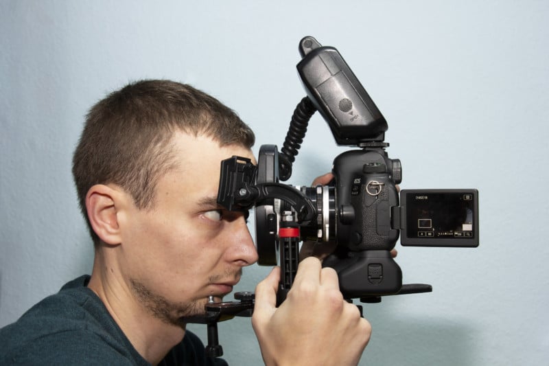

First off, let’s set-up our scene. As mentioned above you will need a solid surface to rest your head on and ideally something to rest it against, so that you will be able to hold it steady and keep focus.
The Setup

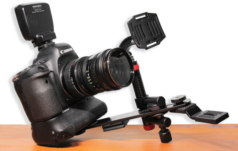

For my build, I used a flash bracket (the long flat-bar) and a few repurposed GoPro accessories. This set-up can be mounted onto a steady tripod and allows for stable shots with continuous focus.
Alternatively, you can wedge your head into the corner of two walls or do it yourself with screw clamps, or some scrap wood and a few screws.
Framing your own eyeball can be tricky, as it will move between checking the composition in the flip screen and looking back, directly into the lens. Therefore, I recommend sticking with smaller magnification ratios rather than filling the frame with your iris; even though we are trading off some image resolution this way, I think it’s worth it as makes the shooting process much easier.

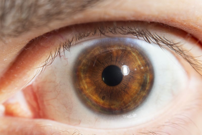

In my initial setup, I used a macro ring flash, which made for perfect and even lighting, but unfortunately, it was impossible to cut out the distinct reflection in my eye.
I used a reversed 28mm lens at it’s shortest working distance o push the reflections more towards the outside of my iris, but the results were less than perfect:
Even though the lighting itself looks good, the disturbing crescent-shaped catchlights are rather distracting.

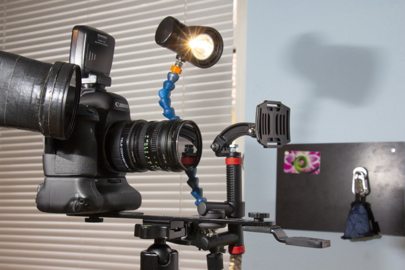

To address this problem, I switched the ring light out in lieu of an off-camera flash and the reversed 28mm lens for a reversed 50mm lens on a 2x teleconverter. This way I got to maintain an ideal working distance of about two inches, which allows enough light to enter my eye without being blocked by the lens.
Instead of a true macro lens I used a reversed 50mm lens with a 2X tele-converter, which yields roughly 1X.
However, taking the flash off-camera would cause reflections of the speedlight and various other objects around the studio to appear in my eye, so I added a circular polarizing filter to the front of my lens. This helped to cut out glare and avoid reflections.
To make my life a bit easier I used a flash light to help me focus my camera correctly.
To further increase the effectiveness of that CPL filter I also attached one to my speedlight, allowing for cross-polarization to happen and therefore to minimize glare.

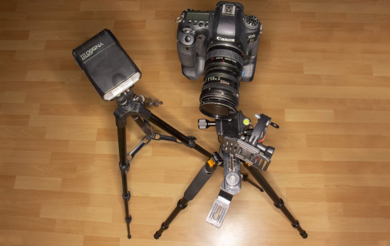

But even without applying this technique, the quality of light and the extent of reflections caught in your eye can be suppressed to a large degree, simply by moving your lights off to the side.
I achieved the best results with the light positioned roughly 110 degrees from the eye and 70 degrees from the camera. This allows for enough light to enter the eye while keeping its reflection to a minimum.
Of course specular highlights and the inevitable reflections of your own eyelashes can be retouched in post as well. But even though removing all obstructions from the subject provides the clearest possible view of it, it bears the risk of making the eye appear flat and lifeless:
Comparing these two almost identical images demonstrates the effect reflections – they make the eye appear more vivid and life-like.

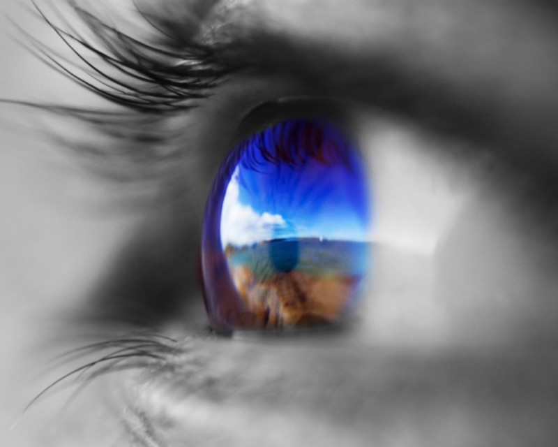

Of course you can take a different approach too and photograph the human eye outside, in ambient light.
However, this method requires a lot of light and will only promise success on the sunniest of days. And even then you are going to need a high shutter speed or a tripod und likely a high ISO, too.
And, because you’re using ambient light, you will inevitably catch lots of glare in the eye you’re photographing, along with a reflection of your camera lens.
Unless, of course, you shoot from an angle. This way you can get creative and catch the view of the eye you’re photographing as a reflection, like in the image below.
