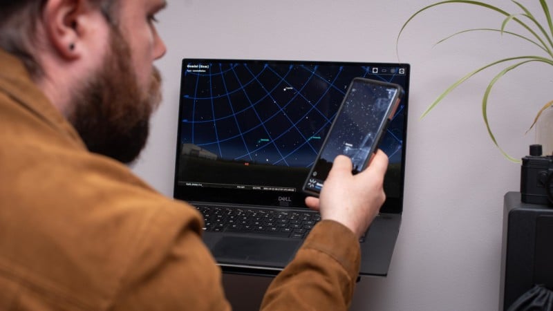

As the name suggests, the Geminids will appear most prominently around the constellation Gemini, though they’ll also be visible a few days on either side of it as well. Generally, Gemini will appear above the horizon roughly northeast across the globe this time of year. Should you want to get a more accurate direction though, turn to a night sky app on your smart device or computer. We recommend Stellarium for both desktop and mobile as it’s easy to navigate and simple to jump through time and dates and search for the constellation or meteor shower itself.
Person holding phone next to laptop with astro software on it
If you don’t like relying on too much tech, you can always navigate to Gemini using the stars. In the northern hemisphere, just look for Ursa Major (aka the big dipper) and draw a line from the two end stars, starting at Merak, heading up to Dubhe, and then continue up until you reach the next brightest star. That is called Polaris, or the north star, and forms the tail of Ursa Minor. From here you can find northeast pretty easily.

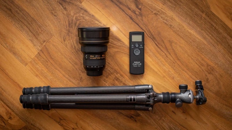

A flat lay image of a wide angle lens, intervalometer, and a tripod on a wooden floor
A tripod is a must to photograph the Geminids as we need to keep the camera steady during long exposures; my recommendation is to use one with a ball-head as it is ideal to enable a variety of shooting angles. Since the Geminids appear across the night sky, only with an emphasis on the direction of Gemini, a wide-angle lens of around 24mm or wider would be best. Try to choose a wide-angle lens that has a wide aperture too, such as f/2.8 or faster.
How to Photograph Meteors
Technique-wise, what we’re going to do is take loads of photos, one after the other, with the hopes of capturing some frames with meteors in them. The idea is to then composite the useful frames together in image editing software later to create a single photo with all the best photos together.
If your camera has an interval timer built-in, then a simple external shutter release is all you need to fire the camera without touching it. You can use the self-timer feature in a pinch if you don’t have a separate shutter release. The whole goal of this is to reduce vibrations and camera shake blur. However, if the camera doesn’t have a built-in intervalometer, then you should opt for an external intervalometer which will both trigger the camera remotely and take a series of images one after the other, without asking you to regularly press buttons on your camera through the capture process.

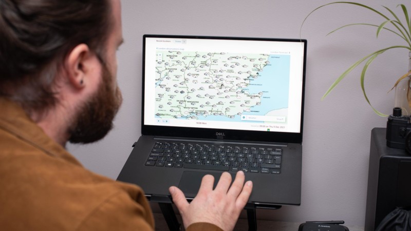

Keep an Eye on the Weather
It doesn’t matter which direction we look in if it’s cloudy as the meteors will be obscured from sight. Check the weather forecast ahead of time to avoid wasting the time it takes to travel to a suitable location, especially if going a long distance to, say, avoid light pollution.
Person checking weather forecast on laptop
Be aware though that weather forecasts are generally more regional than local, so they are not always super helpful for specific local spots. What that means is that if there is a chance you will have time to view and shoot without cloud cover, it might be worth heading out just in case.

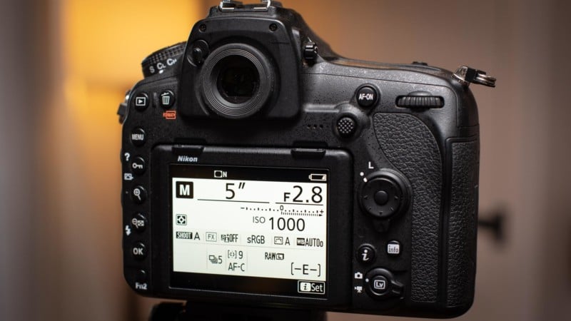

Use manual mode for this shoot; other semi-automatic modes like shutter or aperture priority might change exposure settings during a long shoot based on cloud cover and light pollution, which makes it hard to composite photos together later in editing software. To keep things consistent, shoot entirely in manual mode.
Rear LCD view of Nikon D850 displaying settings for capturing meteor shower
Camera settings depend on the darkness of the sky, any extraneous light pollution, and the maximum aperture value of the lens used. However, rough starting camera settings could be an aperture of f/2.8, 5-second shutter speed, and ISO1000 or greater. Make sure you turn off long exposure noise reduction. It might also be a good idea to lock your white balance to make sure the colors in all your photos are consistent. If light pollution is an issue where you’re shooting, opt for Tungsten or Fluorescent white balance to reduce the orange glow and make sure to shoot RAW.

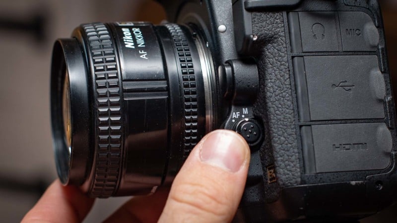

Get Focused
Autofocus notoriously doesn’t work well in low light, so focusing on the night sky will be nearly impossible. Instead, we’ll manually focus for the best results. Engage live view on the rear screen and aim at a bright star or very distant street light. Switch over to manual focus on the lens or camera body and zoom in on the star in the screen using the digital magnification feature found on most digital cameras. Manually adjust the focus ring until the star is as small and defined as possible.
