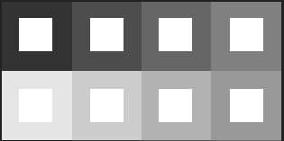

To better explain this. Let talk about an art theory that painters have applied to their art for centuries.
When placing a bright and dark subject right beside each other the bright subject will look brighter the dark subject will look darker.
Take a look at the following 8 squares that are surrounded by larger square backgrounds. The inner squares are all the same value, but the first one at the upper left appears to be the brightest. Why? Because it has the darkest surrounding.
If we use our light on someone with a darker skin tone in the same way as someone with a lighter skin tone, the shadow will be too dark. This will make the highlight appears brighter. So bright that they look like hot spots even though nothing is overexposed. In other words, the image will be too contrasty. Lots of highlight and shadows but lack of halftone.
