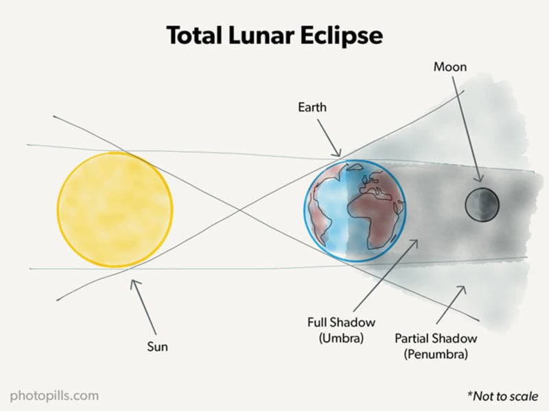

What is a Total Lunar Eclipse?
A total lunar eclipse occurs when the Earth moves between the Sun and the Moon, covering the Sun’s rays and casting its strong shadow, called the umbra, on the Moon.

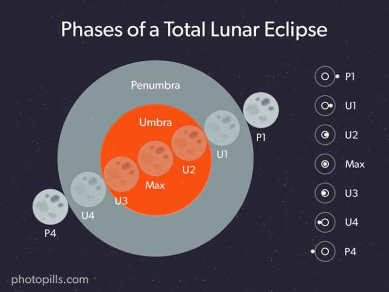

As the Moon enters Earth’s shadow, the eclipse goes through 7 phases or stages.

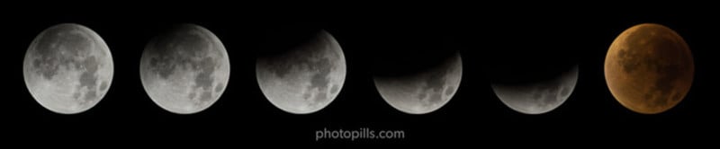

- Penumbral eclipse begins (P1): The penumbral part of Earth’s shadow starts moving over the Moon. This phase is very difficult to observe with the naked eye.
- Partial eclipse begins (U1): The Earth’s umbra starts covering the Moon, and the eclipse becomes more and more perceptible.
- Total eclipse begins (U2): The Earth’s umbra completely covers the Moon. The Moon turns into red, brown or yellow. It’s popularly known as the Blood Moon.
- Greatest eclipse (Max): This is the central moment of the total eclipse.
- Total eclipse ends (U3): The Earth’s umbra starts moving away from the Moon so it’s visible again.
- Partial eclipse ends (U4): The Earth’s umbra completely leaves the Moon allowing the lunar surface to be visible again.
- Penumbral eclipse ends (P4): The Earth’s penumbral shadow moves away from the Moon. It’s the end of the eclipse.

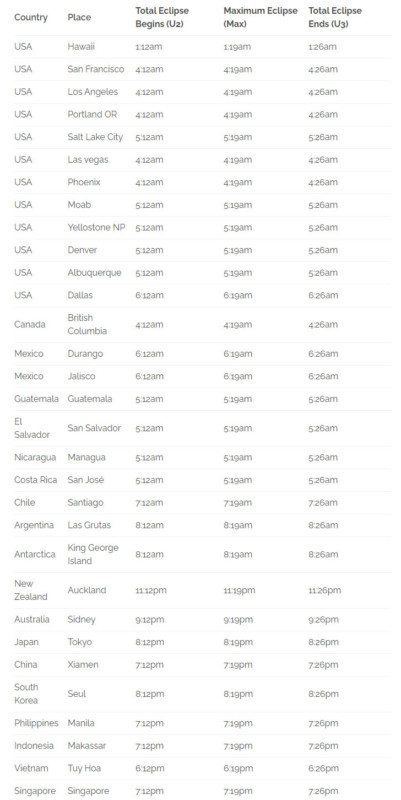

So here you have a list of places where you can enjoy all the phases of the eclipse (including the phase of totality).
The table also shows the time the eclipse begins (total lunar eclipse phase begins U2), the maximum (Max), and when it ends (total lunar eclipse phase ends U3).
To create the table above, I’ve used the lunar eclipse information that the Planner tool included in the PhotoPills app provides. The app allows you to plan your photos ahead of time so you’re always at the right place, at the right time to capture the scene you want.

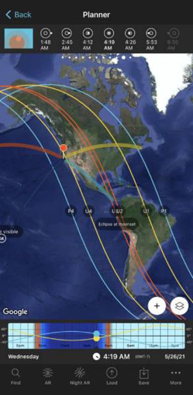

In the app, to get all the total lunar eclipses info you need, all you have to do is to:
- Go to the Planner and choose the May 26, 2021, total lunar eclipse from the eclipse calendar. The eclipse info will appear on the map.
- Place the Red Pin in the location you want to photograph the lunar eclipse. You can use the Load button (at the bottom) to type the name of the place if you know it. Otherwise, you can drag and drop the Red Pin. Or just do a long press on the spot you want to place the Red Pin and it’ll be placed there.
- Get the local times each eclipse phase occurs from the eclipse panel above the map (Panel 10). Swipe the panels until you find it.
- Swipe the Time Bar (below the map) to change the time and see on the map where the eclipse occurs at all time (thin line).
- And if you’re right where the Red Pin is, you can also use the Augmented Reality (AR) button to visualize the position of the lunar eclipse in the sky.
PhotoPills Planner – The Red Pin is located in San Francisco (USA) where the total lunar eclipse is visible at Moonset.
PhotoPills Planner – On Panel 10 you have all the eclipse phase times for San Francisco. On the map you also have the position of the Moon during the eclipse for the selected time (using the Time Bar). Zoom in the map as much as you want to help you plan your photo.

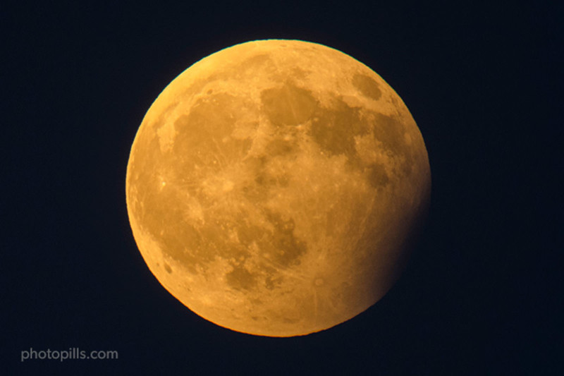

So, first, decide what you want. Maybe you want to photograph a particular phase of the lunar eclipse, without a foreground.
Nikon D500 | 700mm | f/8 | 1/15s | ISO 1250 | 6450K | 2x teleconverter

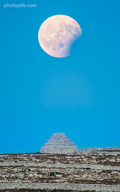

Or maybe you’re interested in capturing the eclipse aligned with a cool subject you know.
Fujifilm X-Pro2 | 83.8mm | f/5 | 1/15s | ISO 400 | Photo by Joaquín Márquez.
