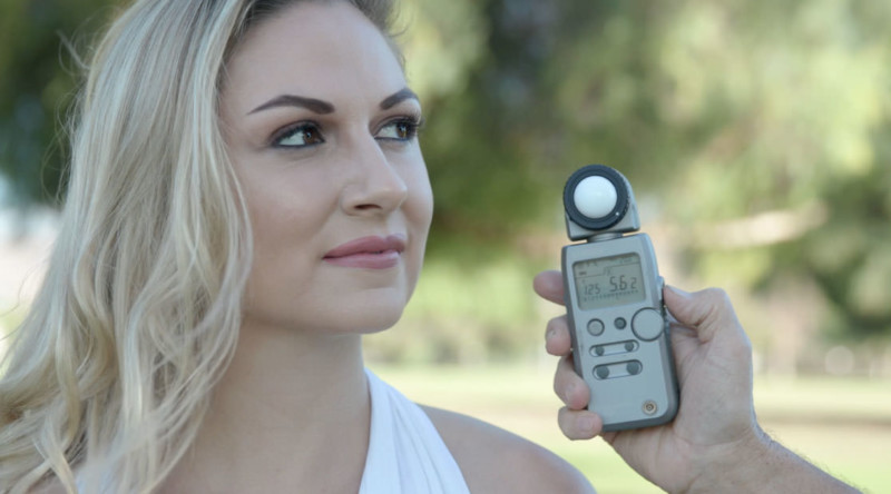

Use a Light Meter
This is the best, safest way for your photos to come out look great with the correct exposure! By using an external light meter, you can take a reading of whatever is being picked up by the camera. I’ve got an old-fashioned light meter and the new Illuminati Light Meter, both are good for different reasons.
The Sekonic Light Meter is an incident light meter that records the light that falls onto them directly, so they take an immediate reading. With this meter, you need to walk up directly to your subject and take a reading there pointed towards the camera.
The reflective light meter records the light that bounces off your subject that’s why cameras have internal reflective light meters. With the Illuminati Light Meter (below), you can put your light meter on a stand and let it stay there while you continue shooting.
Setting up our meter
First off, I’m going to aim this meter back at the subject aiming directly at the camera with the bulb in or out. If the bulb is in, it cuts your exposure in at over half at a stop, There isn’t any reason to do that, so I leave the bulb out.
Now the Fuji 400 I would probably cut it one more stop. I would take my Fuji 400 and rate it at ISO 100. With the Portra 400, I’d set it at ISO 200. Let’s take a look at the shots in the studio!
