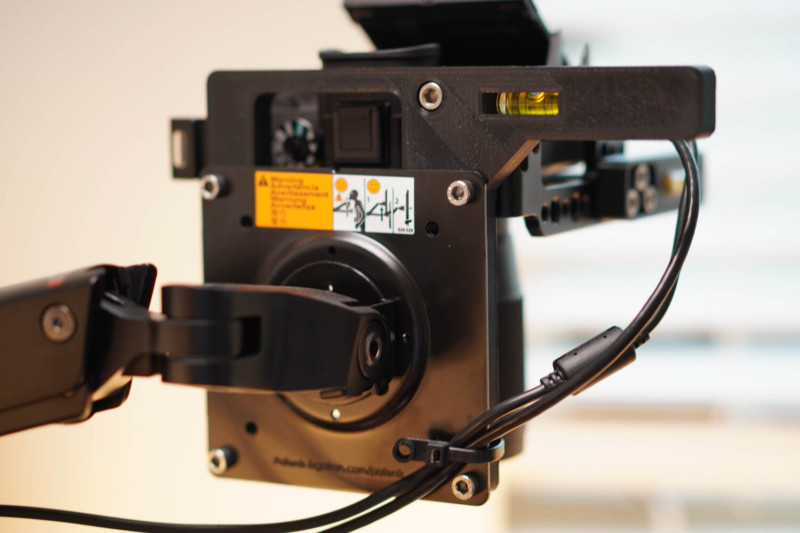

Doscher’s much more elegant desk-ready solution uses a VESA mount monitor arm at its core.

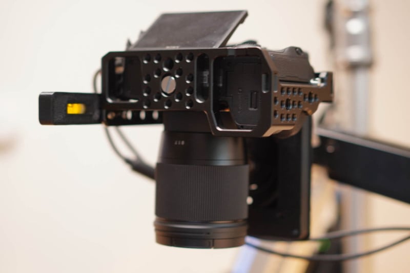

“The idea is pretty simple- a 3D printed mount that attaches to a heavy-duty PC monitor arm. My design supports a full-size Sony mirrorless camera, but you could easily design your own to do the same thing. Given how many different cameras there are I could only design for what I have, so you will need to either invest in the same gear I did, or simply make your own design.”

- Heavy Duty Monitor Arm
- M5x10mm Socket head screws to attach the monitor arm to the 3D printed base plate – 91292A124 on McMaster Carr

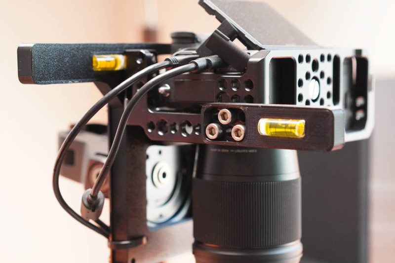

- 1/4” Socket head screws to attach the “plastic parts to the camera frame – 92196A537 on McMaster Carr

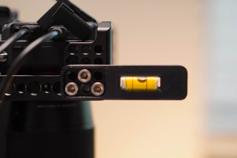

- Two bubble levels to snap-fit into the project, one into the base plate and one into the handle – 2148A66 on McMaster Carr

The 3D printed parts that Doscher designed fit right into both the camera cage and the VESA monitor arm, so once all the parts have been compiled, putting together the finished product is pretty straightforward.
“The files are specific to this camera frame and camera, but the bolt pattern for the VESA mount is the same,” Doscher writes. “I hope this inspires you to design your own!”
