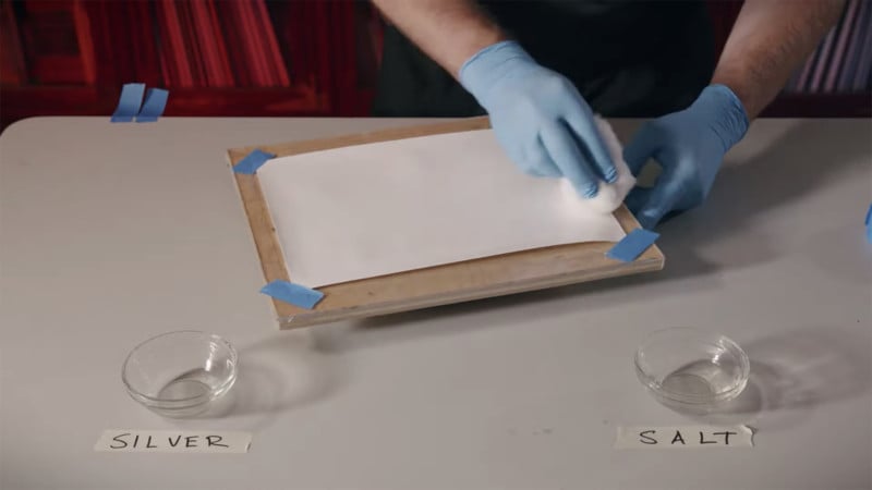

The process described in the video above follows the same simple formula Talbot created. There are only three ingredients you need to make a piece of paper sensitive to light: water, salt, and silver nitrate.
By applying a solution of both silver nitrate and sodium chloride to fine art paper, you can make the silver nitrate sensitive to light. That is to say, make it into a photographic print paper. The resulting paper, once dried, is not sensitive to white light. In order to develop a negative onto the paper, you’ll need to use a UV source like the sun or special UV lights like the video shows.
To say that only three ingredients are required for this method in its entirety is a bit disingenuous, as you will also need gold chloride (or selenium) to tone the image and fixer to remove the unused silver. They also apply a wax to the image to preserve it, but this is optional.
Still, the process is fairly straightforward and easy to do at home and is not that time-consuming. Exposing the paper to UV light only takes a few minutes, to the most time will be spent applying the salt and silver nitrate to the paper and drying it.
