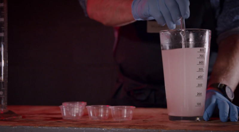

The ingredients need to be in their exact proportions to create your batch of developer, so make sure to weigh them carefully. Once the dry chemistry is weighed, add each dry ingredient to 750ml of water one by one in the order above, making sure each is completely dissolved before adding the next one.
Mixing the ingredients into water.
Once all of the ingredients have been dissolved in the 750ml of water, transfer it to your final storage vessel and add 250ml of water to bring the final volume up to 1 liter.

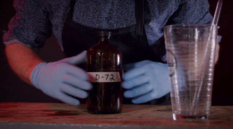

Be sure to label your homemade chemistry.
Voila! You now have 1 liter of homemade developer.

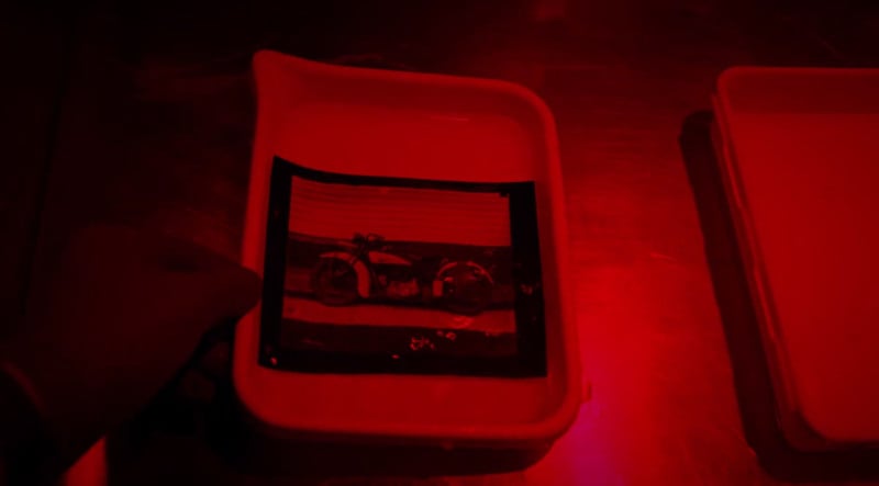

To use the developer, Brandreth recommends that you use it at 68° F (20° C) diluted at a ratio of 1:2 with water and with a development time of 1 to 3 minutes — your exact development time will vary depending on the final look you’re going for.
