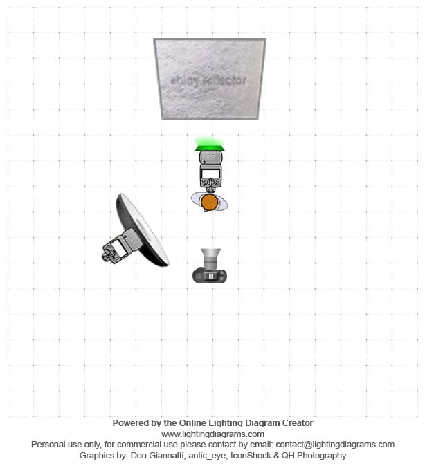

I had a fellow photographer friend come sit for me to help practice some lighting setups for a beauty shoot I would be photographing later that week. I decided I wanted to play with my speed lights, so I lit him with a ring light/softbox (that I got from Wish for only about $20) and lit the tinfoil backdrop with a second bare speed light.
My settings for these photos were f2.8 1/100 ISO 400 with my 85mm lens. I had two-speed lights, One aimed at the backdrop behind the subject set at 1/128 power, the other was attached to the ring light facing Joe. I also thought it would be fun to use gels to add a pop of color.
