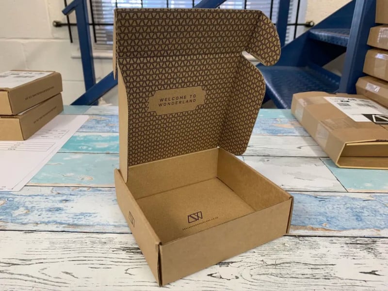

I was sitting in front of the PC considering my options for alleviating the boredom when it happens. I spot a small cardboard box I’d received some film in from Analogue Wonderland that I hadn’t got around to throwing in the recycling.
That’s when the light bulb moment happened. “I wonder if I could make that into a camera?”
Now I enjoy all forms of photography, but I do love pinhole photography and I enjoy making pinhole cameras. But making a camera out of a piece of packaging that’s basically cheap brown cardboard and full of fairly obvious holes where its folded together?
“Nah! That’s a stupid idea,” says the sensible internal voice. “Cool, let’s do it,” says the up-for-a-challenge internal voice (did I mention the lockdown? And boredom?).
Do you see a box or a camera?
Cutting to the chase, it turns out it is, in fact, both possible and fairly easy to make a pinhole camera out of Analogue Wonderland’s mailing boxes.

  1. The small mailing box.

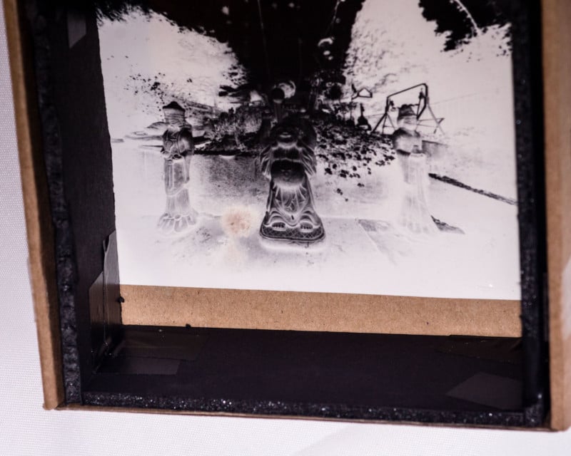

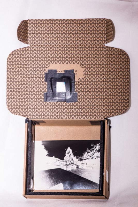

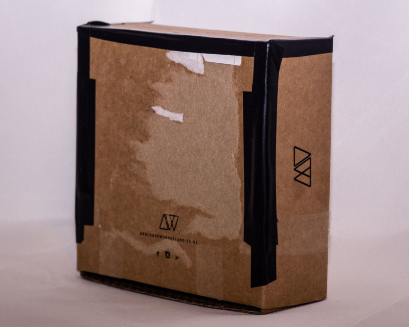

The initial construction was simply a matter of using the black electrical tape to tape over all of the edges of the box where there are slots and tabs used to hold the box together. And the slots created at the back where the sides of the box are folded. Basically anywhere it looks like light may get in.

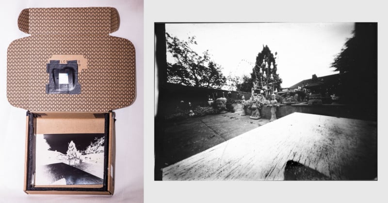

I then realized that when the lid folds down and is secured with its tabs the four corners wouldn’t be light-tight. This is where the foam core board offcuts from previous camera builds came in. Three pieces cut to fit inside the box along the front and sides, leaving a small gap between the side pieces and the side of the box for the lid tabs. The foam core is roughly 5mm thick so once the three pieces are taped into place they form a light-tight baffle around the edge of the lid and also hold the paper negative in place as it can be slid into the box under the foam core.
The next decision was where to put the pinhole. Normally this would be smack bang in the middle. But I wanted to keep the logo intact.
Light bulb moment two, cut out the triangle that represents the “A” in the Analogue wonderland logo and put the pinhole there…. obvious, really.
My standard shutter on pinhole cameras is a short length of electrical tape over the hole. However, I didn’t want the tape to possibly tear the box material which could cause light to leak in. Another easy fix: put a square of normal sellotape over the logo and cut out the triangle where the pinhole is. The shutter tape won’t cause damage and will come off easily.

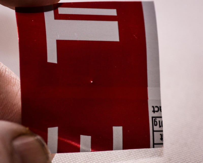

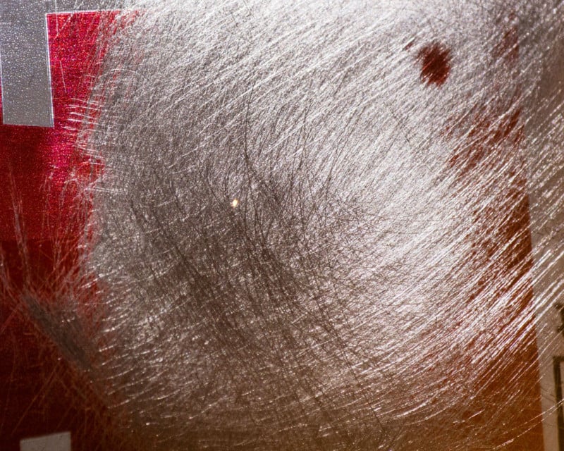

The pinhole itself I already had made, but again it’s an easy job. Take a small square of a drink can. Gently poke a pin into it until it only just about pierces through the aluminum. Use the sandpaper or fine wire wool to sand down the raised bump created on the backside of the aluminum.
This makes a pinhole that is roughly 0.298mm in diameter which is the size of pinhole that most pinhole camera design calculators use as a base size. I use a phone app that’s based on the camera design calculator on mrpinhole.com.

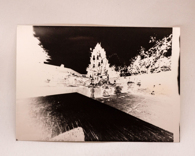

So far at the time of writing, I have only made two photographs with this camera in my garden just to see if it would work. As you can see below, it does.
I used some old Kentmere paper which I rated at E.I. 3. This using the light meter app on my phone set at ISO 3 and f/151 on a fairly bright but cloudy day gave me eight-minute exposure times.
The pictures came out well though the center of the negative is slightly overexposed so if/when I use the camera again, I will try using it at f/100 to give a slightly faster shutter speed, which should give a better exposure in the center if slightly darker edges.
