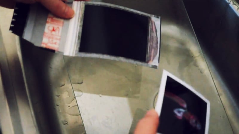

Step 1: Peel Apart the Photo
Firstly you will obviously need to take your shot as you normally would. After the allotted time has passed proceed to peel apart the film from its backing. Be sure to place your print somewhere safe as it’s still wet from the processing chemicals. You should also place the piece that you would normally throw away somewhere safe as this section is what we extract the negative from. It is worth noting that this piece is extremely wet at this stage so be mindful not to place it chemical side down on anything porous, doing so may result in damaging the surface.

Peel apart the print from the backing ensuring you remove as much border as possible.
Step 2: Peel Apart Other Materials
Now that we have our non-print section we should go about peeling apart all of the borders and additional materials. You should end up just a single piece of very dark material. For the process, I use it is important to ensure all the borders are removed as I stick this to a piece of glass so a clean bond is essential.
Stick the backing to the glass with water and ensue there are no bubbles or air pockets.

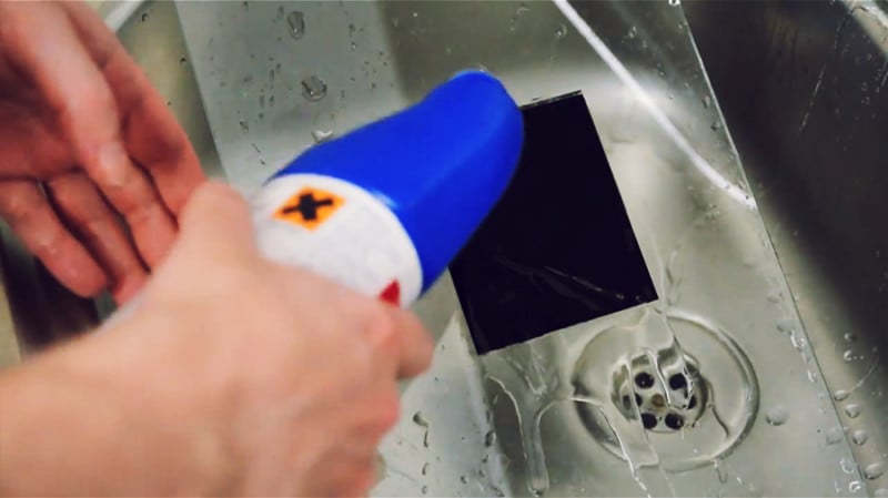

Step 4: Bleach to Expose the Negative
Once that’s sealed to the glass, it’s time to add the active ingredient that actually removes the backing and exposes the negative. You’ll be pleased to hear that ingredient is simply household bleach and is readily available anywhere. One thing to note is that it does need to be regular bleach, the cheap stuff. Similar gels and other potent cleaning products don’t actually have the active ingredient of bleach so they will not work.
After you have coated the back of the sheet with bleach, leave it for around five minutes.
Step 5: Spread and Wait
Liberally spread the bleach over the back of the sheet making sure it is entirely covered. Once it has been applied you just need to leave it for several minutes to do its thing. Depending on ambient temperature, around five minutes should be about fine.

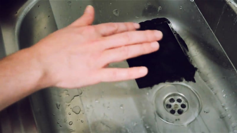

When you return you should now see that the bleach is doing its job and black gunk should now be forming on top of the sheet. Carefully at first, proceed to remove this gunk from the negative. You can wear gloves for this part as bleach is a strong chemical that some people can find very irritating to their skin. Continue removing the gunk until you can feel that it has been entirely removed from the negative. Below the surface should be very smooth and any remaining black gunk should be easy to feel. Add a little water to wash away some of it to check and then continue until you are certain it has all been removed.

Once you have removed all the gunk from one side, flip it over but be sure to only use warm water on this more delicate side.
