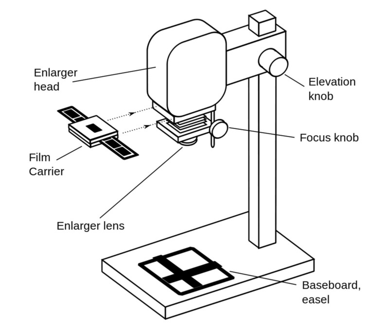

A typical enlarger design. Illustration by きたし and licensed under CC BY-SA 2.5.
I began thinking that a darkroom photo enlarger would be based on about the same principle. In an enlarger, we also have the light pass through some condenser lens (depending on the design) and it will pass through the negative, go through the lens, and be projected big on the photo paper.

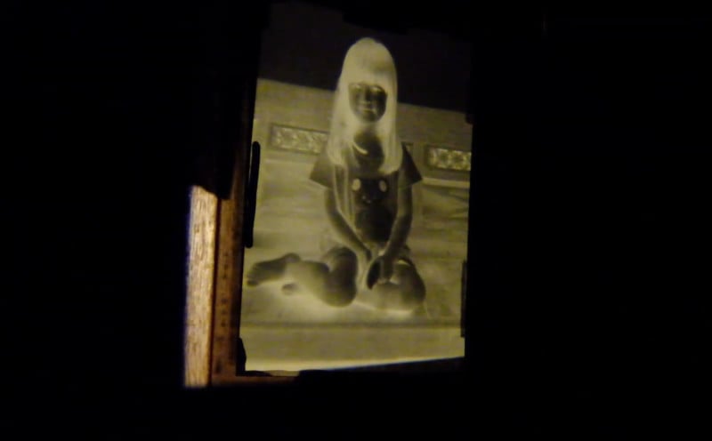

Negative Carrier
Negative carrier.
I decided to use my photo paper holder inside the Afghan Box Camera for this conversion. I taped up a 6x7cm window using some black PVC tape. If this were to be a more permanent setup, I would make a proper negative carrier. For now, this will do and I used some small pieces of masking tape to secure the 6×7 negative flat against the glass.
To focus, I would move the focusing rods per the usual way when using the Afghan Box Camera, which moves the negative towards or away from the lens.

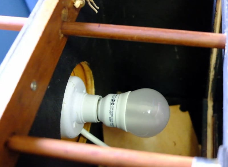

Light Source
Unlike a light source for a slide projector, the enlargement is smaller so the light source for this enlarger can be relatively less powerful. So I use a simple 11W warm color LED bulb. As I do not have a timer, I simply use the on/off switch for the bulb during printing to control the exposure time.
