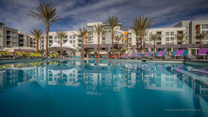

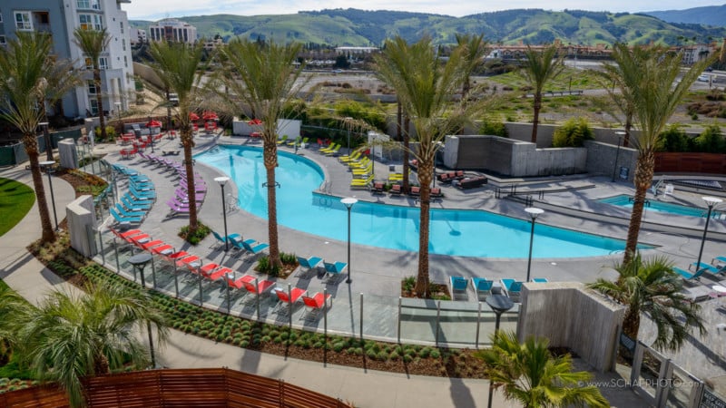

This is one of the delivered photos of the pool at 11:43AM. The client likes their pools to look big so the lower angle really emphasizes the water (and on the low photos we don’t have to wet the deck). Photo © Stephen Schafer Schafphoto.com

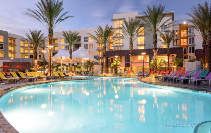

This is one of the delivered detail photos of the pool at 11:34AM. It just goes to prove that you can take a worthwhile photo even at noon. Photo © Stephen Schafer Schafphoto.com
This is one of the delivered architectural photos of the pool from above. Taken from a balcony while we were plugging lights into all the apartments. Photo © Stephen Schafer Schafphoto.com

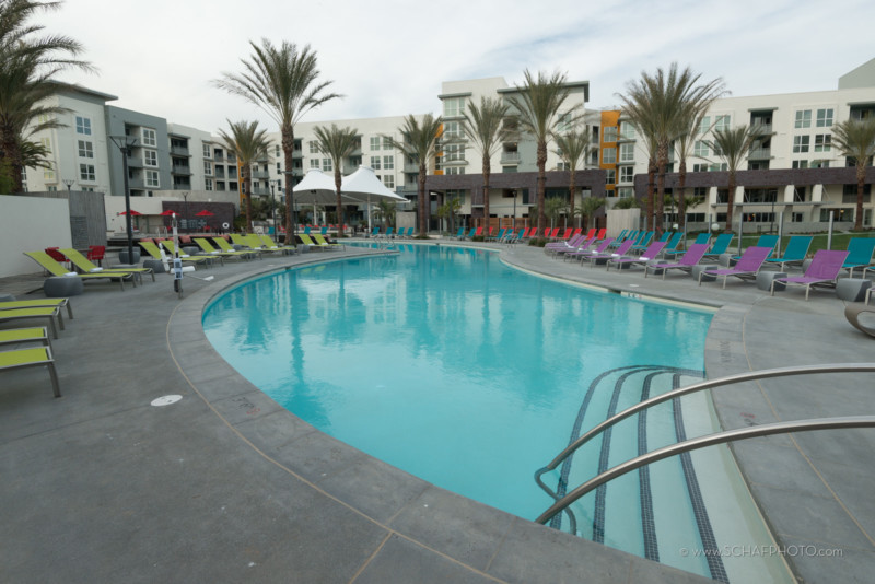

This is the ‘Before’ photo and is a higher and wider view of the pool before we began setting up the hero. Slighty cloudy and flat at 3:49PM.
3:45. Partial clouds are blocking the sun and the whole scene looks lifeless and flat. I position my Nikon D800e with 16-35mm f/4 VR lens and settle on a final angle of view, focus, zoom, and aperture. (ISO 100, Aperture f/8, auto shutter speed, zoom to 28mm, Quality set to 14-bit Raw + Jpeg medium) I set up my Slik Professional-4 Tripod Legs with a Manfrotto 405 geared head, I like the Slik because it is VERY heavy and stable and can extend to 8+ feet high. In this case, I use the tripod unextended at about 3 feet high in order to make the pool look like a vast sea with a lower than usual camera position. The lens is tilted slightly upward to get a little headroom above the palms. The horizontal axis is leveled using the electronic level on the live view screen of the D800. I add a Heliopan high-transmission slim circular polarizer and shade the lens from above with a FlareDinkum Compact lens shade in the hot shoe of the camera in addition to the standard lens shade.

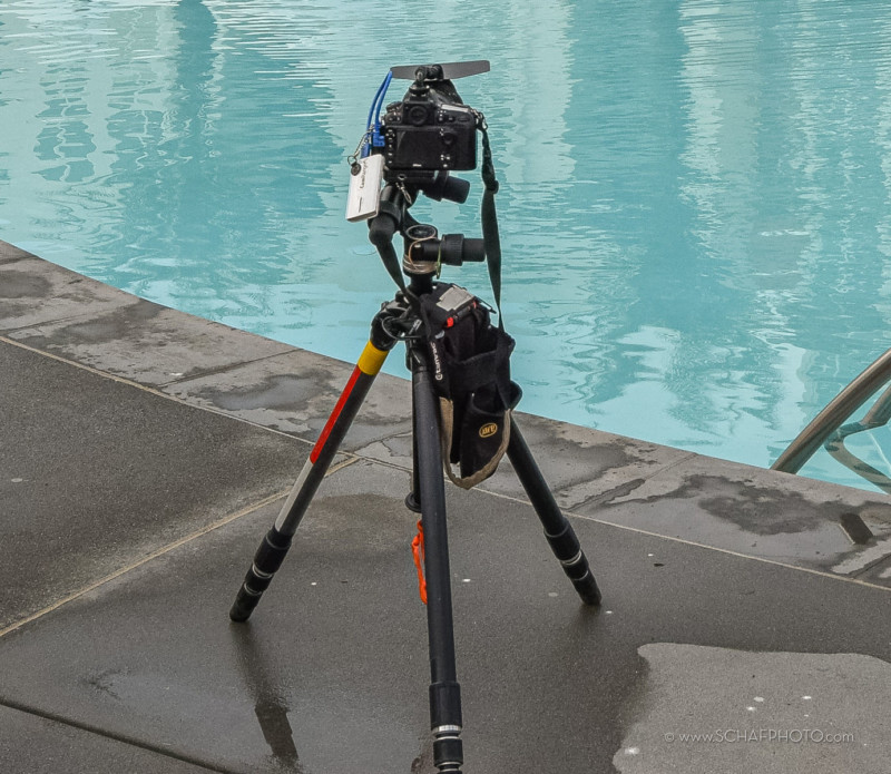

4:30. I hang my CamRanger Wi-Fi dongle from a loop of wire fishing leader I have permanently attached to the left attachment point of the D800e. I plug a 12-inch right-angle USB 3 cable into the camera and boot up my iPad Mini Retina. I set the CamRanger intervalometer to take a single frame every 40 seconds and set the bracketing to three frames at +1, Normal, -1. I adjust the CamRanger camera settings to f/10 at aperture priority automatic. Focus set to manual, and vibration reduction is switched off. New batteries are put into the CamRanger and Nikon along with a freshly formatted CF card before all HERO captures.
A still from the BTS video at 4:27PM. The D800e with the CamRanger, FlareDinkum Compact shade and nail pouch. Photo © Stephen Schafer Schafphoto.com

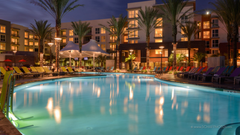

This is the ‘building layer’ of the HERO. 20 seconds at f/10. The blown-out pool light can be seen at the bottom. All apartments lit with $5.00 cage lights. Photo © Stephen Schafer Schafphoto.com
6:02. My intervalometer unceremoniously captures the HERO frame that becomes the master Photoshop layer for the building and courtyard with lights and glowing windows. Exposure 20 seconds @ f/10.
6:09. I dunk two chaise lounges in the pool to eliminate the blown-out highlight from the pool light on the left side. This creates a nasty green cast but mitigates the blown-out pool. This gives me an imperfect but usable pool layer for Photoshop. Exposure 30 seconds @ f/10. Most of the green cast is removed in Lightroom by adjusting saturation and color balance using radial filters.
This is the ‘pool light mitigation’ layer of the HERO. 30 seconds at f/10. The blown-out pool light is behing two green chaise lounges I placed into the pool to mitigate the highlight. Green cast removed in Lightroom later. Apartments still lit with cage lights. Photo © Stephen Schafer Schafphoto.com
6:16 to 6:55. I pull the chaise lounges out of the pool and my intern goes to turn off all the apartment lights and pull our cage-lights and lock the doors of each apartment. I put away the iPad and CamRanger and strike the main shot. While the lights go off one by one, I take some additional night photos of fountains and the tent canopy.
7:00. We strike tripods and cameras and the duffle bag o’ cage lights into the truck.
7:15. We go have pizza and beer, after another long day.
I won’t go into details about the Photoshop retouching on this photo, but the final HERO image is a rather straightforward blend of only three layers. A 5:54 Sky layer, a 6:02 Master building and lights layer, and a 6:09 Pool with chaise-blocked light layer.

I have a contractor’s nail pouch permanently strapped on my tripod. It allows me to keep things on hand and is just big enough for the iPad Mini. I use a polarizer on EVERYTHING. I have never had an architectural photo that it did not improve in some way with a polarizer. The 16-35mm Nikon is a great lens. It’s very sharp (if you get a good copy) and it has quite a bit of distortion. Since 100% of the distortion is corrected automatically in Lightroom, it’s never been a problem for me.

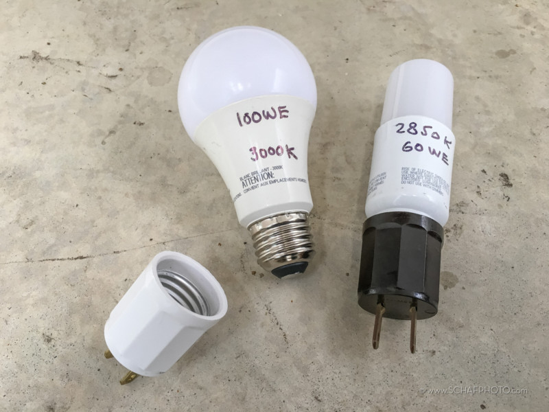

I no longer use the $8.00 Home Depot ‘cage lights’, because I stopped using CFL bulbs last year. The cages were necessary because the glass CFL bulbs would shatter in transit (and in use). I now just use simple $2.50 plug-sockets and $2.50 unbreakable LED plastic bulbs from Costco, (60 to 100-Watt equivalent, 3500 Kelvin preferred). Yes, I have about 50 single bulb LEDs in a big-wheeled duffle bag ‘o lights, five bucks each.
I am now using simple plug-in sockets and 60/100 Watt equivalent LED bulbs because the glass CFL bulbs were too fragile. © Stephen Schafer www.habsphoto.com
