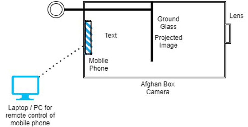

I recently shared about how I turned my Afghan Box Camera into a 4×5 slide projector. In this article, I’ll share another idea based on the Afghan Box Camera: to make use of my humble mobile phone camera to create a large format look with the box camera and its lens.
This is much inspired by other fellow photographers who have designed similar stuff such as this by Olexiy Shportun and another by Tim Hamilton. The main idea behind this is to make use of a digital camera to take a photo of the projected image made by the large format lens.
Design
In my design, I decided to make use of a mobile phone camera rather than a DSLR or mirrorless camera. However, how would I control the mobile phone camera if the phone is placed inside the box? Luckily there are various apps that will help us.
Remote Control
For my Android phone, I decided to go for the IP Webcam app for its versatile. It is free, can be used via Wi-Fi, and is easy to use. Hence by using this app, the mobile phone camera can be controlled and hence trigger off remotely.
After some testing, I realized that the phone camera cannot be too near the ground glass otherwise the phone camera will produce an image with a hot spot. The best position I found is to place the phone all the way to the back of the box camera. The ground glass image will only occupy about half of the camera phone photo frame. This can be easily overcome via zooming in via the control interface or cropping during post-processing.
Remote Control
