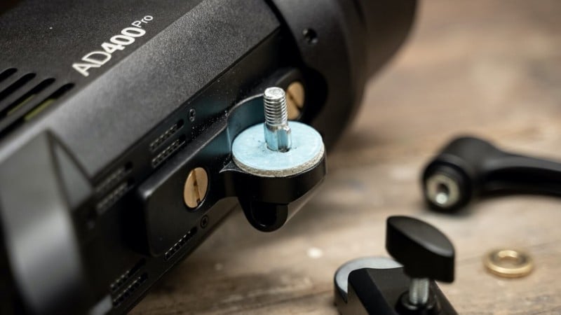

I have one gripe, just one. The light stand mount. When putting anything larger than a medium softbox on the front end of the AD400 Pro, the light bows its head and gives in under the not considerable amount of weight. If you’re a photographer that likes bright soft images, you probably have some large softboxes and octaboxes you use regularly, and may be in the same position I’ve been in where I’m constantly playing a game of tilting the head back up and putting a scary amount of pressure on the plastic tightening handle.

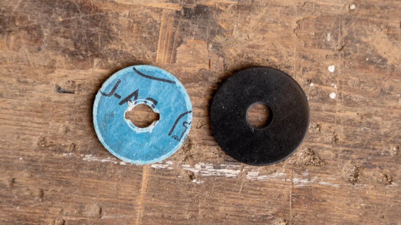

The problem is the large washer that’s meant to create the friction needed to hold the head in place. It seems to be made of a plywood-like material with a plastic coating on it. Not only is there no stickiness or obvious friction to the surface of the washer, but because its made of a dense wood-like material it has absolutely no compression to it, meaning when you tighten the handle it will reach a hard stop and tightening further might break it clean off.
When the handle stops, you can’t tighten it any more past that, and that may not be tight enough. Why on earth Godox thought this was a proper solution to this part of the design I do not know, and what’s worse, Godox doesn’t have a great track record for proven customer service, nor do they sell spare parts, to the best of my knowledge.

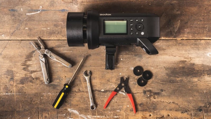

Turning to eBay I quickly found a supplier who sold rubber washers in any size you can imagine. For just £3.57 (~$4.50) you can buy a five-pack of washers that are an exact fit to replace the weird composite washer that Godox fits to the mount on the AD400 Pro.
(It’s worth noting that I have only done this fix on the Godox AD400 Pro, not the AD600 Pro, so you may need to adjust the size of the rubber washer needed if you are going to try on the AD600 Pro.)
If you’re going to order these the critical dimensions you need for the AD400 Pro are as follows:
Thickness: 3mm (1/8”)
Inner diameter: 8mm (5/16”)
Outer diameter: 32mm (1 17/64”
The supplied washer (left) next to the rubber replacement (right)

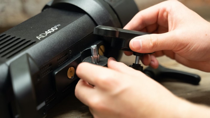

Once you have your rubber washers, the next step is to disassemble the strobe’s lighting mount. There are no tools required for this, all you have to do is rotate the plastic handle counterclockwise until it comes off, remove the brass ring beneath it and then remove the free half of the metal mount (this may take a little jiggling).

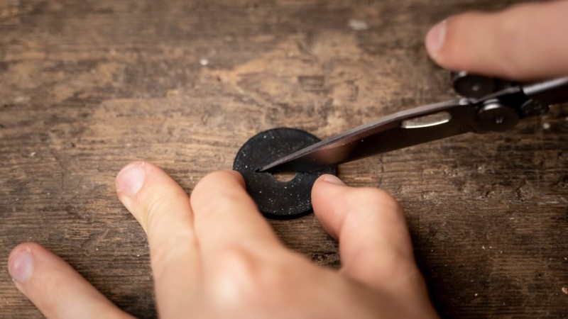

You’ll see in the photo of the original washer that it as a couple of slots either side of the inner hole. These slide over the specially designed bolt in the mount and will need to be cut out of the rubber washer.
Using a sharp knife or scalpel, carefully remove a small amount of material either side of the hole to mimic the cutouts on the original. This doesn’t need to be precise as the rubber is pretty forgiving. Once the two slots are cut simply slide it back over the bolt and reassemble the mount.

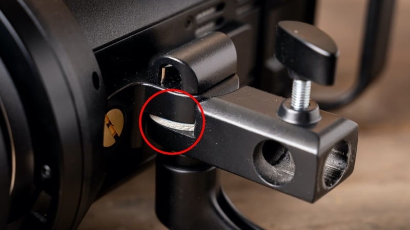

(Quick tip: the two little ‘wings’ on the side of the bolt are slightly different sizes from one another so you may need to twist the bolt 180 degrees for the free half of the mount to slide back on.)
Once reassembled you’ll have a strobe that can take the weight of your biggest modifier, and the handle will still have more room to tighten without the fear of snapping it off and ruining your photoshoot!
