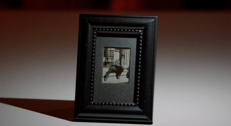

From start to finish, creating a single frame is a process that will likely take well over an hour to produce, but the result is a tiny 35mm Daguerreotype made thanks to a fun exercise in chemistry.
