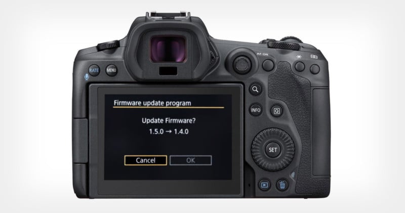

How To Revert a Canon Camera’s Firmware, Method #1
The first option involves using two SD cards.
  • Step 1: Insert one memory card with the latest firmware version into the camera and open the settings menu.
  • Step 2: Locate the “Firmware” section and click it. As the camera displays the latest firmware version it has installed, press “OK” and instantly open the memory card slot to insert the second memory card with the older firmware version. Do not close the memory card door yet.
  • Step 3: The camera will now give an option to pick either of the two versions and you can select the older one. Once you select your pick, you can close the memory card door, and press “OK” to start the installation.
  • As a note, this method didn’t work for KH Cams and stopped at 73% progress every time. That said, some who tried the method reported in the comments that it worked for them, so it appears inconsistent and may or may not work on a case-by-case basis.
    The other method uses one memory card at a time and requires quick reaction on your part.
    • Step 1: Insert a memory card with the latest camera version and locate “Firmware” in the menu.
    • Step 2: When you are ready, you have to press “OK” on the update and open the battery door at the exact same time. It won’t work unless both are done simultaneously.
    • Step 3: Insert a card with the earlier firmware version, close the card door and then the battery door.
    • Step 4: Immediately after Step 3, the camera will turn on and show the option to install the older version, which you can select to start the process.
  • For KH Cams, this method worked successfully.
